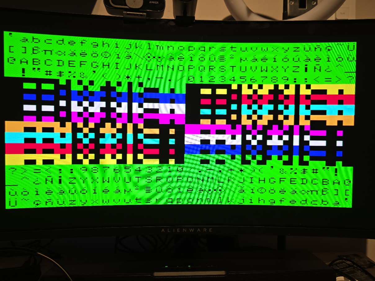

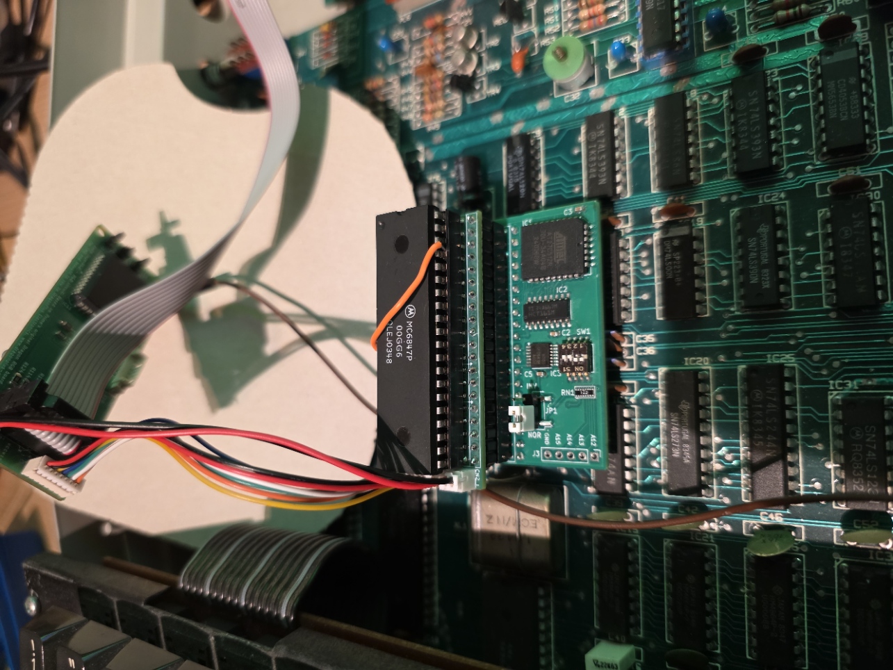

I got the new boards back from James a few days ago, and fitted the remaining components. Sadly they didn't work at first, but it was seemingly the missing /MS to /FS signal. Connecting that back on, and we are in business in this D64. The lower case board is sitting in the 6847 socket, with a SuperRGB board plugged into the lower case board.

When I redo the boards, I will likely just add another jumper to either open or close the pin 12 to 37 bridge.
Posts: 1486
Re: Dragon 200E Lower Case Daughterboard ROM question
That's a very odd result: when I measure continuity on an original Dragon 64, those two pins are definitely connected on the motherboard. So long as your carrier is connecting both through directly I can't see why your bodge wire would be needed.
But at this point I'd just be arguing against reality!
Posts: 209
Thinking about it, it doesn't really make sense, as the SuperRGB board is working alone without the link on it! I need to investigate more. Ah, mind you, SuperRGB is probably doing it's own stuff with FS.
