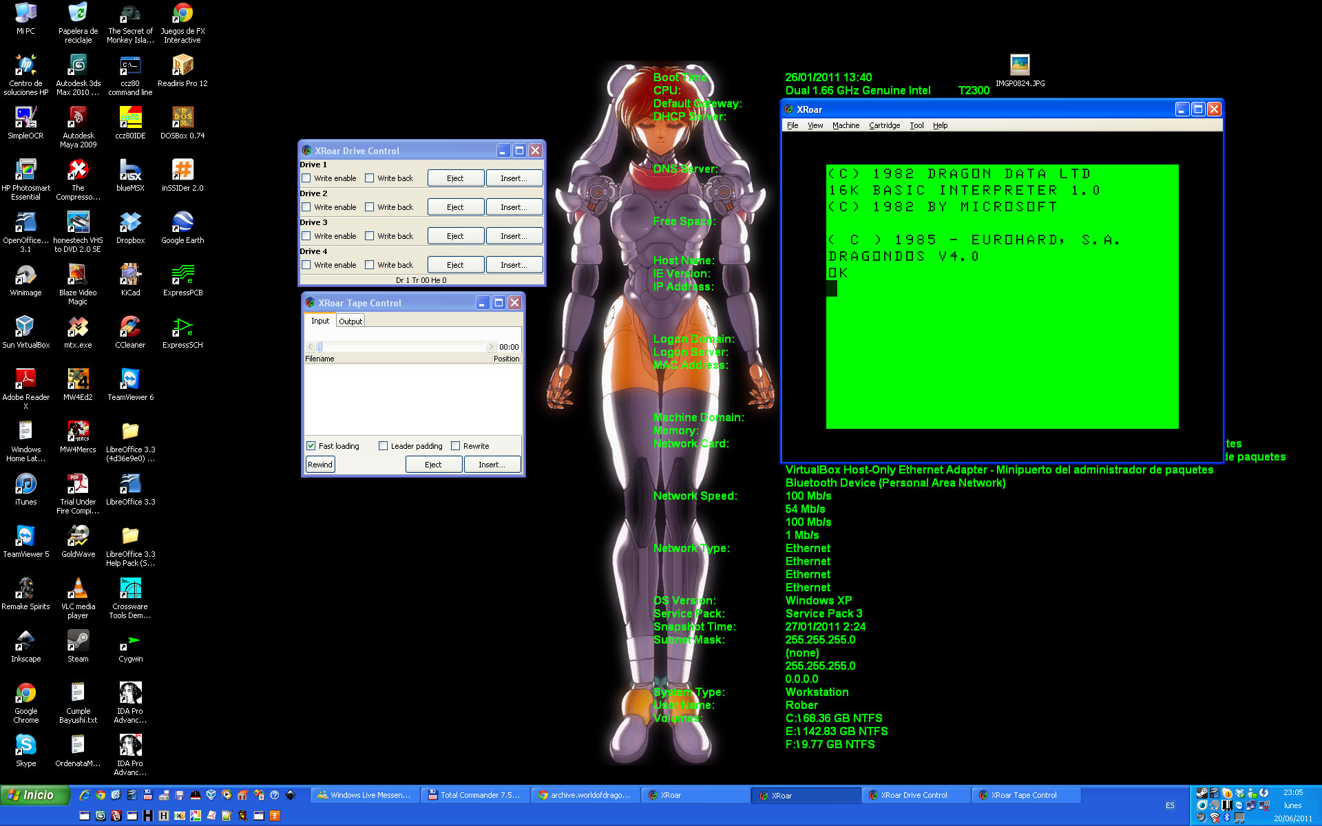

Hey!
To my surprise it worked right out of the box!
I must have installed the GTK+ libraries in my system long ago, and Xroar works like a charm. Now we are talking!
I've attached a screenshot of my system for your viewing pleasure.
Thank you very much! The menu system makes XRoar even more useful.
Keep up the good work!

- XRoar Roars in XP XD
- XRoarXp.jpg (457.12 KiB) Viewed 8506 times
