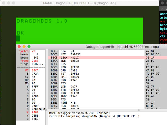

What version of MAME are you using? That machine is defined at least since 0.210.
Re: MAME Emulation
right now I am using MAME215
thanks
thanks
Re: MAME Emulation
Do you get any error message?
I just type "./mame64 dragon64h -window -debug -resolution 640x480" and it works as expected.
Try copying your dragon64.zip in the roms folder as dragon64h.zip in the same folder.
Re: MAME Emulation
Hey Robert,
got it working!!
I just had to create a copy of the dragon64.zip file and rename it to dragon64h.zip
Now I can look at the code with lots of 6309 opcodes well disassembled
Thanks a lot!
got it working!!
Thanks a lot!
