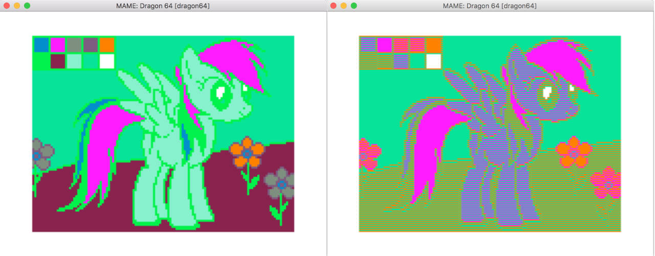

I posted a report on MameTesters about the NTSC artifacting on PAL Dragon machines, and got curious about it so I think I'm near having the PAL artifacting working.
:mrgreen:

robcfg wrote: Wed May 01, 2019 9:29 pm I posted a report on MameTesters about the NTSC artifacting on PAL Dragon machines, and got curious about it so I think I'm near having the PAL artifacting working.
From those screenshots I have no idea which is which, which is why I didn't want to get involved with the 6847. When you're done make a Pull Request and hopefully someone more familiar with it will get it merged.
Posts: 1706
Re: MAME Emulation
The left one is with pal artifacting and the one on the right is without any artifacting.
As soon as I finish it, I’ll make that pull request.

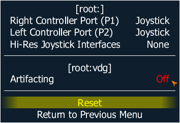

on the subject of Artifacting... :mrgreen:
can you tell me if that status can be changed from the command-line in MAME.
VDG - OFF (0), Standard (1), Reversed (2).
i guess it will be something like this, if it exists...
-:vdg:artifacting 0
editing the cfg works.
<port tag=":vdg:artifacting" type="CONFIG" mask="3" defvalue="1" value="0" />

.mad. wrote: Fri May 03, 2019 12:04 pm can you tell me if that status can be changed from the command-line in MAME.
No, Configuration options cannot be selected from command-line.

Pernod70 wrote: Fri May 03, 2019 12:09 pm No, Configuration options cannot be selected from command-line.
can i please request it?. ;)
i would also like option to disconnect LEFT or RIGHT Joystick from the command line.
i have seen strange / disabled fire buttons, when both joysticks are enabled in a couple of games.
e.g. SHAFT
this ends up mapping RIGHT fire button on KEY 7.
