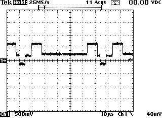

Here are some captures of the video output at the monitor port:
Firstly normal.png is one-and-a-bit lines from a normal black pmode 4 screen. The hsync pulses are the lowest levels and the white borders are the highest levels. One hsync to the next is 64us as expected.

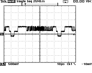

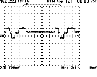

The next set of captures is from a screen with the overscan routine running. There's a bit of distortion at the top where the border curves for a few lines before settling down for the rest of the screen. It is stable though, meaning the same thing is happening each frame.
overscan1.png is from a line with overscan. The left border is larger and the right border is smaller. The line is still 64us long. Most of the 192 lines look like this.
overscan2.png was captured near the top of the screen where there was a bit of data from the text screen. This line is 65us long.

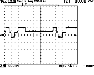

overscan3.png is a black line, also longer than normal. I'm guessing this must have been from near the top of the screen as that is where the distortion is. I had to press the capture button a lot of times before this one appeared, so there can't be many lines like it. The second hsync looks long as well.

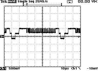

overscan4.png is near the top of the screen (text screen data visible) but with normal timing. Not many of these on screen either.
It looks like it's the change from 64us to 65us lines that is messing things up, but the vdg somehow gets back to a 64us line, even with the overscan. Figure that one out
