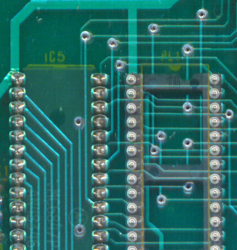

On the original lowercase PCB, pin 37 of the header (FS) is not connected to anything. You can see this here:
Screenshot 2024-11-20 224806.png (779.42 KiB) Viewed 66122 times
This is the original PCB photos superimposed, the bottom reversed, and the top is set to 50% opacity.
Pin 37 on the header is the 4th from the right top. Notice no trace either side...
Notice that pin 12 (MS) has a trace heading to the left, and then a via right to the left of the 6847's right set of pins. THat via has a trace on the bottom that goes up to where pin 37 is, and then vias again.
Thus, I theorize that the header *MS and *FS pins are tied together and the signal is then tied to the header *MS pin. Since the '161 needs to get the *FS from somewhere (it's the signal going above the IC5 in the pic, to the left of the one with the via that is connected to pin 31 (INT/EXT). Since it lines up with the upper via sitting to the left of *FS, I think IC 12 and 37 and the '161 are tied together with that trace, and the trace then heads over to the header pin 12.
I updated my v1 schematic to tie FS of the IC to FS and the 161, and MS header to MS IC, no bridging.

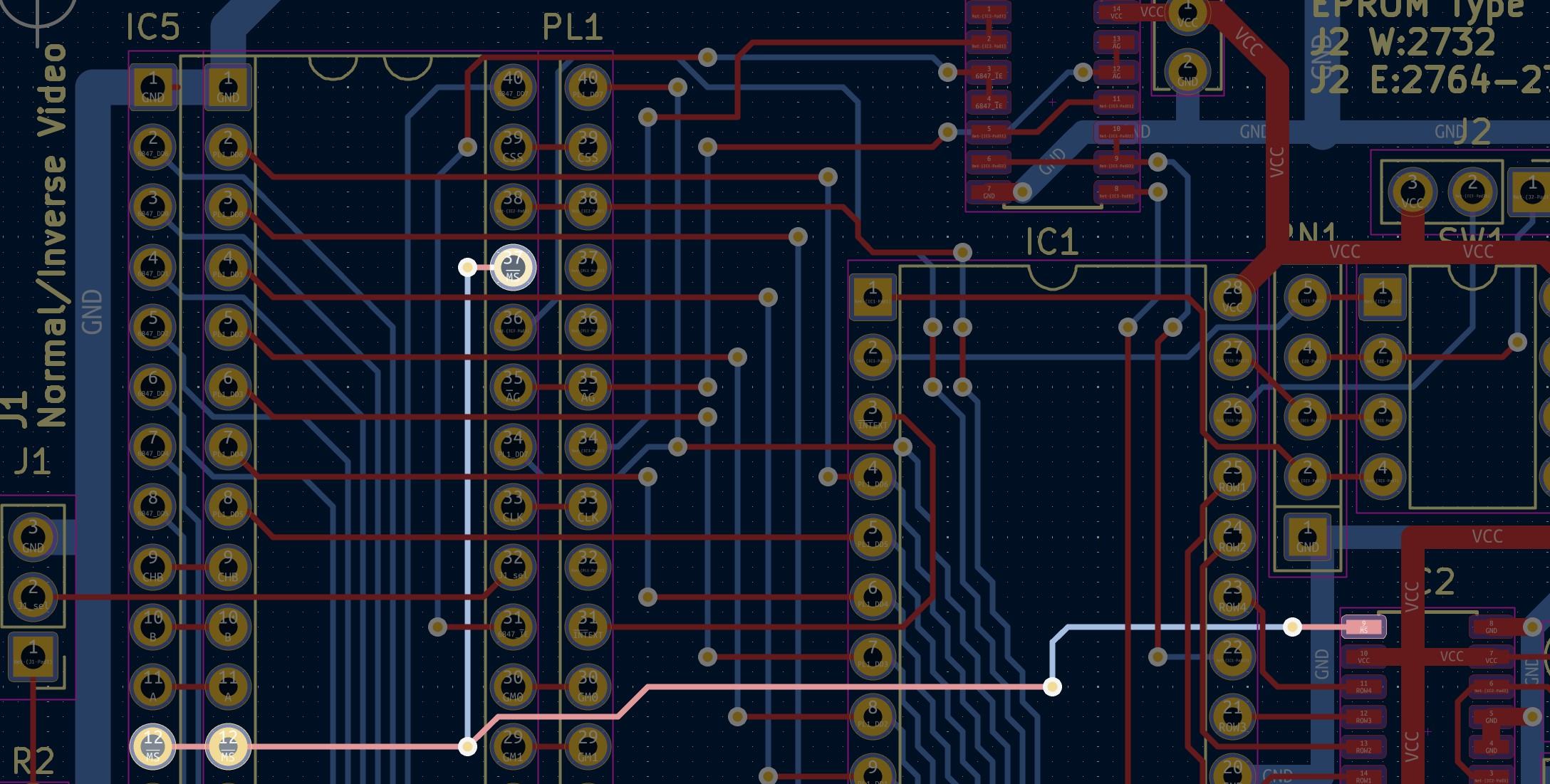

This is exactly what is on my board...I think.
I have the below connections
Pin 12 Socket = Pin 12 6847 = Pin 37 6847 = Pin 9 LS161
Pin 37 Socket = N/C
So yes, it is reliant on the motherboard having ~FS and ~MS connected.
I don't see the issue here. If we're saying change the circuit just because we can because we're using CMOS, I'd need a better reason than that.
You may, however, have given me a clue as to why the Atom modded version I made performed so poorly! :)

Posts: 192
Re: Dragon 200E Lower Case Daughterboard ROM question
sixxie wrote: Wed Nov 27, 2024 10:05 pm
Your pic makes it look like you connect the two together yourself as well as them being connected on the motherboard!
Yes - as it was originally a replica of what the 200E card was, and isn't ~FS and ~MS also tied on there? It is on the traces I got from (I think) Rob originally?
Kinda interested in the why of that :)
Just something Phill said a long time ago about the different way that ~FS or ~MS is assigned on the Atom, and that if I have taken across a Dragonism, that could well be the issue. It basically screws up the keyboard entry, making it somewhat 'hair trigger' from memory.
Posts: 192
Quick resurrection on this topic - suggestion is to just connect pin 37 of 6847 (FS) to pin 9 of the HCT161? Obviously still connect MS on motherboard to MS on 6847 - but do NOT connect MS to FS on the daughterboard?
Posts: 1431
Yeah I think that's the layout that would work with my motherboard configured to allow more CMOS use - and of course would stay compatible with original boards anyway.
