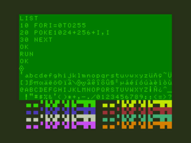

Posts: 197
Re: MAME - Dragon 200-E
Boards arrived today. Have put one together and blown an EPROM as per the image I found either here or Simon's main site (Rom26.ic1). The results are rather different to what a real 200E displays - I presume because I have a normal D64 BASIC ROM in place.
More characters available by poking direct to the screen! :)

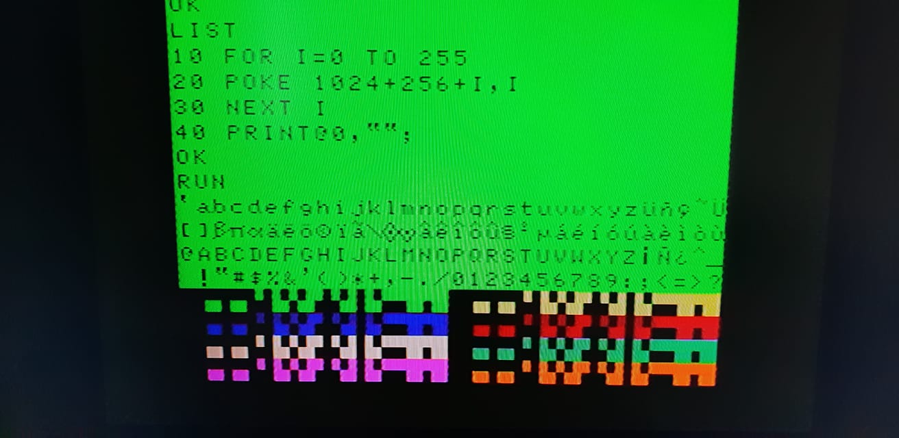

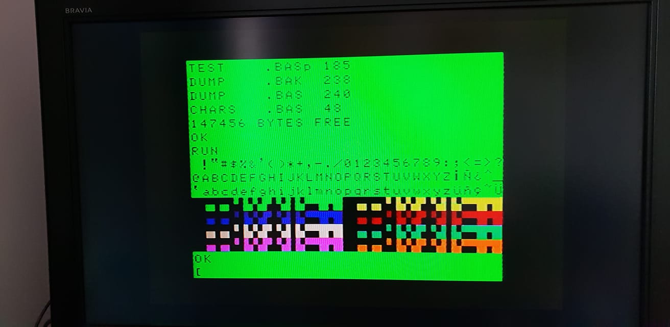

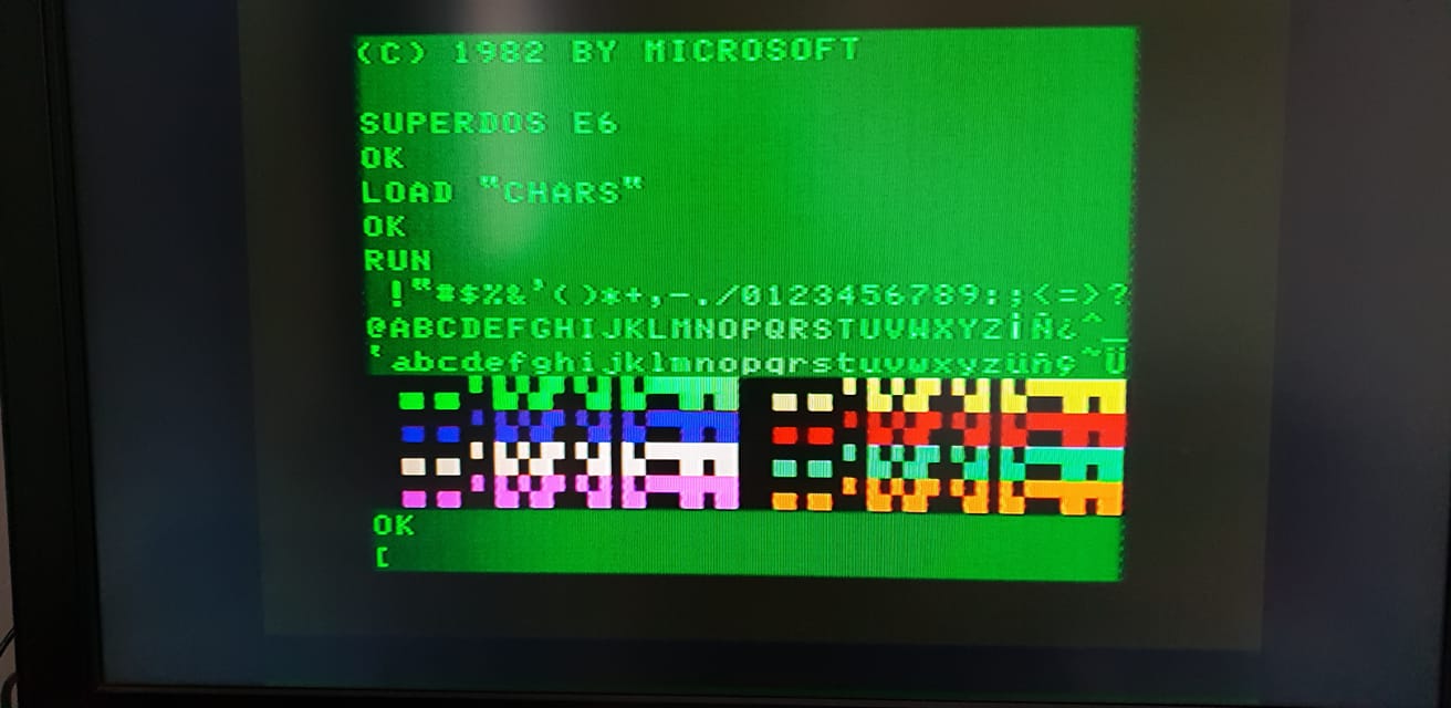

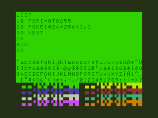

Pernod70
Posts: 123
Location: Croydon, UK
Post by Pernod70 »
Finally, I think I'm done with the external character ROM board:
Normal
Normal
Inverse
Inverse
On the original board I see LK1 controls the INV input. Is INV not software selectable like on other models?
Posts: 1676
I remember that there's an address you can write to, to enable/disable the external character rom, but if you cannot invert the characters as these have been replaced with the lowercase one, thus the switch.
