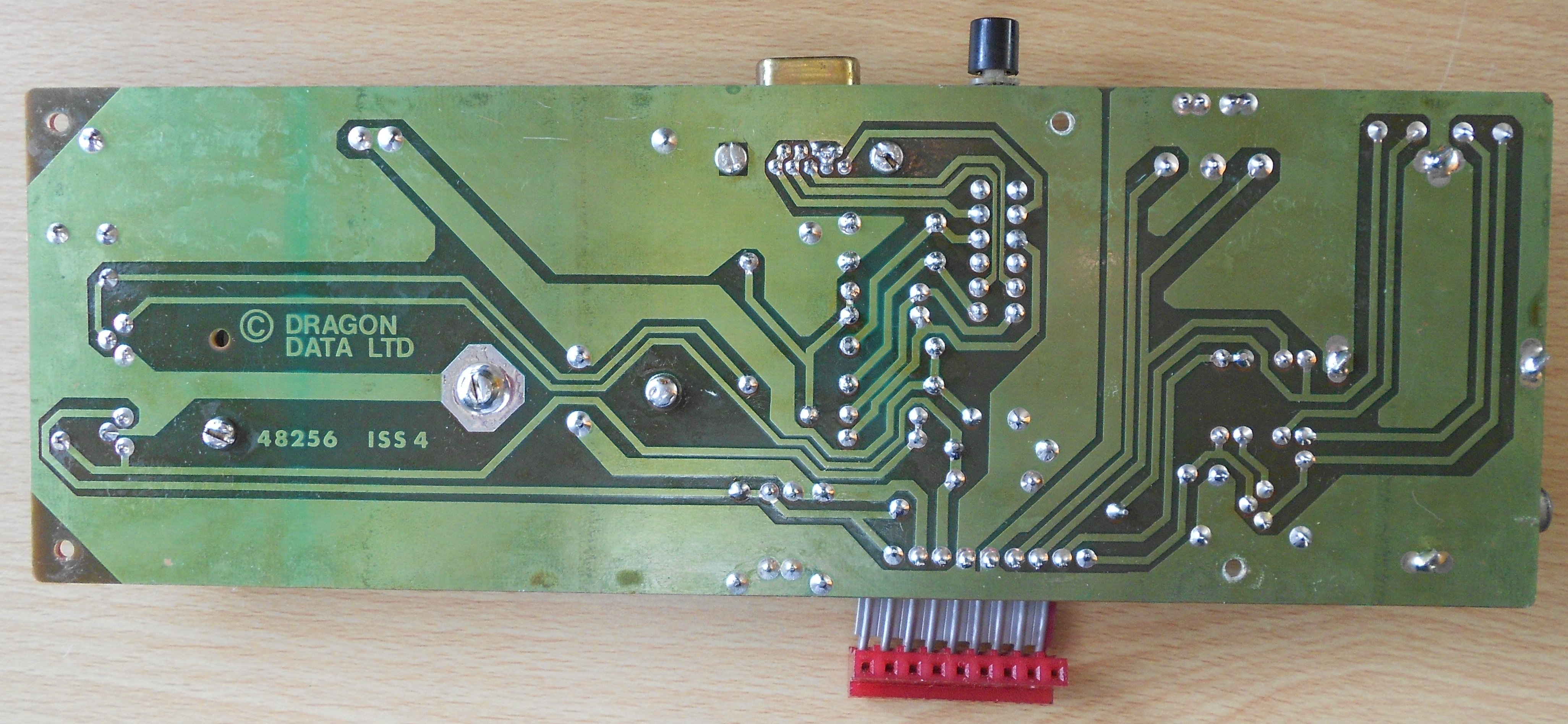

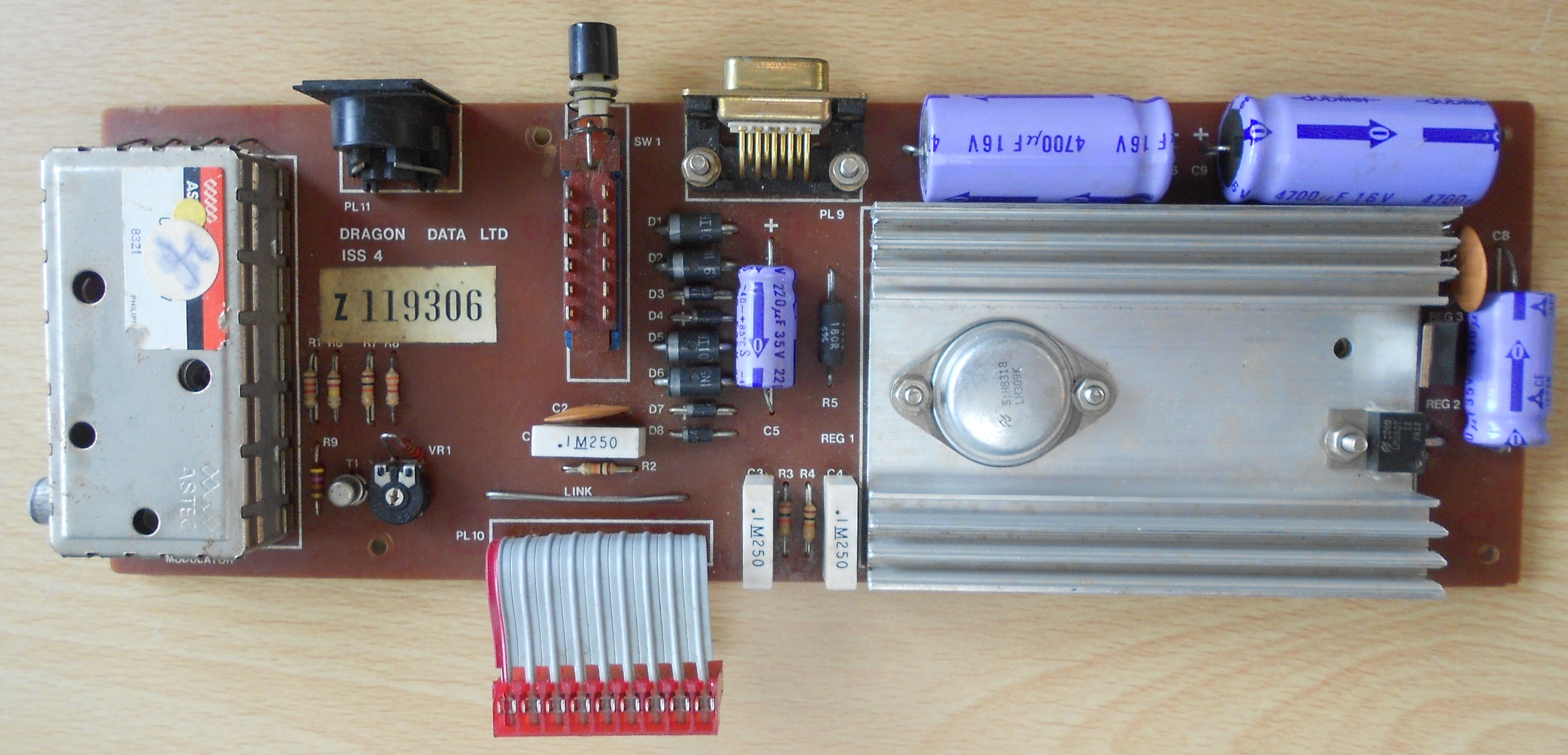

I found an ISS4 PSU board in a D32. I thought these were only found in D64s? It had a 7905 reg fitted instead of the 7912 required for the D64. I don't know if it was made like this or someone (not me!) converted it for use in a D32.

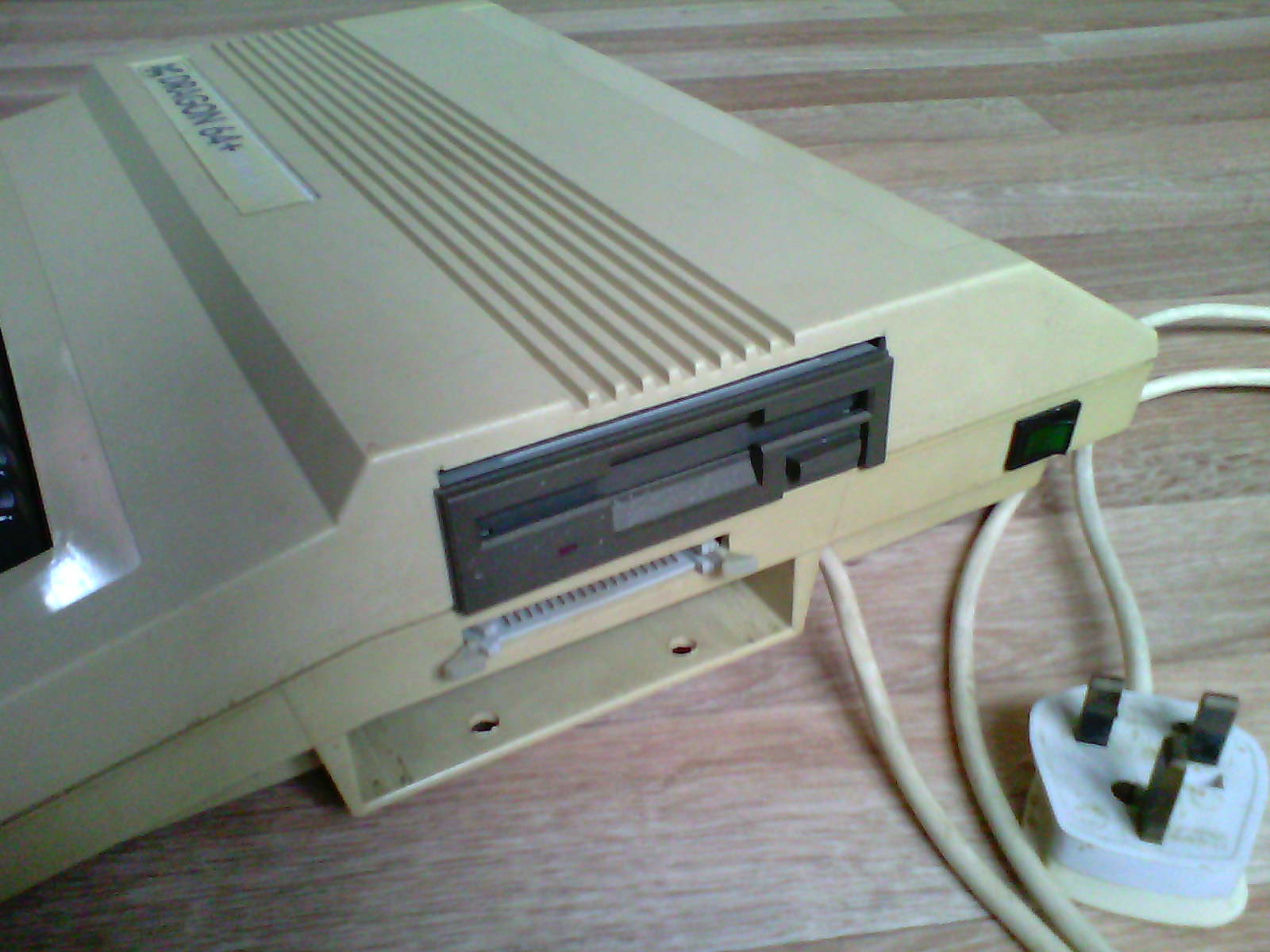

Oh, and I found this abomination :-)
It's a D32 upgraded to 64K, internal disk drive, serial port, switch mode PSU, TTL monitor output and built in speaker.
Sadly I no longer have a working TTL monitor. I'll have to convert the output to analogue one day.

If you take a look here, the Issue 4 power boards seem to have been 'fixed' to work with a D64, so it's perfectly normal. As we don't have pictures of an unmodified Issue 4 board, could you please take some pictures, or 300dpi scans for the wiki?

robcfg wrote:If you take a look here, the Issue 4 power boards seem to have been 'fixed' to work with a D64, so it's perfectly normal. As we don't have pictures of an unmodified Issue 4 board, could you please take some pictures, or 300dpi scans for the wiki?
No problem Rob. I've got some chores today so might not be this weekend. I'll also take a closer look at the ISS4 in my D64 to see if it matches the one in the wiki.

robcfg wrote:As we don't have pictures of an unmodified Issue 4 board, could you please take some pictures, or 300dpi scans for the wiki?
Photos of ISS4 PSU board in a D32:
I also checked the ISS4 board in my D64 and it has the same mod as the one in the wiki, other than the wire being black instead of green.
Edit:
I had a look at the mod to see what it does:
One of the connections to the RF circuit is to regulated +12V. The mod disconnects from 12V and connects to the unregulated feed to the 5V reg which I measured to be about 9.4V under load. I don't know what the effect of this mod is.

Thank you very much, Stew!
I edited your pictures a bit and uploaded them to the PSU Pictures page.
