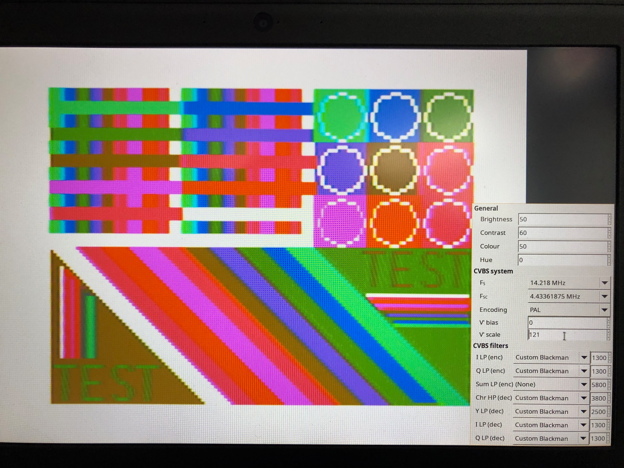

Yeah clearly moving in the right direction, but some of the colours are swapped. Need to think about how that could be...
Posts: 1678
Re: XRoar video debug builds
That's why I suggest you try Tetris at the same time, as it happened to me when I implemented it in MAME that when I made the colours match in PMODE3, some were inverted in Semigraphics mode, as if they have the phases inverted between modes.

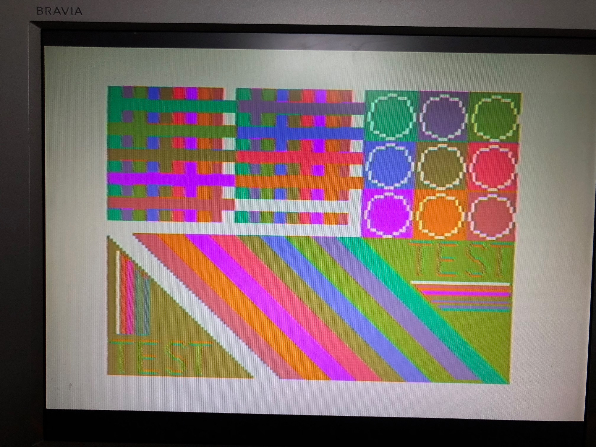

I'm getting happier with the PAL behaviour.
I'm still not quite sure how in Pere's testcard, one of the blues edges purple and one of the greens goes brown. You can get the effect by nudging the "hue" up to 4 or 5, but not sure why that would be required. Unless maybe the network of components around the LM1889 isn't so perfect.
See what you think - I've tried to set some approximately nice default filters and brightness/contrast levels.
Edit: actually, these settings seem to be almost perfect in PAL:
brightness 50
contrast 65
colour 25
hue 10
