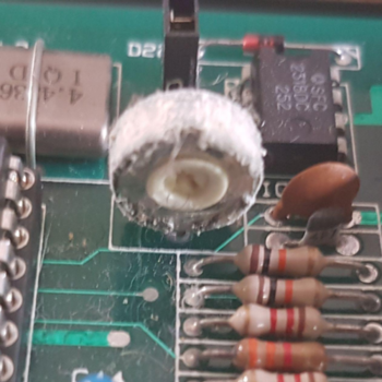

And beside the above VR1 potentiometer had heavy oxidation so better replace that one as well but haven't found it in the schematic yet as the quality isn't the best:

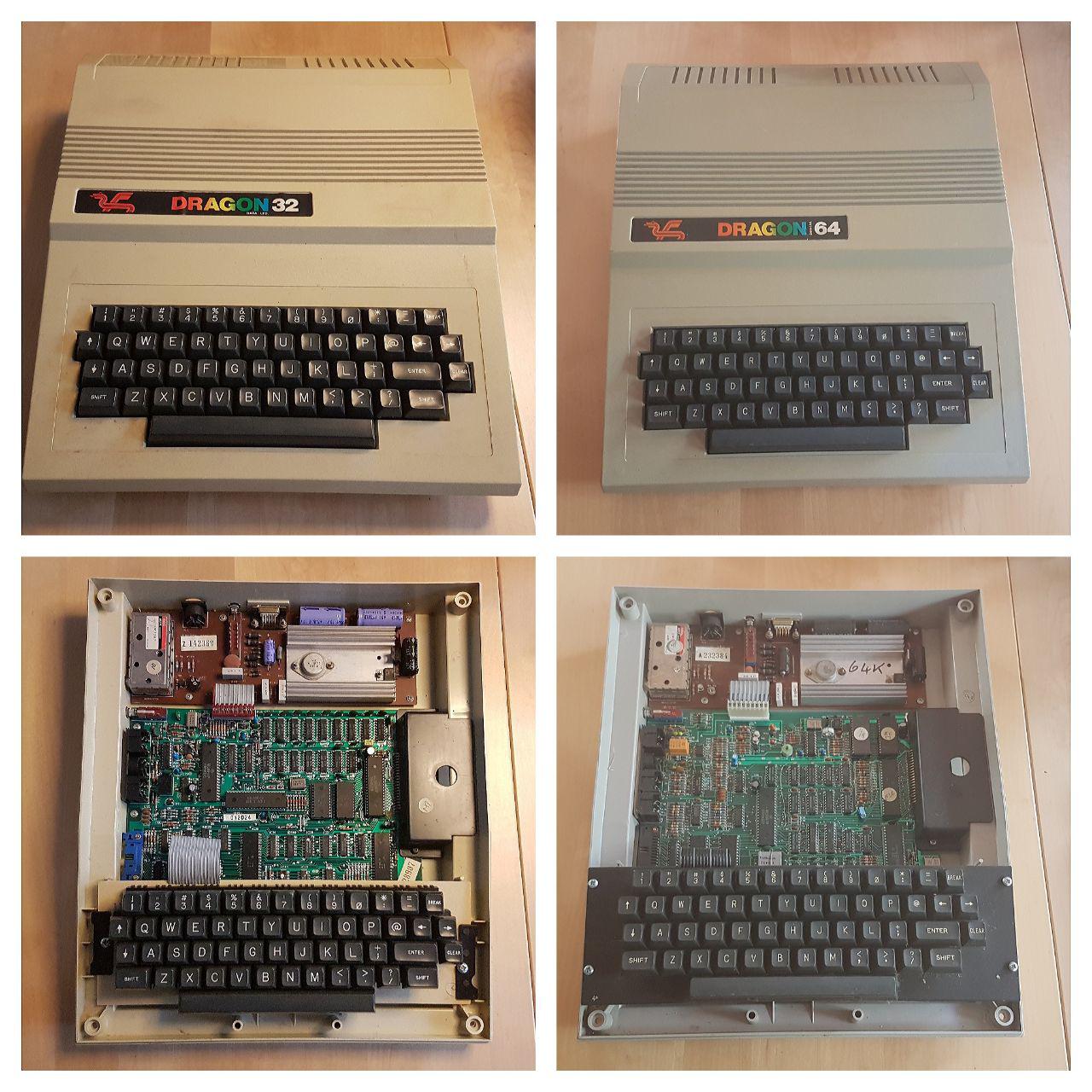

Right then, this is what I'm working with then, one D32 and one D64:

As for VR1, just try cleaning it in the manner described by Stew in another thread.
