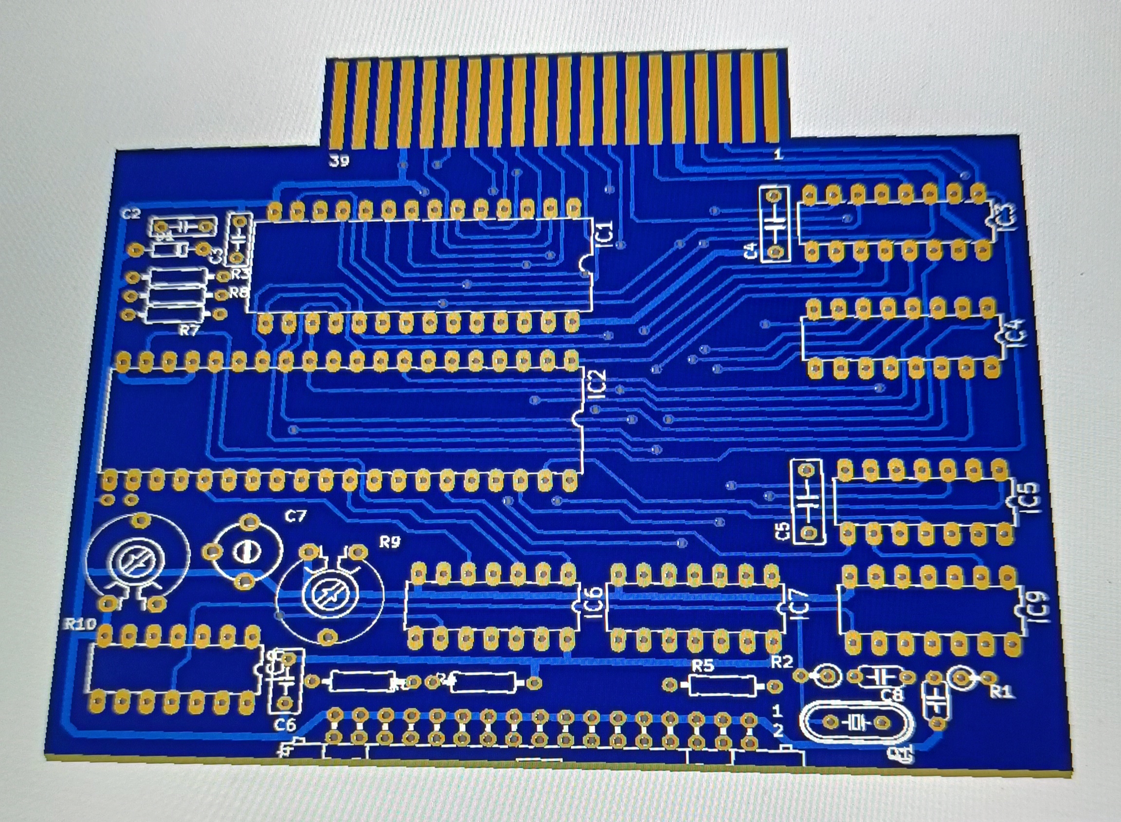

Edit: OK, I found this Website which seems to contain all that I need to build a Floppy Controller. So I can use a Gotek Drive with my Dragon. :D https://hardware.speccy.org/temp/Dragon-1.html
@bluearcus I found the Project from Kernelcrash allready, but again, no CAD or Gerber-Files... But this one has so simple wiring that i think i could create a PCB with KiCAD in my own.
Edit: OK, I had to convert the Eagle files to the new Format, but this looks good. :D I think i'll make one of these...

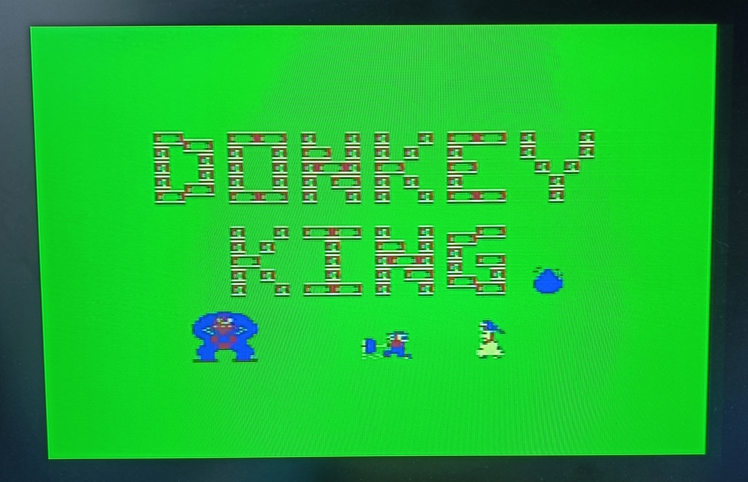

OK, I have assembled the Floppy Interface...
Adjusted the Signals...
And it runs very well with my Gotek Drive !
