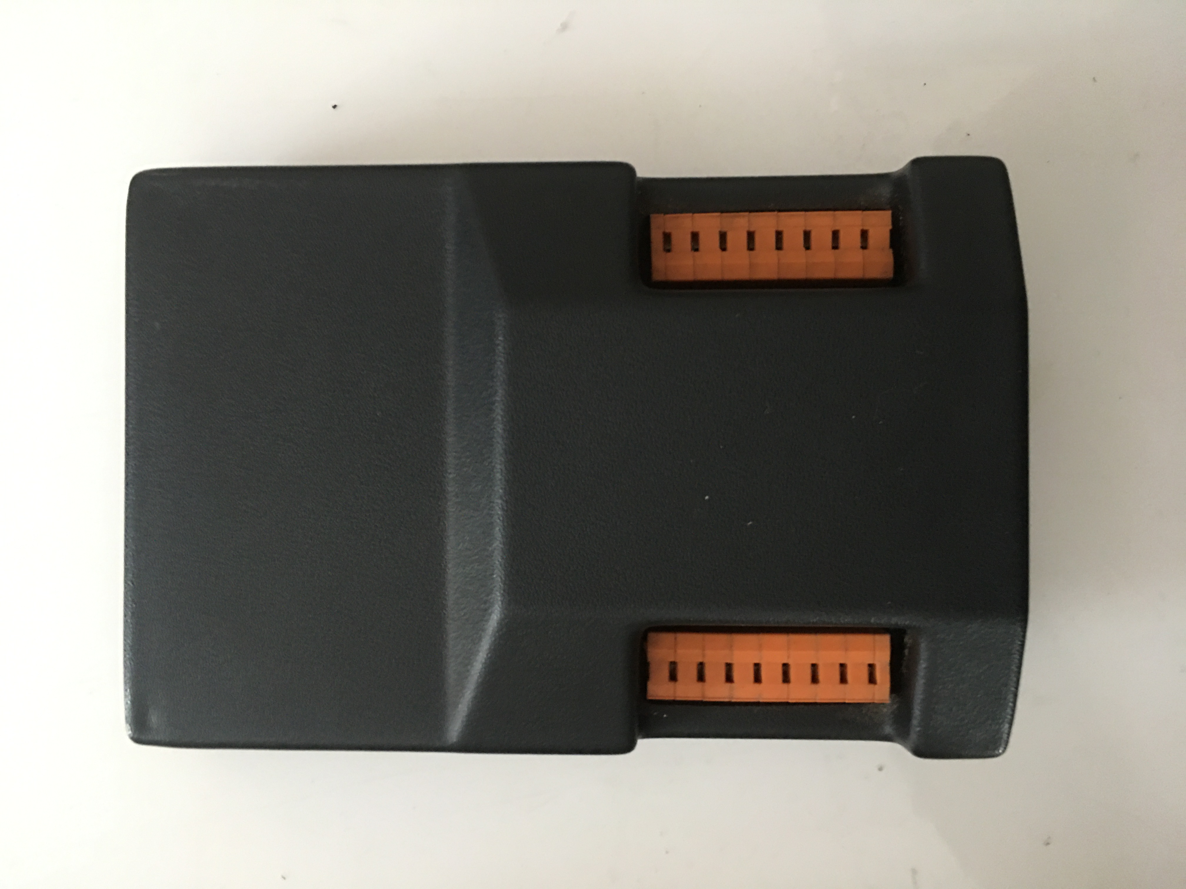

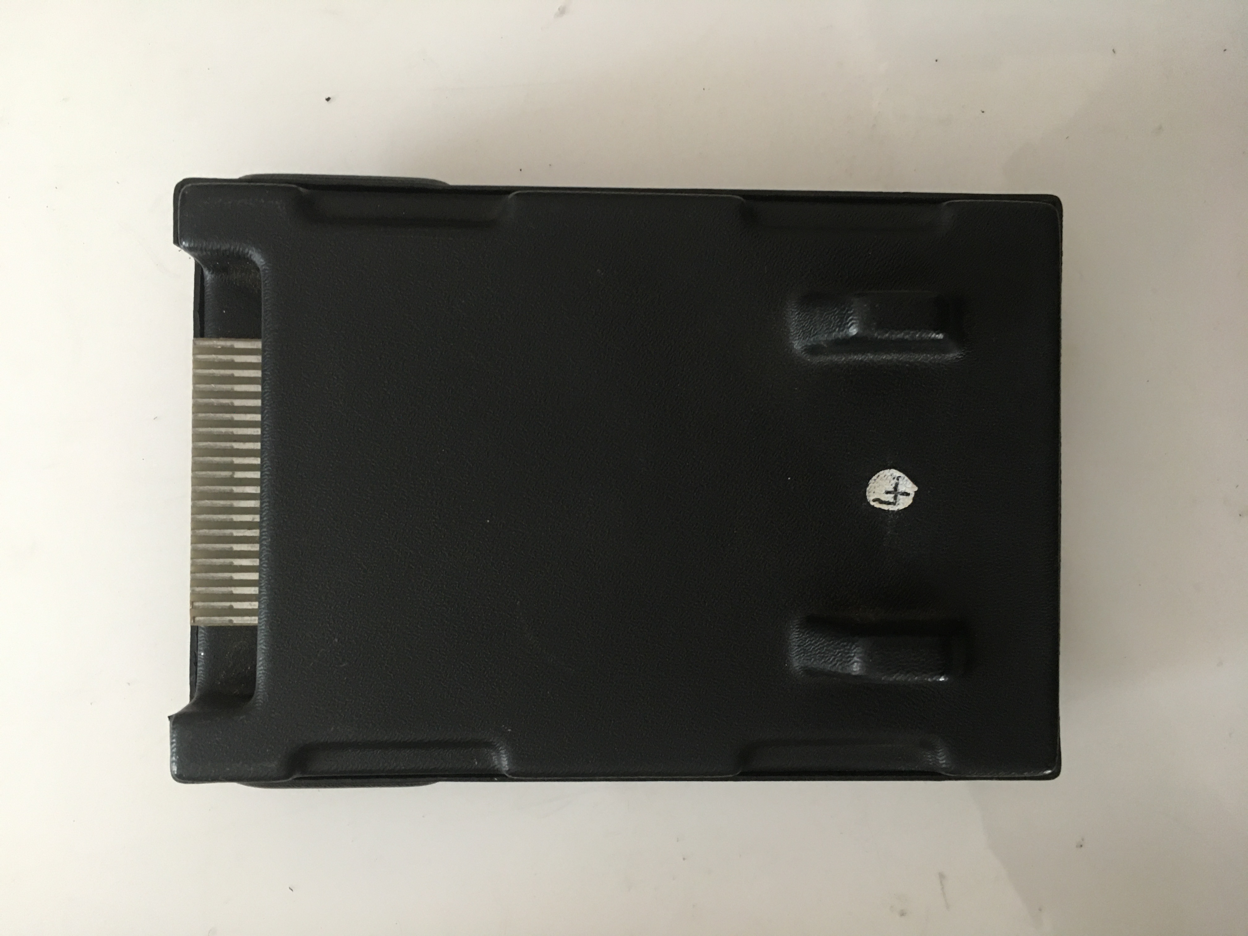

Hi All
I have been sorting through my retro computer boxes and found a cartridge that doesn't have any markings or labels on, I suspected it was for a Dragon Computer so I plugged it in to one of my dragon 32's
It powered up and displays MXT I/O CONTROLLER
Does anyone have any knowledge of the cartridge or user manuals etc
Appreciate any help you can give.

Would you mind uploading some pictures?
I’d appreciate pictures of the cartridge from both sides and the circuit board inside it (both sides too).
That way we can try to guess its function.

Photos added but I cannot open the case, it seems to be glued together and I am scared of damaging the case by forcing it.

Thanks for the pictures!
I'm wondering if you can record the sound output of your Dragon on a PC. If that's the case, we could dump the rom without having to open the cartridge. I'll take care of extracting the rom data from your wav recording.
