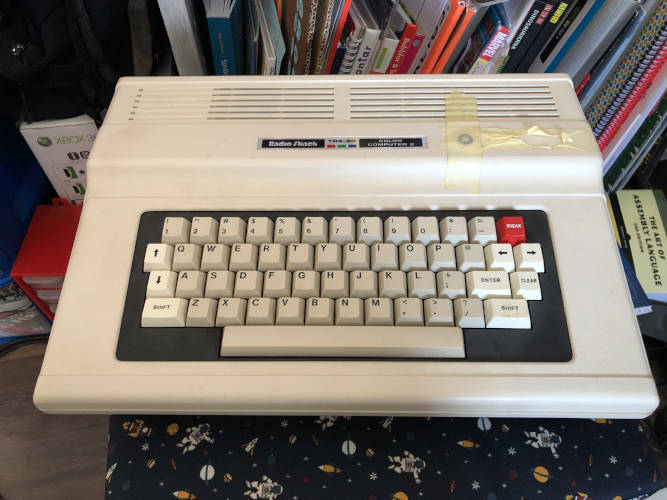

I'm trying to diagnose a 16Kb Korean made CoCo2 I got from a friend long ago, and as him before me, I'm quite stuck :lol:

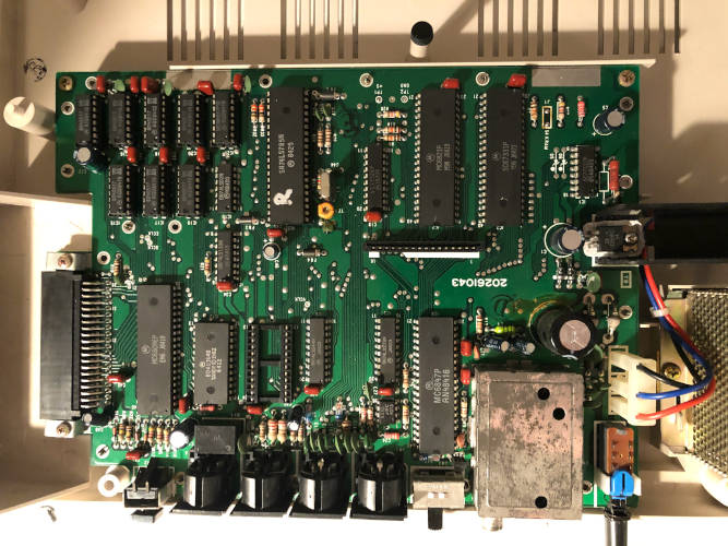

So, here's the patient:

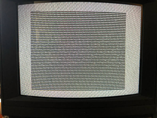

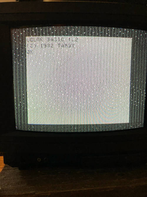

And here's the symptom:
The screen is grey because it's a NTSC machine on a PAL tv.
What do I know?
1) The machine boots up, and is able to load software. I type CLOAD, hear the relay clicking and when the program is finished loading, I hear the relay click again.
2) The SAM is working. I put it in a Dragon 32 and it works as expected.
3) The signals I poked with an oscilloscope looked nominal according to the service manual: https://colorcomputerarchive.com/repo/D ... Tandy).pdf

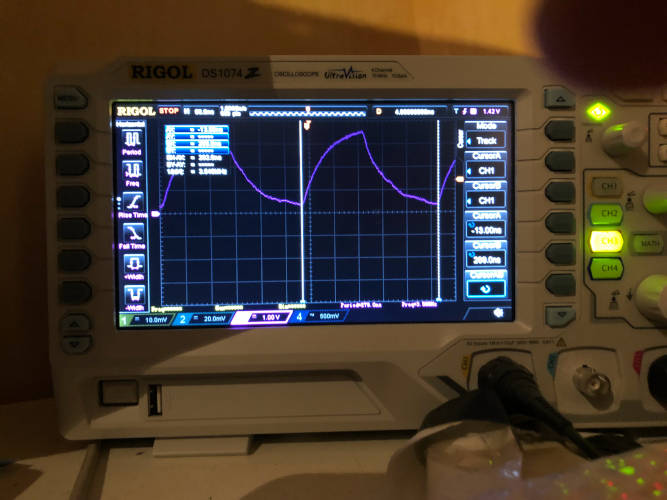

My only doubt is the clock signal from the MC1372 on the modulator, which looks like this:

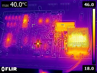

4) No chips seem to be hotter than usual.
5) I tried to run a small basic program to switch to graphics mode and measure the |A/G pin, to determine if it's the PIA's fault or the 6847's, but it turns out that the 'R' key could be not working so I'm not able to run the program.
Has anyone encountered a similar fault, or knows hot to diagnose it?
My bet is on the 6847, because all |A/G, |A/S, GM0, GM1 and GM2 signals are low according to the multimeter, which is correct for the text mode screen, but as you can see on the tv picture, there is no border, which would indicate that the VDG is in graphics mode.

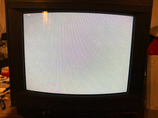

Thing is, my TV set detects the signal, and I can clearly see when the computer is on or off because the screen is completely black or as I showed above.

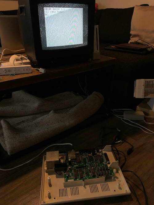

Well, results are in!

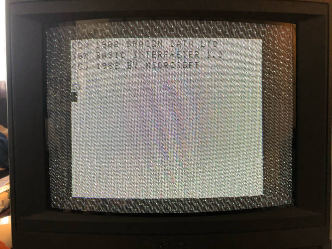

The video via RF works enough to get a picture, so that's good news!
On the other hand, knowing that this works, and that signals from the PIA are correct as far as I know, the MC6847 must be damaged, so I guess it's time to get the desoldering braid and a spare socket.
While I was at it, I did a PMODE 4,1:SCREEN 1,1 and was presented with a pattern different than the usual one:
Have you seen a pattern like this one on other Dragon machines?

Here's the memory assortment on my CoCo2:
I see a chip different from the rest, but don't know if it's different enough :mrgreen:
