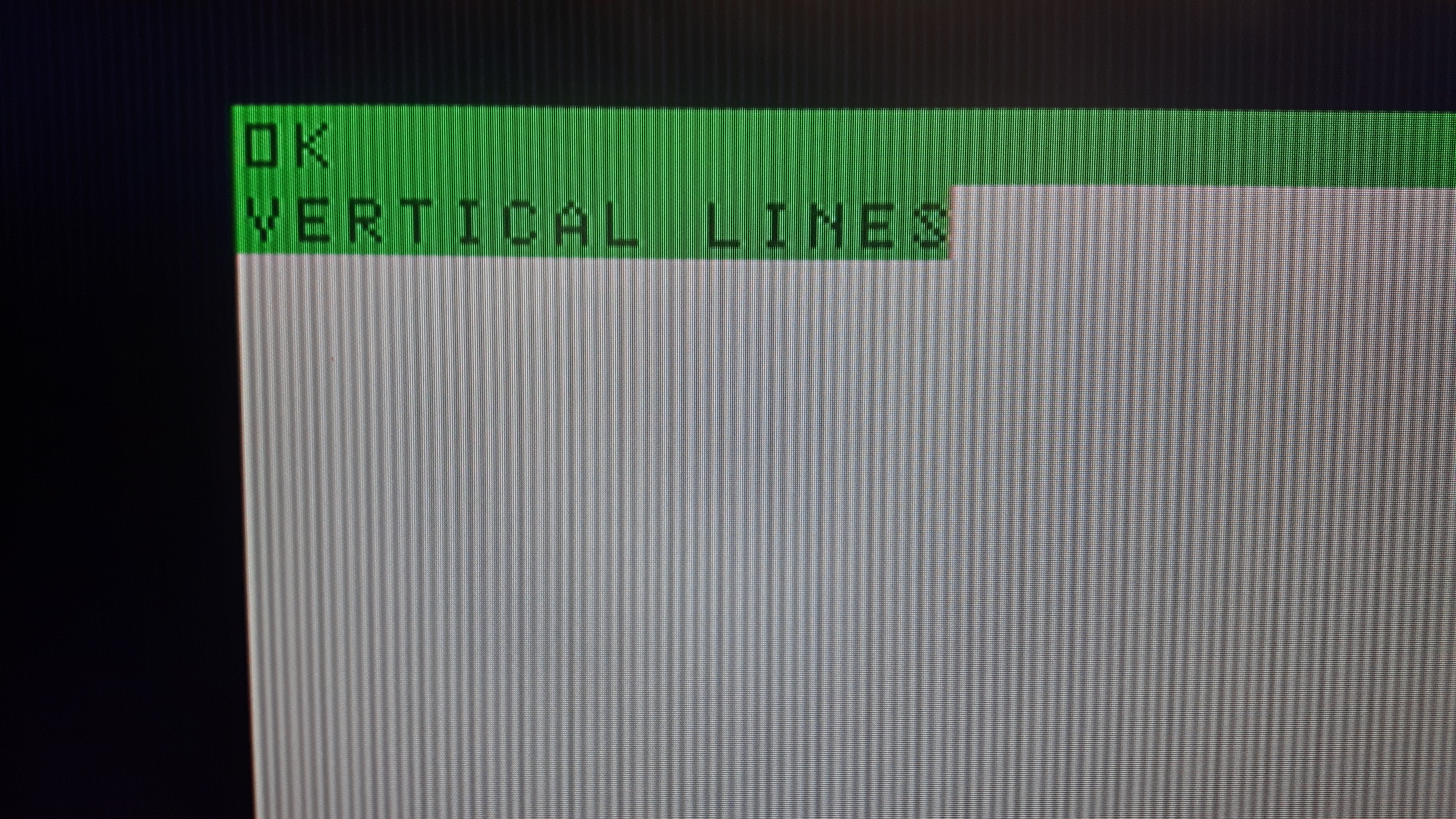

About the vertical lines "jail bars"
Both of my machines present vertical bars. I can mitigate the phenomenom with the settings of the screen or VLC Reader. But if anyone as ideas about the cause ... I have not tested the machines with other external PSU.
I think it is possible to get rid of them because I also have got a coco 2B RGB which is, by me, the ultimate reference of video quality.

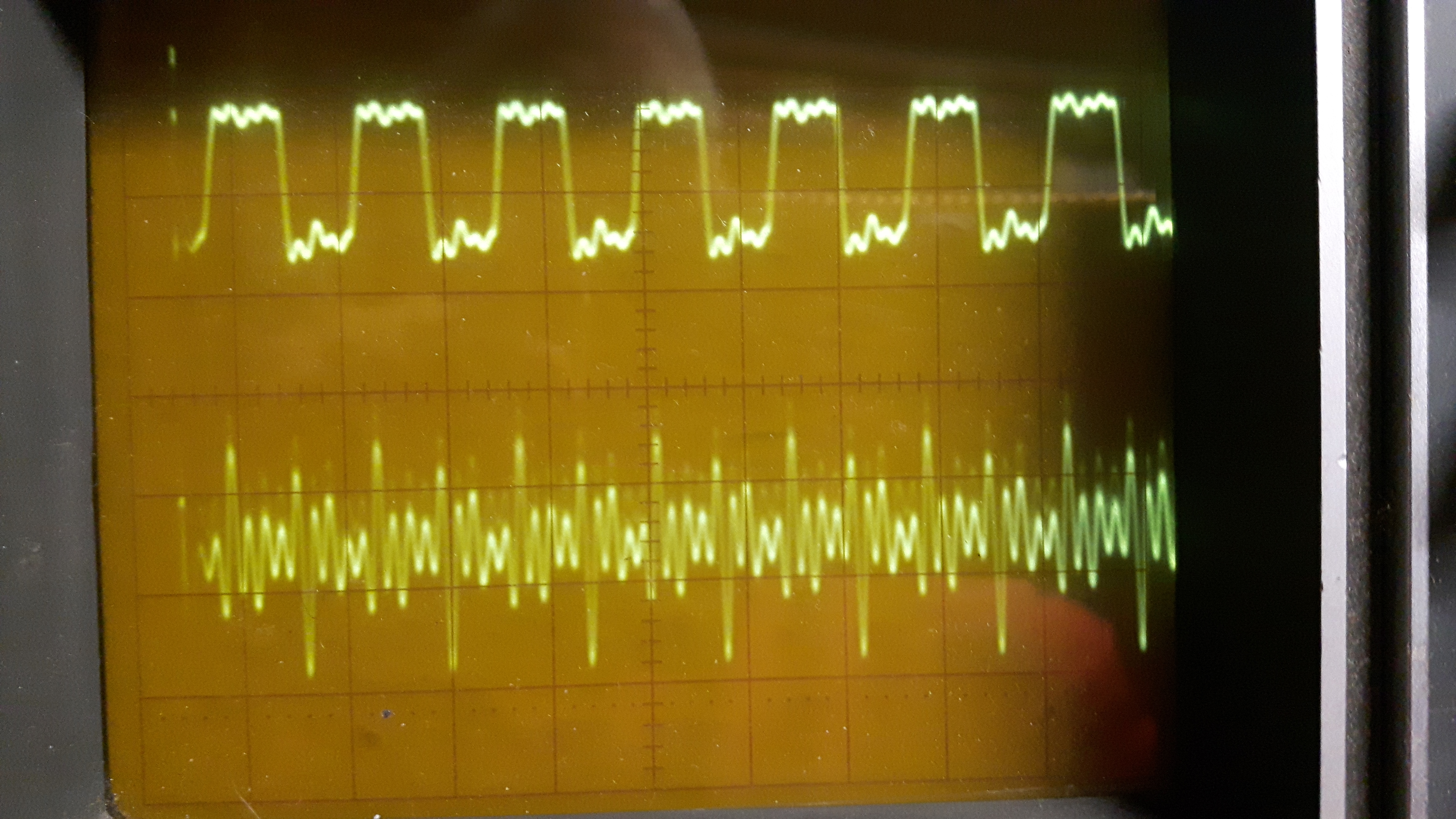

I have taken a picture of the screen with the bars.
And also a view of the Y signal given by IC 6847 compared with the Video Clock (oscillo at 0,2 µS per division)
When I read the 6847 data sheet, in the case of a 14,2180 MHz quartz, the timings are :
- VClock (upper signal) is at 3,55 MHz, the cycle is 0,28 µS
- one line of 256 dots on the screen is 36 µS (64 µS for a total line)
- one dot is 0,14 µS = half a VClock cycle
We see on the picture and on Y (lower signal) an alternation of black and white bars at each dot
and if we zoom the picture, another alternation of black and white bars (3 or 4 per dot).
That does not explain the cause !

vertical lines on a Dragon 32
vertical lines on dragon 32.jpg (7.03 MiB) Viewed 33105 times
Video clock and Y signal at 0,2 µS per division
video_clk and y.jpg (3.76 MiB) Viewed 33105 times
Re: Dragon 32 RGB SECAM and video tests
Posted: Sat Apr 10, 2021 8:28 pm
by sorchard
Hmmm, those bars are at a higher frequency than what I had in mind, so probably not dram noise. As your photos show, that looks like the video clock coupling into the luma signal.
If the noise is on the supply rails, then some bypass caps might help.
I notice in the picture of your motherboard that the 6847 has no suitable bypass caps at all. It might be worth connecting 100nF directly between the supply pins (1 & 17) to see if that helps.
The video clock is routed to several ICs: IC14, IC22, IC23, IC29. These can all put noise on the supply rails.
If that doesn't help, then it may be more of a crosstalk issue resulting from the board layout. It would be interesting to find out if anyone else with that board type has the same pattern of noise in the display.
I can see the same pattern faintly on my MKII Dragon, but nowhere near as noticeable as in your photo.
