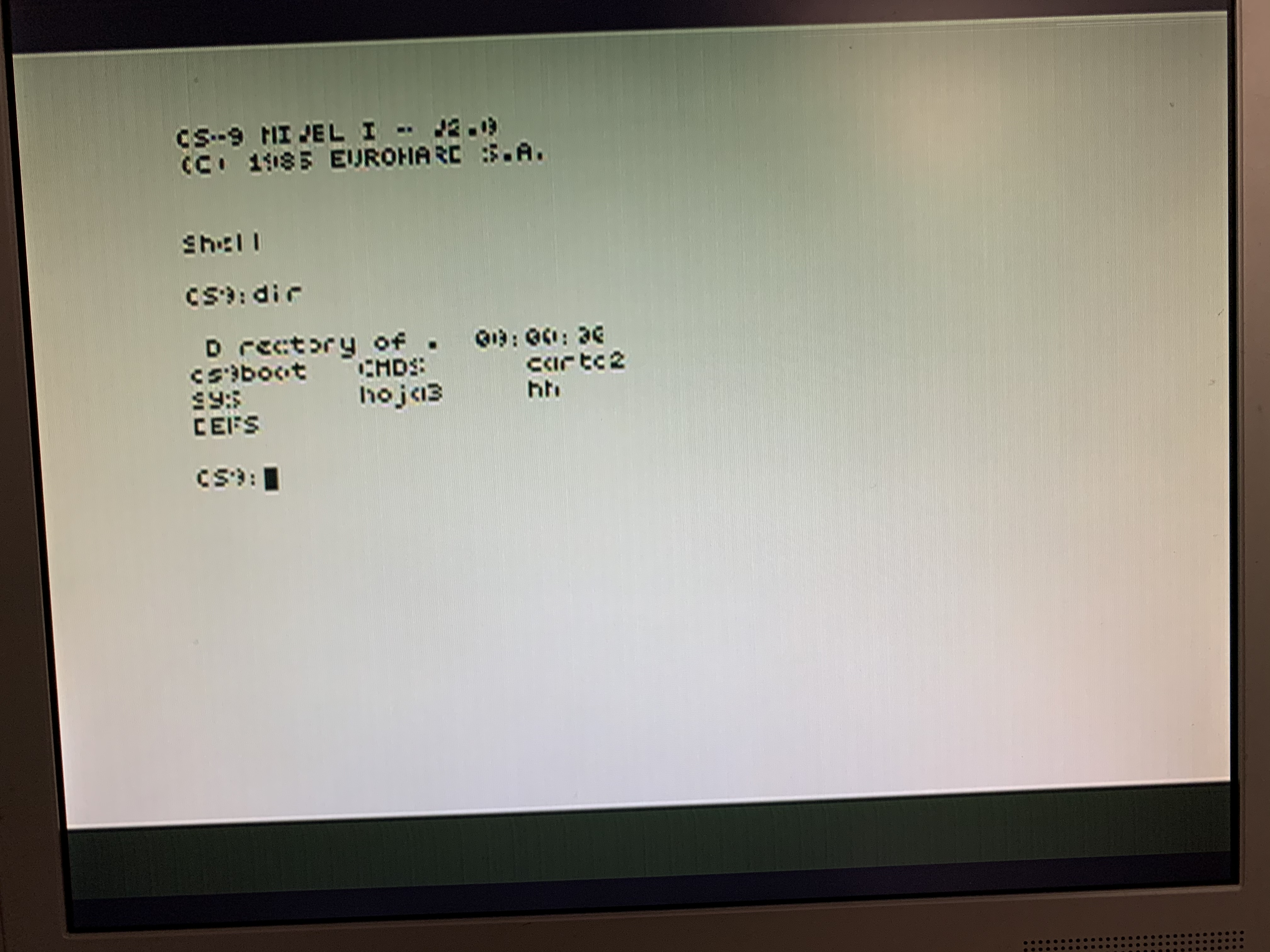

Loading OS9 with Zaxxon Disk Interface shows this:
Seems that the output is somehow distorted.
Can someone help me to sort that out?

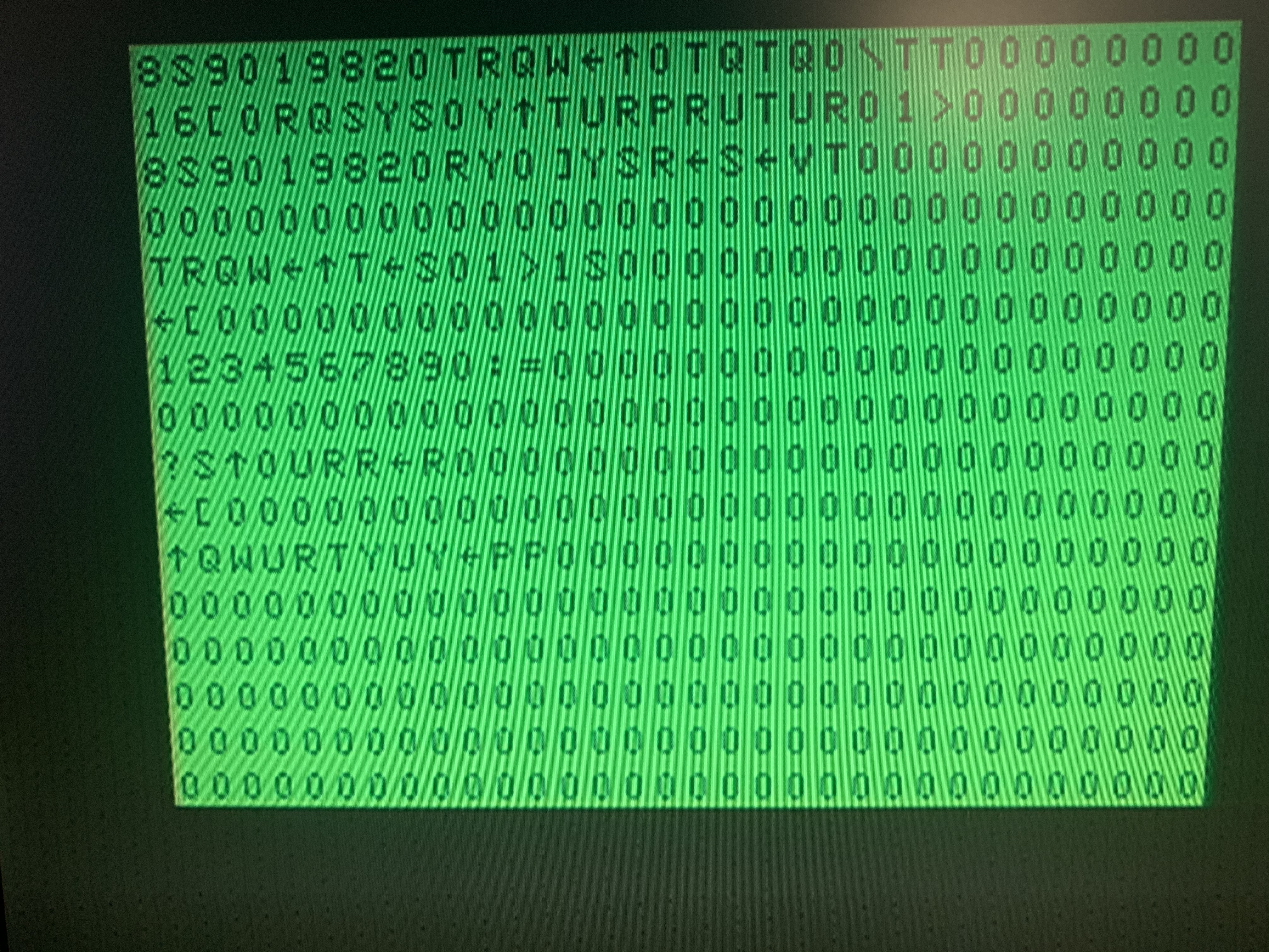

My Mainboard is an Issue 3.
As you can see in the first Picture, i pushed the first two lines of the keyboard.
Numbers are shown mostly correct but the normals chars are wrong.

Looks like a fault between RAM chip for bit 4 through the video data latch through to DD4 (pin 7) on the VDG, seeing as everything else is functioning.

ZahrlAn wrote: Thu Sep 17, 2020 6:50 am So, for a beginner, that means maybe i should check the connection of pin 4 of the VDG and follow the line to the RAM?
Sorry to ask in that dump behavior.
Well, it might not be this, but the first thing I'd be checking is pin 7 of the VDG (IC10) to pin 5 of the data latch chip (IC20, a 74LS273). It looks like something is pulling this line high. It's bit 4 of the data bus as presented to the VDG.
If you try the following little 1-liner after starting up an emulator, you'll probably recognise the pattern:
FORI=1024TO1535:POKEI,PEEK(I)OR&H10:NEXT

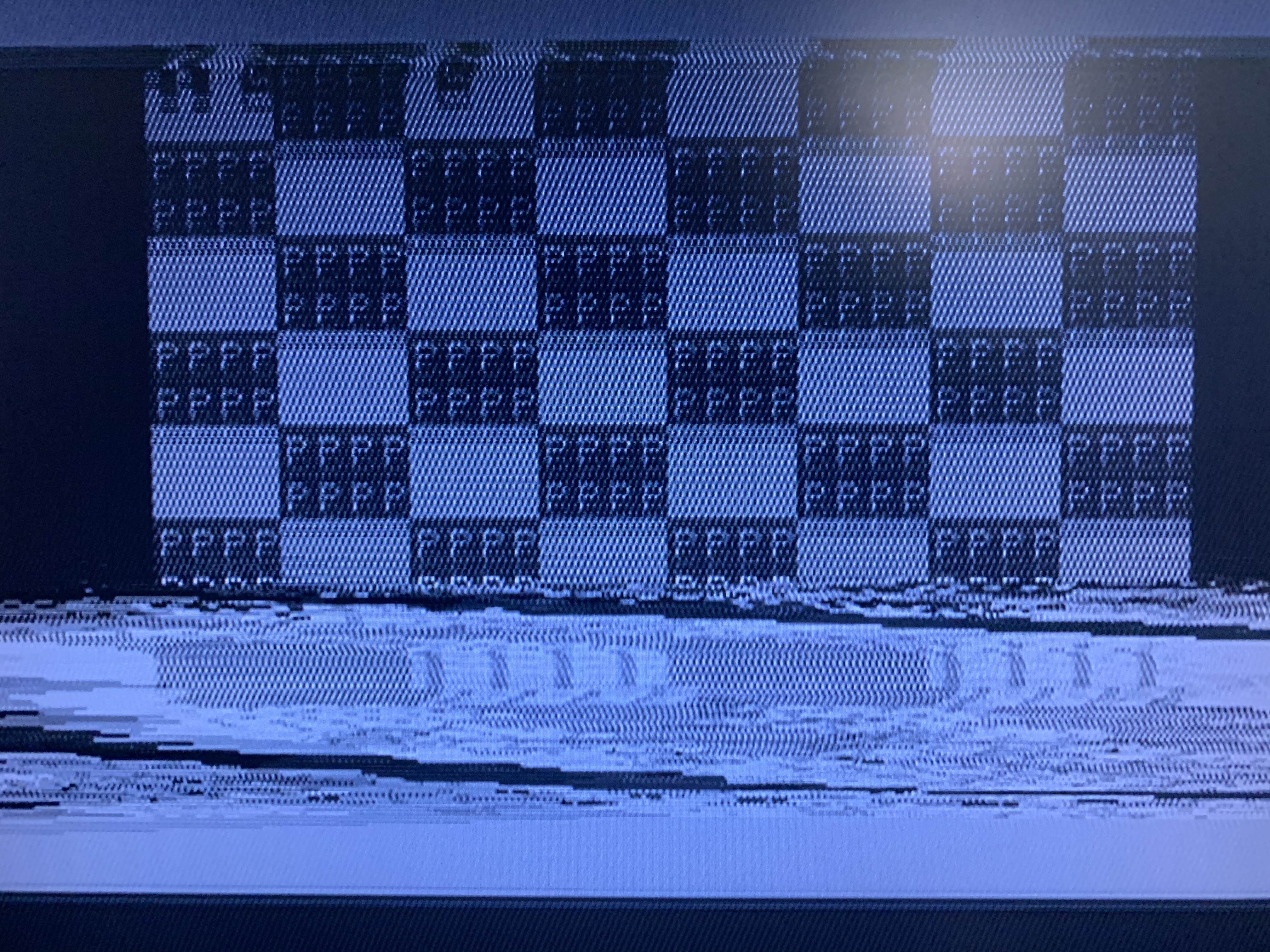

It‘s gotten worse.
Next time i turned on the Dragon it showed me this picture:
When i softly touch IC10 this is shown on the screen:
This doesn't appear when touching other ICs or anything.

Re: Dragon 64 - Charset issue
Posted: Sat Sep 26, 2020 6:46 am
by sixxie
Looks like uninitialised RAM, except bit 4 is still stuck high!
Now I'd be checking the CPU and SAM are still socketed ok - you mentioned reseating them before.
Some board photos might be informative... never know.
I can't offer to attempt repair, though there are others on here who might.
