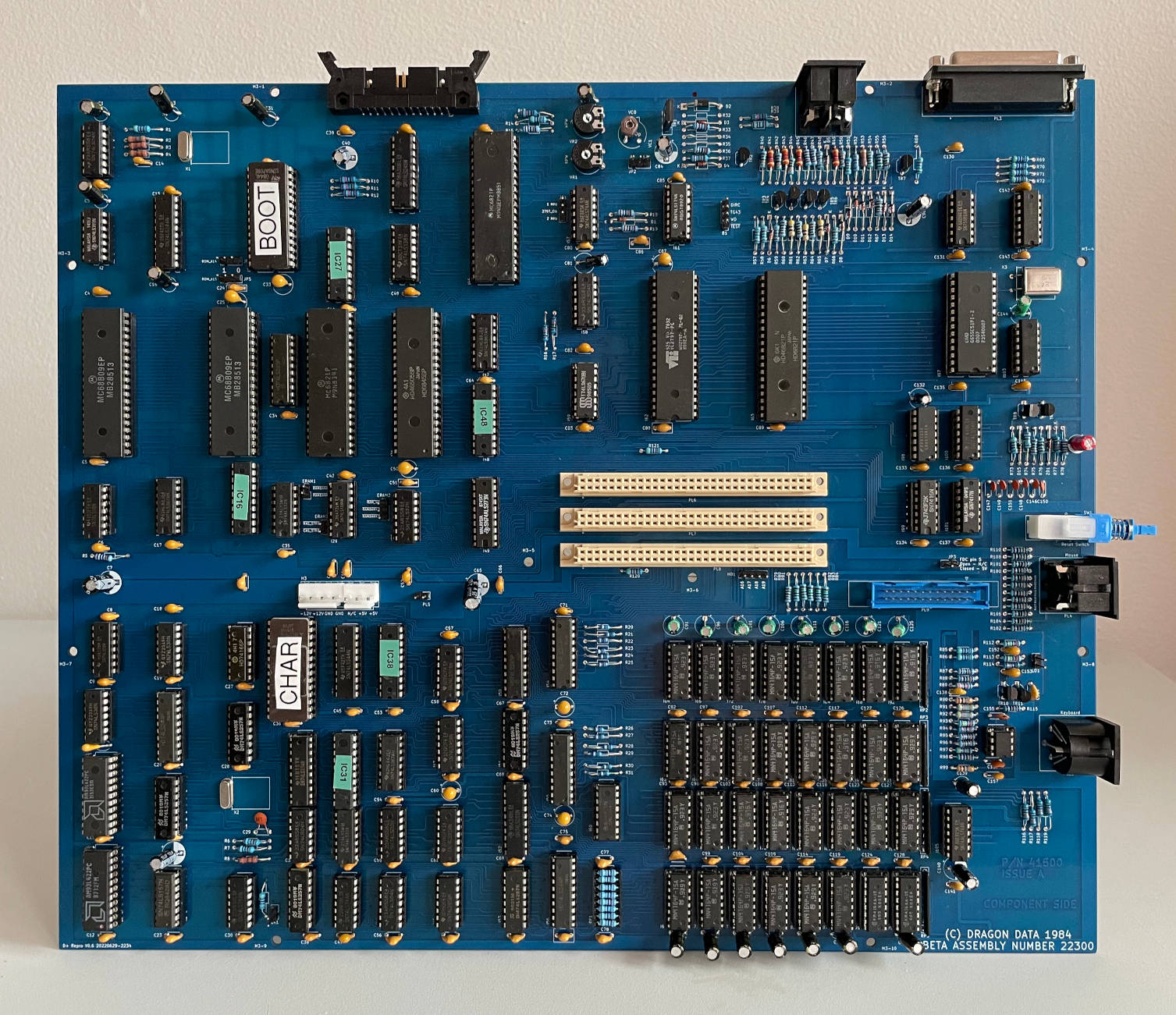

Posts: 1711
Re: Dragon Beta GitHub
Behold!
A fully assembled Dragon Beta board! :mrgreen:
I need to make a video cable and probably use my trusty Meanwell PSU to power it. Fingers crossed...
Posts: 1484
robcfg wrote: Fri May 24, 2024 2:33 pm A fully assembled Dragon Beta board! :mrgreen:
Niiiiice. Good luck!
Posts: 209
robcfg wrote: Fri May 24, 2024 2:33 pm Behold!
Awesome - how did testing go?
