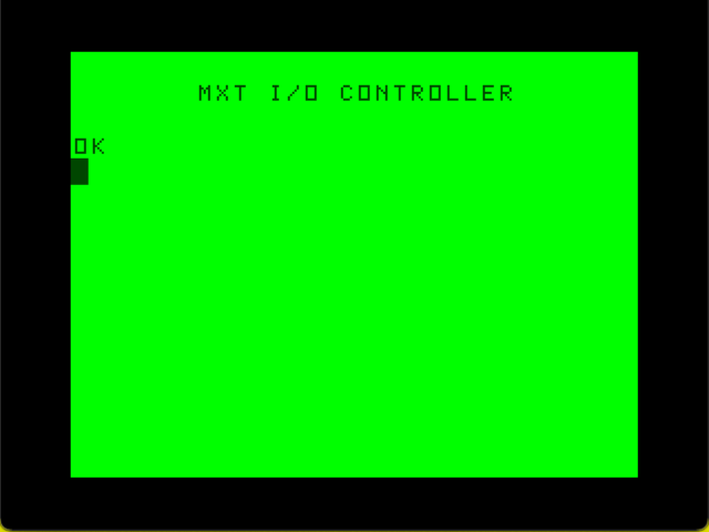

Success!
The cartridge has a 2KB rom and it boots with XRoar :mrgreen:
I've attached the rom file and a screenshot.
MXTIO.rom.zip
(2.32 KiB) Downloaded 898 times

robcfg wrote: Tue Dec 27, 2022 11:15 pm Success!
Yes thats the screen I get when used in a real Dragon 32 or 64.
Is there any way of getting data from the rom file that would help with the functions and syntax
