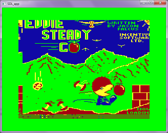

Posts: 1665
Re: Dumping protected games?
I mean something in the line of the attached screenshot :mrgreen:
And it freezes there.

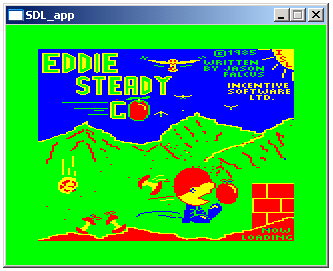

Sarah
Posts: 177
Post by Sarah »
Looks like something's wrong with XROAR. This is what I see using any of the CAS files with either PC-Dragon or T3:
The game then starts once loading is complete...
Posts: 1443
Looks like the main problem here is that XRoar doesn't account for how long has passed when writing out leaders. When it "desyncs" (ie, detects that the ROM is now trying to sync with leader), it just adds in a 256 byte leader. This isn't long enough for Eddie Steady Go (and the generated CAS file won't load into a real Dragon either). Here's one with the code hacked to generate 384 byte leaders instead.
I'll try and make XRoar actually insert leaders corresponding to how much time has passed when the ROM syncs up.
