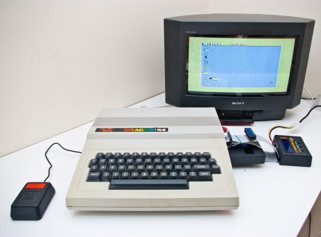

Just to keep you all posted - with the addition of a power supply and floppy cable from Maplins, my HxC is up and running. I'm amazed what a simple procedure that was - my only mistake was putting one of the ribbon cables on upside down. Now I'm off to download all the interesting looking disk images from the archive. Attached is a photo of the working system - with WIMP running in the background.
Thanks everyone for your help!

Dragon 64 with an HxC floppy emulator
