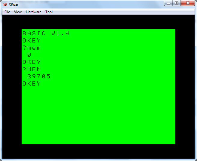

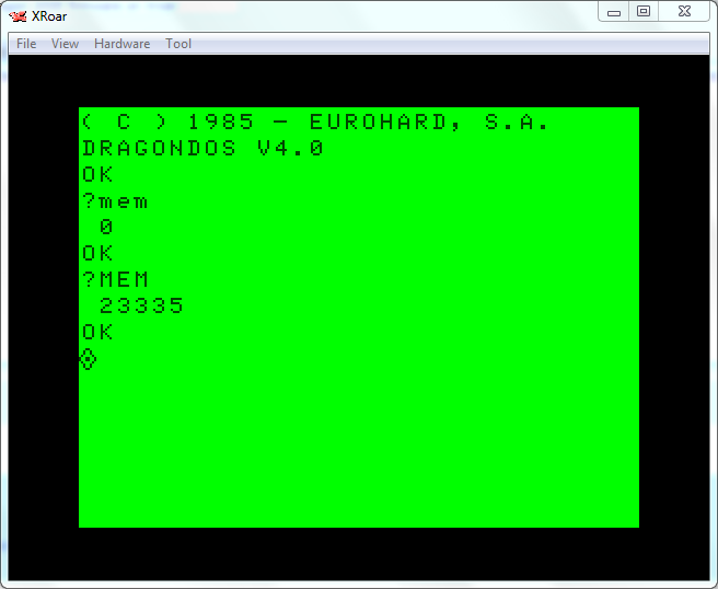

Something interesting I found is that while in the lowercase mode, if you type ?mem it gives ya a result of 0, when it should give ya the rough amount of memory you have available.
This is true in 32K mode:
And in 64K mode:
I thought it would just give ya a syntax error, because I tried running EXEC on lowercase and it gave me that exact error.
