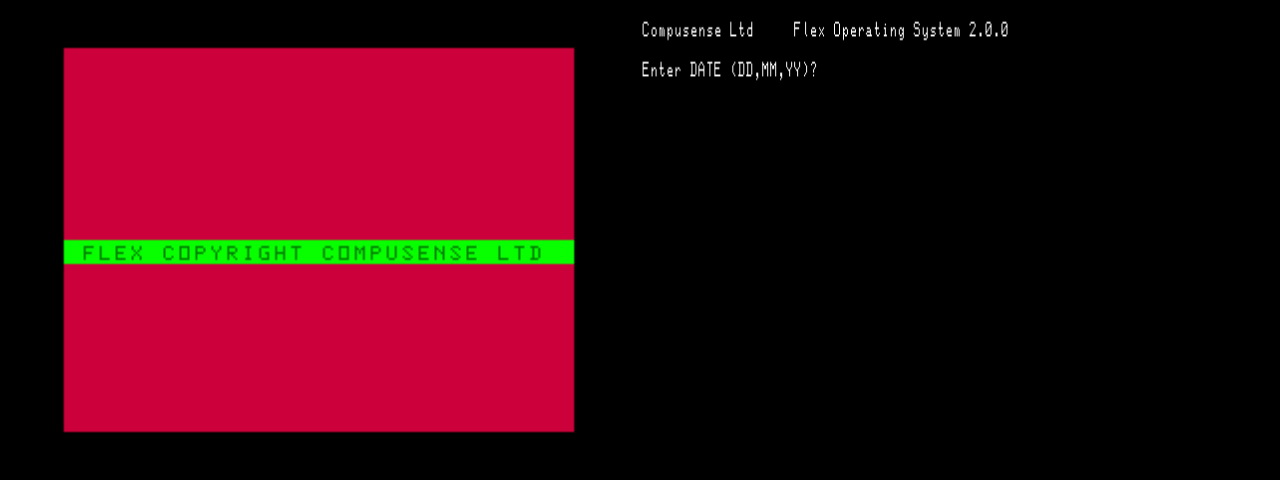

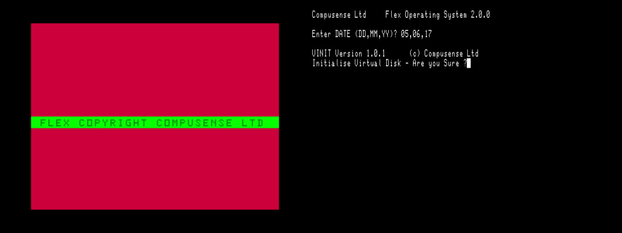

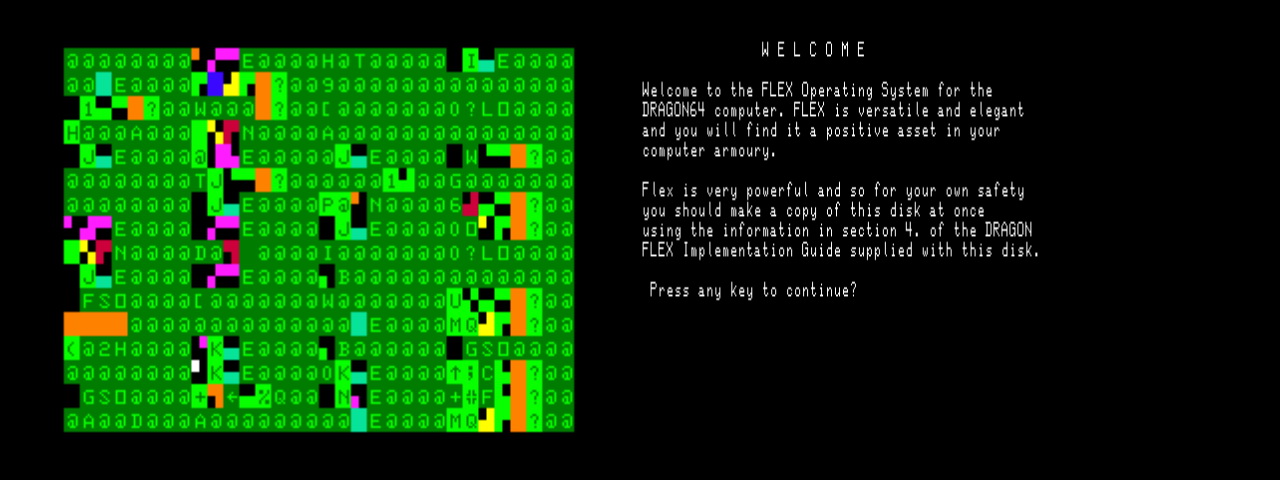

I'm emulating the Dragon Plus board in MAME and have a few questions. Hopefully someone with experience with this board can help.
I've attached a couple of current screenshots running FLEX from the archive to show what it looks like at the moment. With the board installed there are effectively two video outputs, the original VDP and the 6845 on the board. MAME shows both outputs side-by-side as you need the VDP screen to initially load anything.
And now the questions ...
- the board has a PROM, what is this used for?

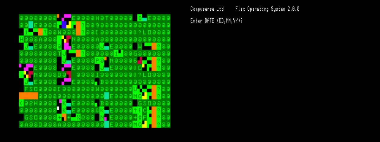

- my VDP output gets garbled whilst running FLEX, is this expected?

Some more progress:
It looks like I've fixed my banking issues and the VDP output no longer gets corrupted.

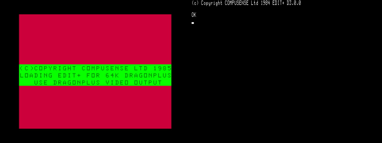

- what does the cursor look like, a solid block or an underscore as in my EDIT+ screenshot?

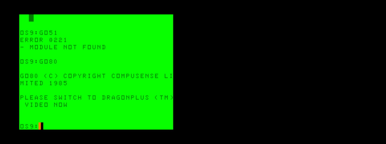

I also tried the OS9 for the Dragon Plus from the archive. It doesn't even switch to the plus videoram to write anything to it. Not sure whether this is due to GO51 not being found or maybe a bad floppy image.
I'm pretty sure you've already checked our Dragon Plus page. I uploaded there a picture of the character set that shows a solid block cursor, but that's based on the data on the eprom chip so I cannot guarantee how it looks until I get the board working.

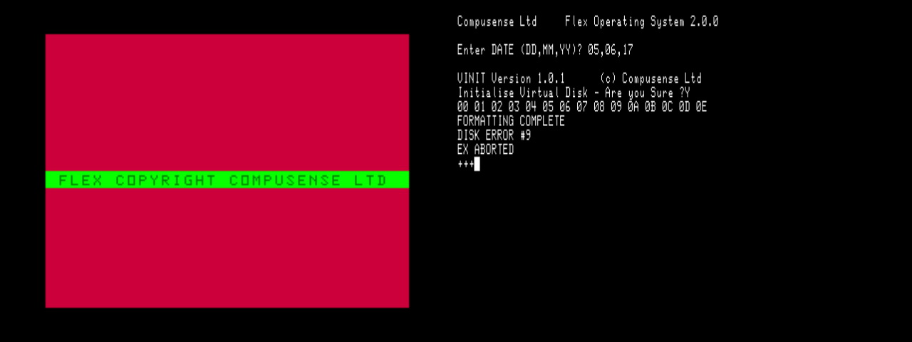

This is your new dump of Editor & Assembler:
Looks like initialising the virtual disk writes to the wrong area, it' a good test case :)

I did find that when I put Simon's prom in my Plus board that it worked, so I know the prom in my board is knackered :) Just need to re-implement it in a PLD of some kind to get my board working, don't think an eprom would be fast enough.
I also found that I couldn't get OS/9 to work with the board but got Flex working ok.

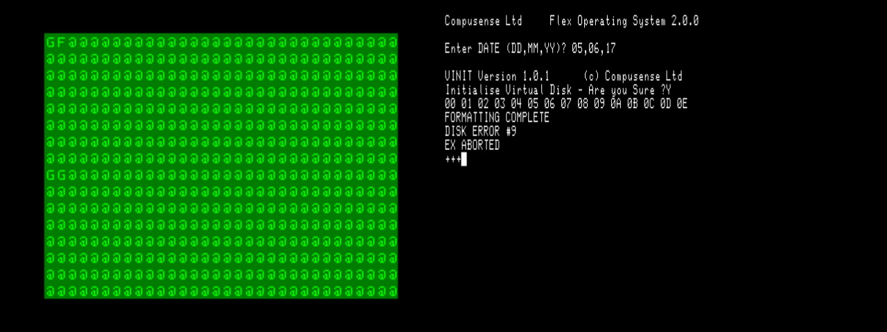

The virtual disk now initialises and I can see the RAM being formatted.
I've no idea about the disk error though. Is there a FLEX manual anywhere?
