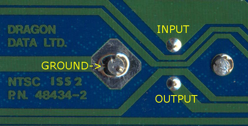

To try to resolve this doubt, I attached some photos.
http://i68.tinypic.com/1zb8i8w.jpg
http://i64.tinypic.com/2ihb5fp.jpg

I was right!
Your motherboard is a Tano NTSC board!
Check the board number here, in our motherboard scans section.
Try your machine on a TV that supports NTSC to check if the image keeps disappearing.

It's crazy but it's true. The motherboard is a Tano Issue 2.

Hi again! Here I am with more data to share, ;)
from top to bottom (regulators pins):
-11.90V
-18.20V
0V
+11.85V
0V
+18.21V
Do you see correct voltages?
Thanks in advance!
Joe Morgan
Re: Some problems with Dragon 64
Posted: Mon Jan 18, 2016 5:17 pm
The output voltages seem Ok.
Can you test the 5V regulator output?
