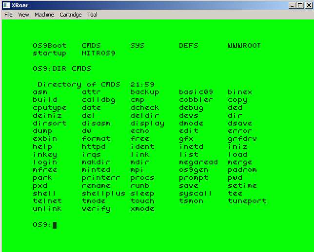

Re: Dragon OS9 with drivewire support
Back again, Jon
I have started my Dragon (without drives) but connected to the PC via DriveWire.
With drivewire having in slot0 the NitrOS-9 disk for DW, I pressed Shift to avoid autorun...
Then DLOAD"DOS" has started NitrOS-9 without problems
So I think there is some sort of uncompatibility with XRoar that forces the use of HDB-DOS
You could use your Dragon with NitrOS-9 without floppies attached, great!
Hi Ken,
I have the file "nos9v303_d64COHR_becker.dsk" mounted as Disk0 in DriveWire
Then I start XRoar without DDOS or with DDOS11C
When I enter
DLOAD"DOS"
The screen shows the message "NITROS9 BOOT"
But nothing happens on the screen, it simply hangs the computer.
But ... if I do that with HDB-DOS installed in XRoar, it starts perfectly with both sentences:
DOS or
DLOAD"DOS"
So, what am I doing wrong?
I don't know why 'must' I have HDB-DOS installed to start NitrOS-9 ...
When I enter
DLOAD"DOS"
DOS or
DLOAD"DOS"
