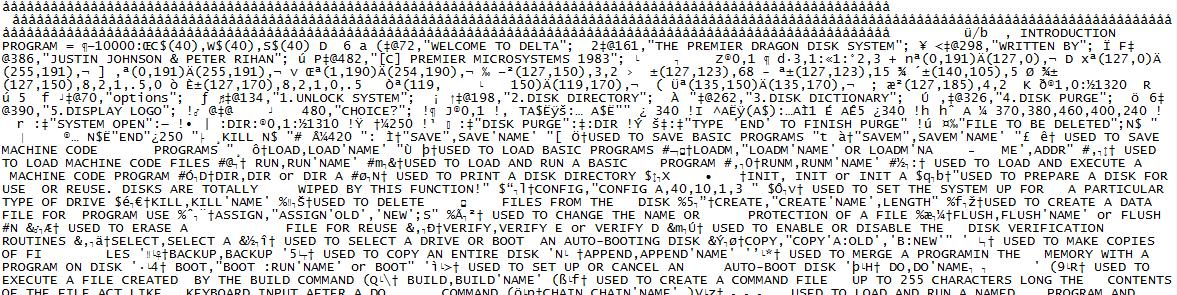

Thank's for all the help so far, I looked at all the software suggested and found that Anadisk as suggested by Phill was the one that worked (well, the one that I got to work anyway) and I ended up being able to take a raw dump of the disk, the problem that I now have is how to convert it into something that Xroar can use?
I have opened the 104kb file with notepad and found that there is some personal data from the previous owner, which prevents me from uploading the file unfortunately, but I have included a small portion of the file here, this is about 25% of the text, the rest is mostly blocks of the a's as seen at the top of the jpeg.
Delta disk.jpg (176.26 KiB) Viewed 8377 times
At least I know that it is definately a disk from Premier Microsystems!
