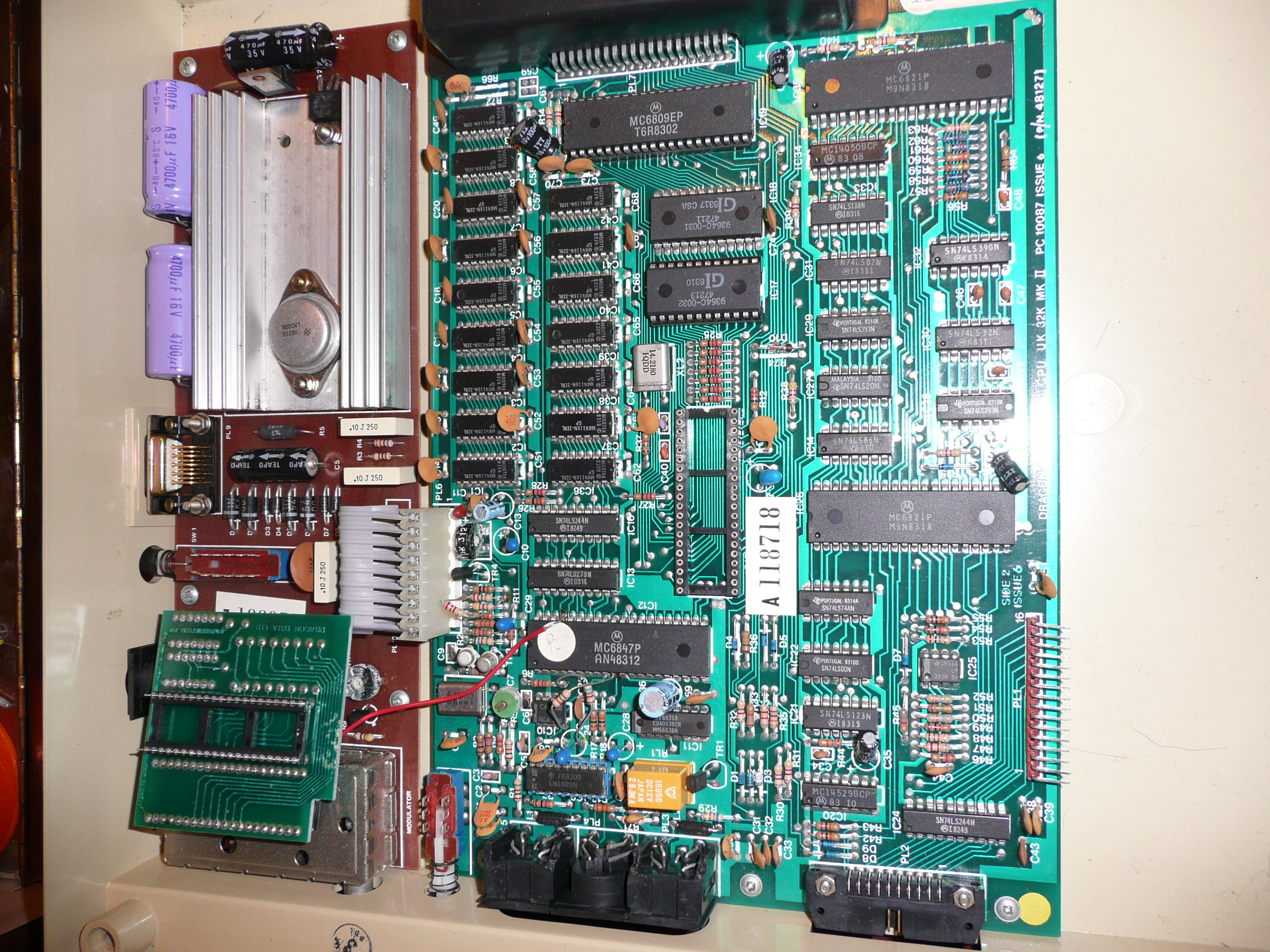

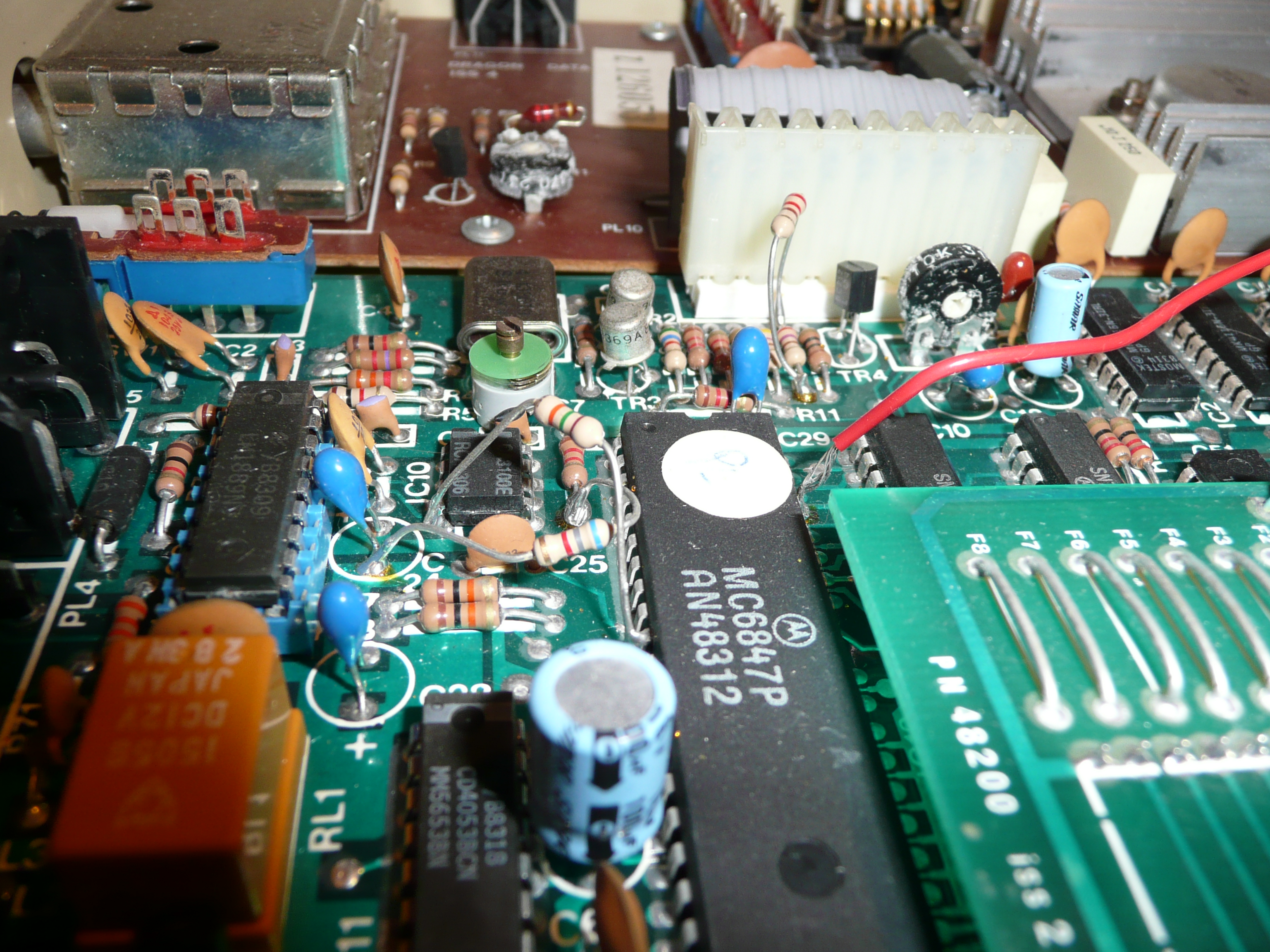

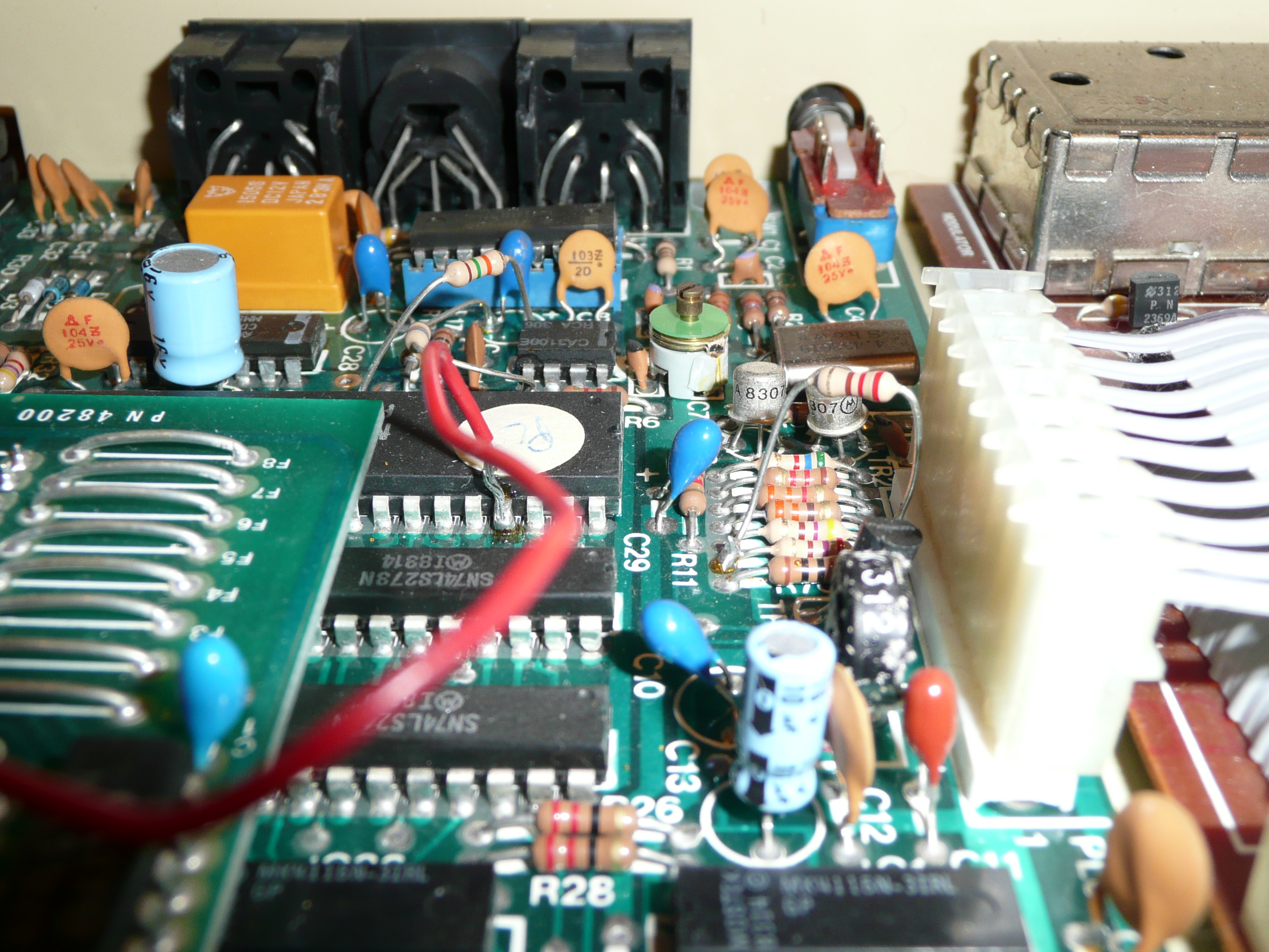

finally opened the computer.
It has a power supply ISSue 4 and the motherboard is MKII Issue 6
The great chips on the motherboard are: MC6809P, SC6847P and 2x6821P
Don't know ifthis minds, the ROM chips are:
IC17 - 9364C-0032 47123 GI8310 in a socket
IC18 - 9364C-0031 47211 GI8317 soldered on the mainboard

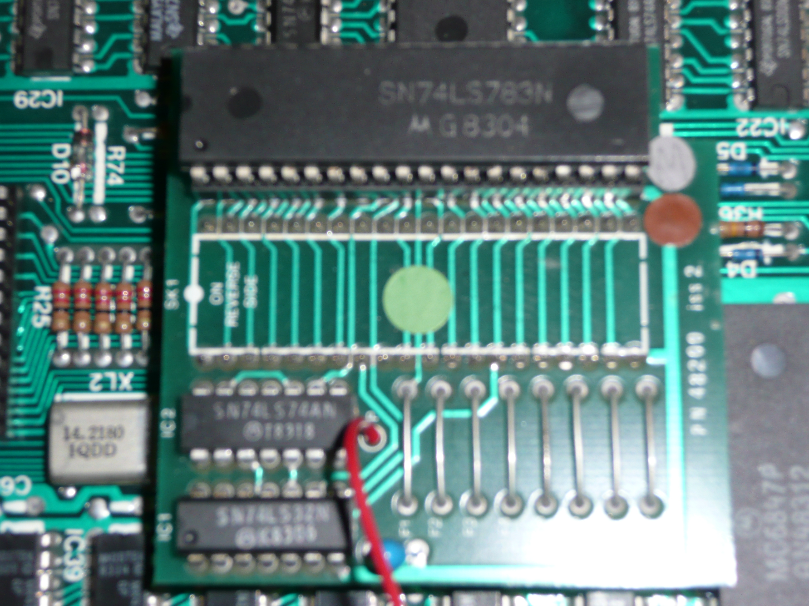

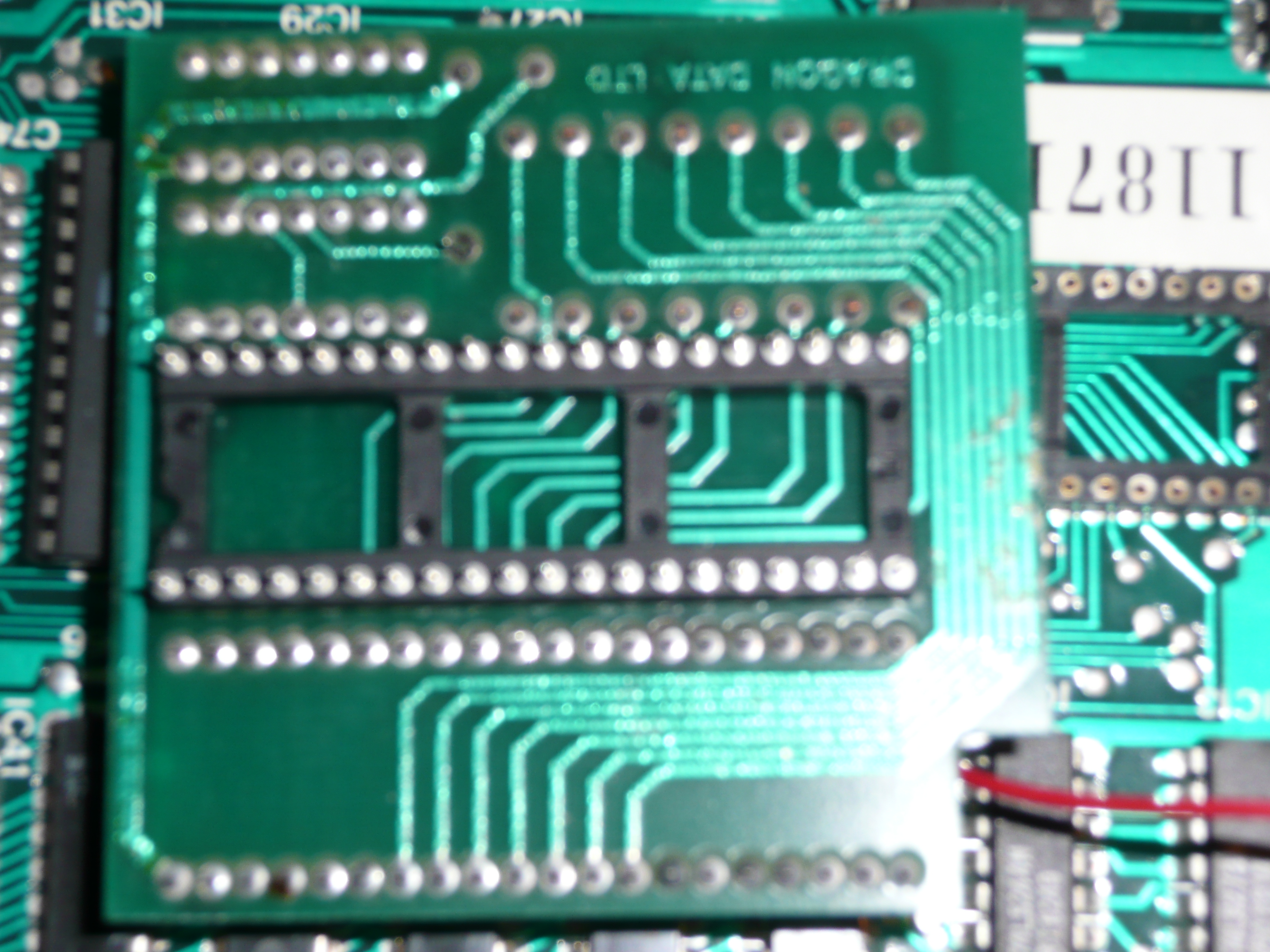

Then on the daughterboard sit these ICs:
IC1 - SN74LS32N it's a Quad 2-Input OR Gate
IC2 - SN74LS74AN it's a Dual D-Type Flip Flop
IC3 - SN74LS783N, one of the std SAM
The daughterboard has this part number: PN48200 Issue 2
If I have misse danything or you need more info, just let me know, the case is not yet closed
I try to add some photos
