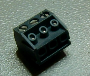

Maybe you could take headers, with screws, like this one:
But those have a 200 mil spacing, so you'll probably have to change your board design a bit.
Re: I/O Cartridge (Show and Tell)
I'd suggest to use male headers on the board. Then you can use wide, female headers for more permanent setups, or just Dupont wires for prototyping. Dupont wires and headers are nearly for free on eBay. Rolo's headers with screws are perfect on the front-end, where stuff/sensors/relays etc are connected with long wires, but I guess that would be on a second board.
