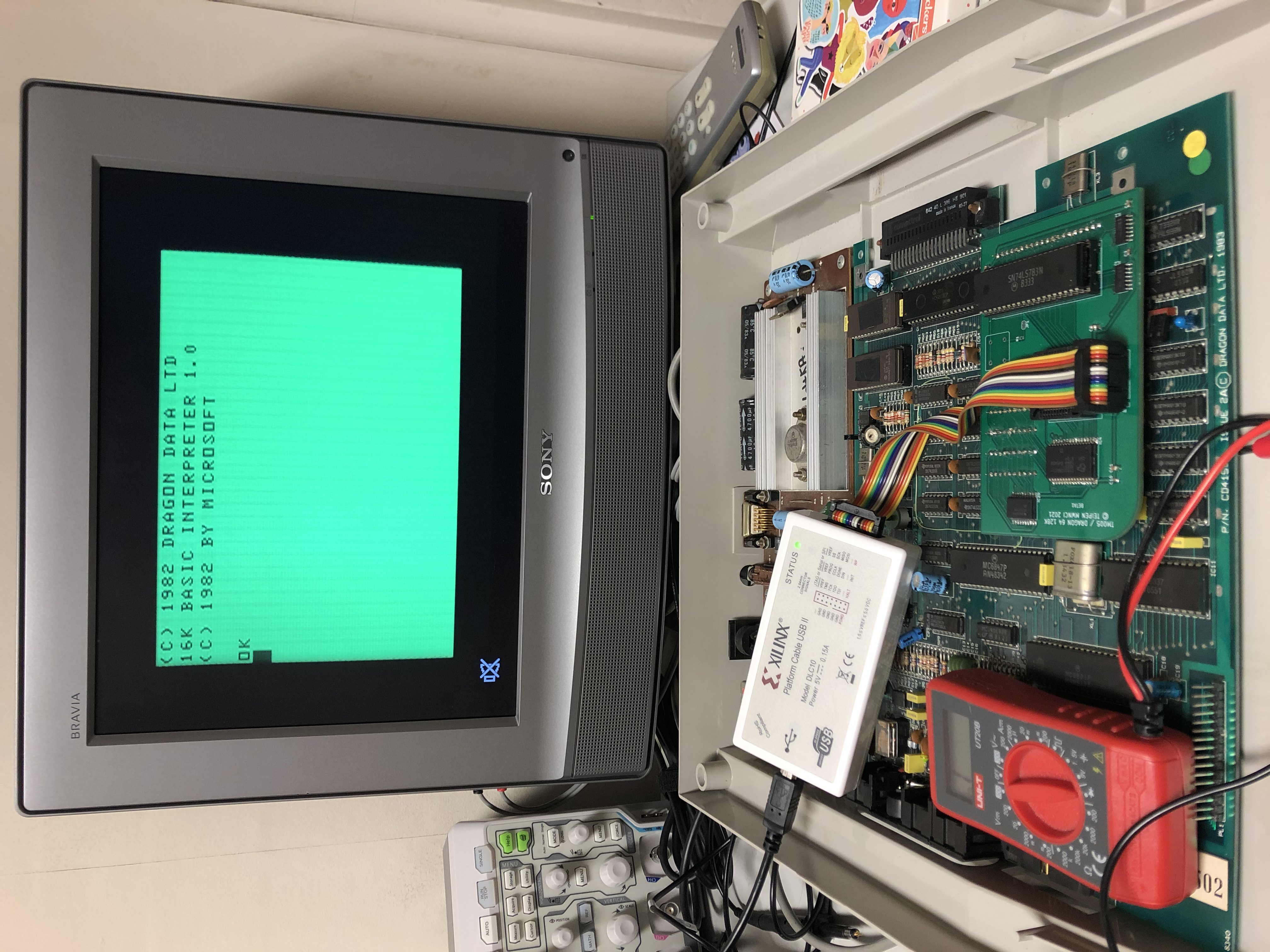

Definitely possible, and straightforward:
You can see it plugs in where the latches/transceivers to the VDG and CPU go, which is how it somewhat solves the Din/Dout thing.
The "only" problem with that (only 128K) board is it doesn't work in high speed mode. As "someone" pointed out to me, I oops missed a CPU latch. Ah well, that's what prototypes are for. Working on a 512K internal version...
