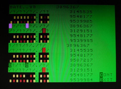

I get something like this ... always a different pattern every time i type SDIR.
Well, i can't use an other card, 'cause i've seen, that the CoCoSDC only uses MMC SD cards. Ordinary SD cards won't fit, 'cause therey a too thick. And i have only one MMC.
Posts: 1850
Re: A DOSPlus Extender for Drivewire & CoCo-SDC
That screenshot shows that the DOSPlus5.0 extended receives 'bad' data to its
requests to the SDC firmware (microcontroller)
First of all, we must ensure that the CoCo-SDC is hardware configured to
work with the Dragon.
You should look at the 4 DIP-switches and verify they are ok.
The one called DRGN should be ON
and the other three should be selecting the default bank number
If you have DP50 in bank 1, switches 2 and 4 should be OFF and just 1
had to be ON
Internally there are three pins labelled
DRQ - central - AUTO
For the Dragon there *must* be a jumper between DRQ and the central PIN
But this must *not* be there for the CoCo!!
