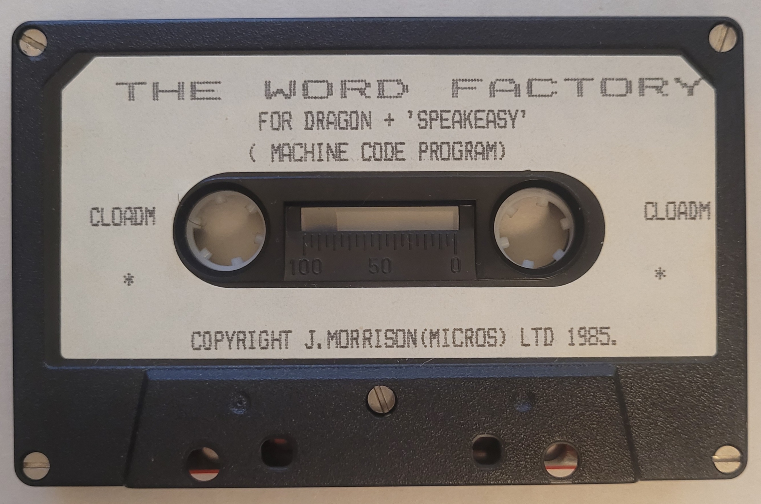

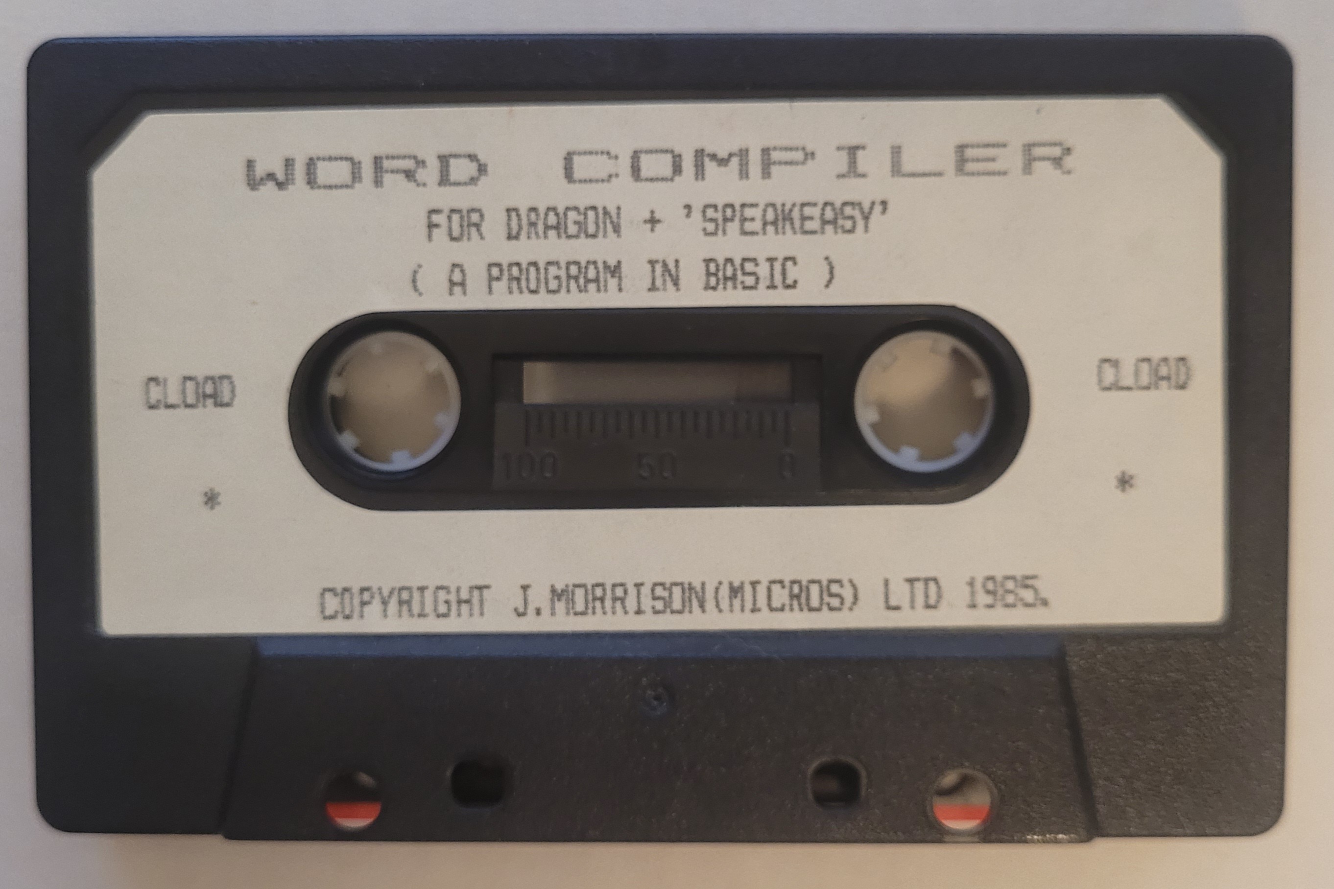

After some messing around with a terrible tape unit that I recently received... and reverting to a previous tape deck, here are the two programs shipped with the speakeasy.
word_factory.cas- (5.58 KiB) Downloaded 966 times
word_compiler.cas- (5.49 KiB) Downloaded 1104 times
