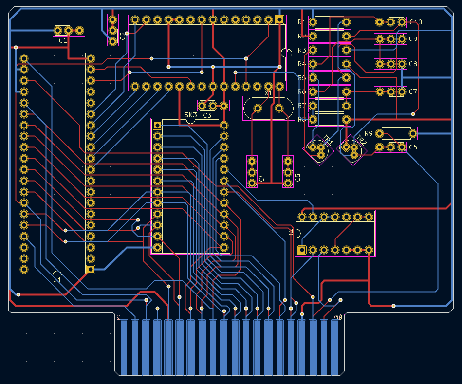

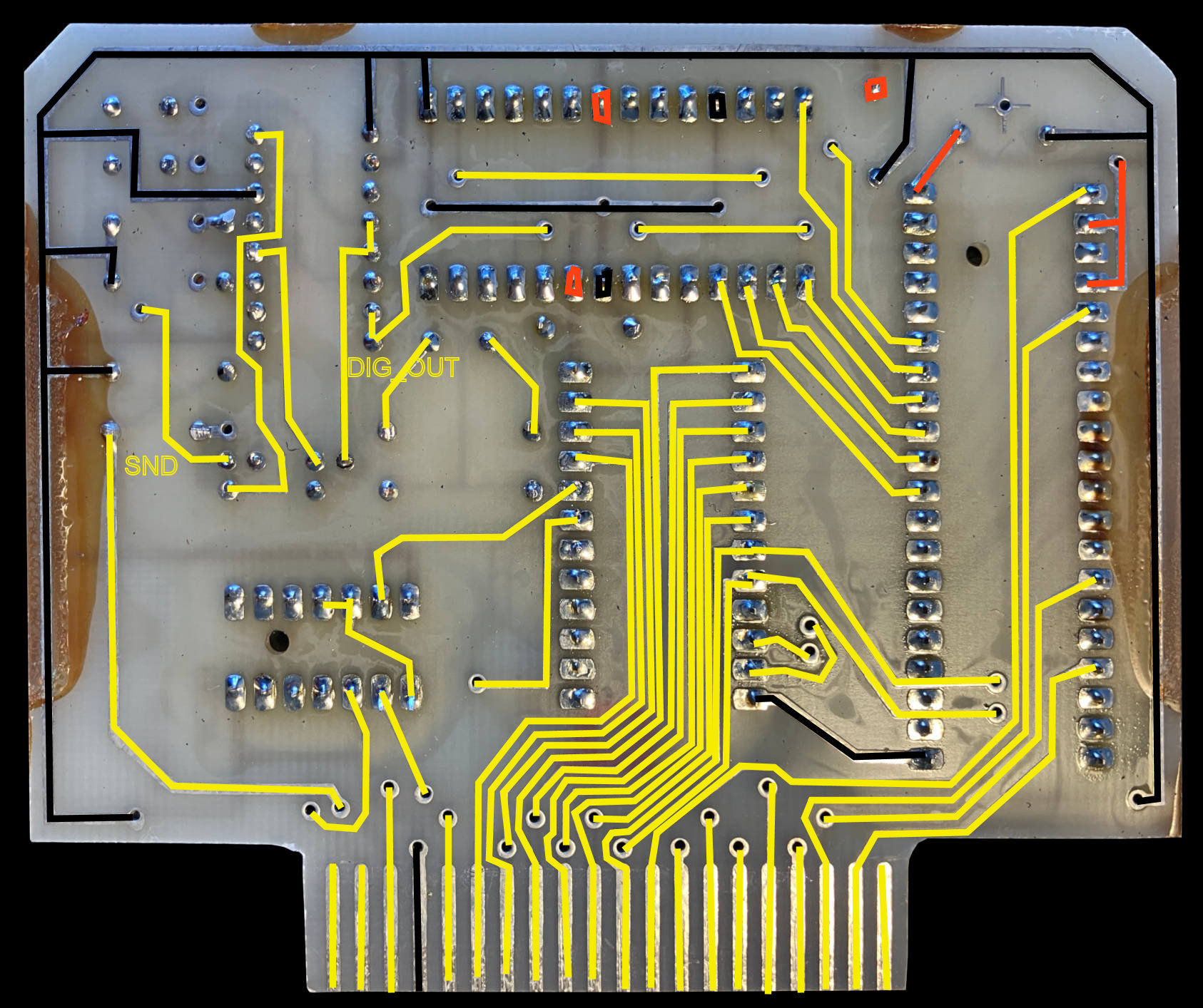

robcfg wrote: Fri Jul 07, 2023 10:00 pm Oh, Rolf, if you could take a picture of the solder side with a bright light shining at the component side (with the components removed), I think we would be able to see most connections.
Don't hate me :lol:
Thanks, but I've got the underside done correctly. It's the remaining silver tracks on the component side that are stumping me, though you clearly have better eyesight than me on some of these links. I just could not see the link between the transistors.
Posts: 1707
Re: WHOOPS ! (oh not not him again)
Let's see if this helps ;)
Green is component side and orange is the solder side.
Notice that there are a couple of links missing because of the sockets.
Posts: 208
Thanks - that may help a lot. I'll take a look tomorrow.
Posts: 1707
Oooooh, looking good!
Tell me if you need the file with all the layers.
Posts: 208
Right - I think I've done it finally.

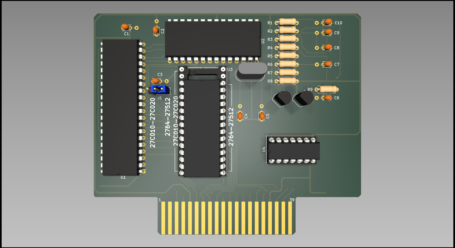

I may replace the 2732 layout with a 2764-27512 one, to make sourcing EPROMs easier.
Posts: 1707
That is one nice looking board!
I think using 2764-27512 is a good idea, and I'd like to expand on that by asking if it would be possible to include the 28/29F010/20 as they have basically the same pins as the 27512 save for the Vcc and the 4 extra pins.
I think they would be even easier to find (I have several from old PC motherboards) and we get one more option to source chips.
Posts: 208
robcfg wrote: Sun Jul 09, 2023 12:08 am That is one nice looking board!
I'll give it some thought - depends what I can squeeze in. I'm not going to make these boards - but will offer the files/gerbers on my Github. This whole exercise is because I want to use this as a sample project for a CPLD experimenter board that I am making (SuperBob).
