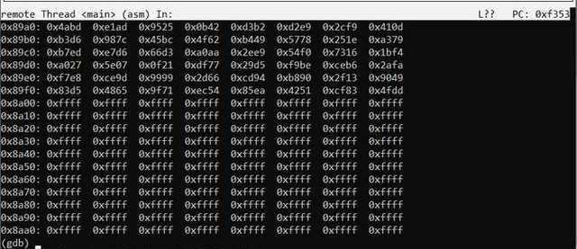

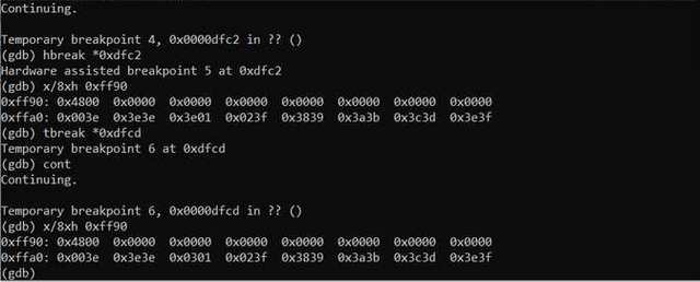

let me talk one more time about the graphics memory (for PMode4)
In the module Kbvdio there is a call to the OS9 function F$SRqMem that asks for $1900 bytes
Next image shows the values of the MMU registers before and after that call.
Clearly slot 4 that had value $3e (unsed) before the call, has now value 03
so this slot has been used to map the requested memory.
Tracing the code we know it begins at $8A00 and ends at $A1FF (6,144 bytes)
00-Before and after requesting memory for graphics.jpg (17.32 KiB) Viewed 201 times
Later the program calls a subroutine added by Bob Hall that calculates the
value to be used to set/reset the SAM registers that control the beginning
of the graphics RAM. That SBR calculates value $35 but this would be pointing
to $35 x $200 = $6A00 but this would be wrong ...
I change that byte to $45 so that $45 x $200 = $8A00 as desired

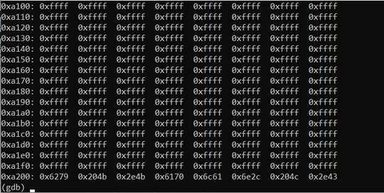

Tracing the code after that, once the screen shows totally white colour

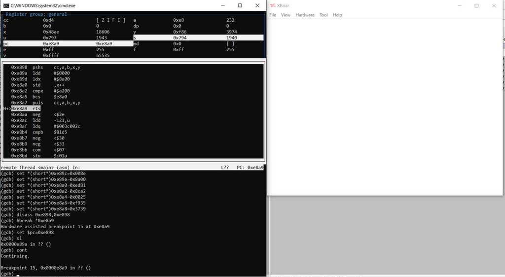

we can see that the RAM has value $FF (white) from $8A00 till $A1FF as shown in next images
01-After changing SAM registers value from 35h to 45h. Memory white colour from 8A00 on.jpg
01-After changing SAM registers value from 35h to 45h. Memory white colour from 8A00 on.jpg (34.55 KiB) Viewed 201 times
02-End of graphics clearly white colour till A200.jpg (34.72 KiB) Viewed 201 times

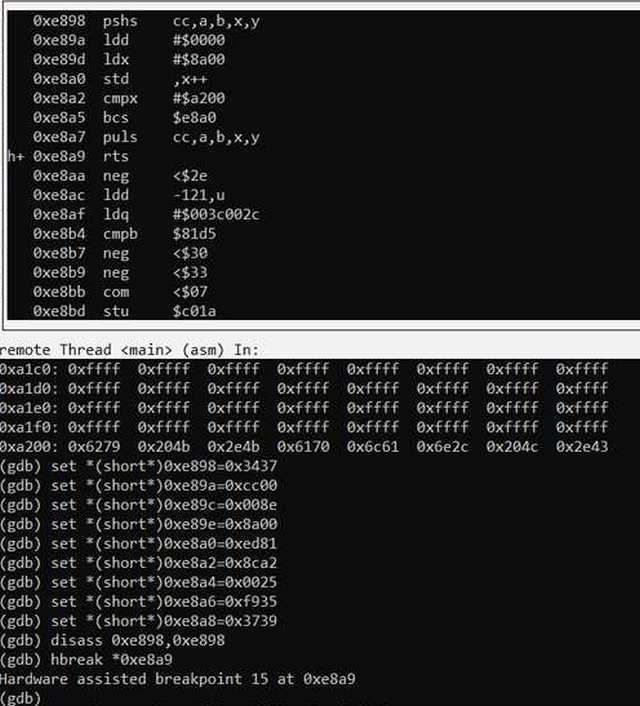

Then I have entered a small piece of code that puts zero into all
of the bytes of the reserved graphics RAM (colour black). See image below
03-Code entered in an unused area of Kbvdio. Pokeing zeros at the whole graphic area.jpg
03-Code entered in an unused area of Kbvdio. Pokeing zeros at the whole graphic area.jpg (51.85 KiB) Viewed 201 times
Executing that code with a breakpoint at the RTS opcode, there is no change
in the screen, it keeps being colour white :-(
04-After executing the code, nothing has changed on screen.jpg (36.45 KiB) Viewed 201 times
Examining the RAM from $8A00 to $A1FF shows us that all of the bytes have been
changed from $FF to $00 despite the effect is not shown on screen
05-But examinig ram from 8A00 it has changed from FF to 00 but changes NOT reflected on screen.jpg
05-But examinig ram from 8A00 it has changed from FF to 00 but changes NOT reflected on screen.jpg (30.39 KiB) Viewed 201 times
I have executed that code one more time, but no change at all on screen!
So, right now I don't know what's wrong with that.
Any idea to justify that behaviour?

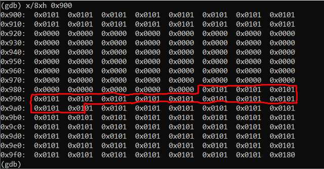

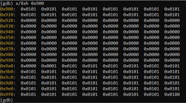

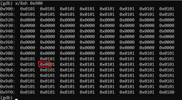

Posts: 1882
I have traced the OS9 function F$SRqMem to verify every step it does. It is using three system tables:
- from $200 to $240 each byte represents a chunk of 8Kb of physical RAM. By now it just controls up to 512Kb (64 bytes x 8Kb = 512Kb)
- from $640 t0 $64F (and $650-$65F) each word identifies the use of each MMU slot (value $333e indicates NOT in use)
- from $900 to $9FF each byte corresponds to a block of 256 bytes of logical RAM, every slot has 32 bytes (32 x 256bytes = 8,192 btes)
Value zero indicates unused
The boot procedure asks the system to allocate $1900 bytes for PMode4
I cannot get the idea behind that number. We really need 6,144 bytes = $1800
The search procedure is really a bit convoluted. The tables contents before the call are like that:
01-200-Table of physical 8k pages (by now 512k (200-240 only).jpg (13.94 KiB) Viewed 157 times
02-640-Table MMU mapped slots (1 byte each entry) Before asking for $1900.jpg
02-640-Table MMU mapped slots (1 byte each entry) Before asking for $1900.jpg (8.31 KiB) Viewed 157 times
03-900-Table 32 sectors x MMU slot. Used slots 0-5-6-7 Before asking for $1900.jpg
03-900-Table 32 sectors x MMU slot. Used slots 0-5-6-7 Before asking for $1900.jpg (54.54 KiB) Viewed 157 times
The OS9 function 'decides' to allocate $1900 bytes in a single block that begins at $8A00 and ends at $A2FF.
This seems strange to me because for an amount lower than 8K, it will need two MMU slots enabled.
Slot 4 uses $8000-$9FFF and slot 5 is needed to access from $A000-$A2FF
You can see the tables after the memory allocation
04-200-Table of physical pages after the call.jpg (14.19 KiB) Viewed 157 times
05-640-Table MMU after the call.jpg (8.25 KiB) Viewed 157 times
06-900-Table 32 sectors x MMU slot after the call.jpg (50.99 KiB) Viewed 157 times
Once received the pointer to the beginning of the allocated area, it returns $100 (not needed) to the system.
And now, I asume that, just to avoid changing the pointer to the beginning, the OS9 function F$SRtMem decides to deallocate
the last allocated block of 256 bytes. That one will stay 'orphan' between the other that have been allocated
07-900-Table after returning 1 sector (256 bytes).jpg (53.63 KiB) Viewed 157 times
And finally, the MMU registers are updated
08-Later MMU registers get updated.jpg (4.82 KiB) Viewed 157 times
