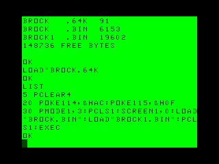

i now know that the game disks with filename extension .64k from Pulser and P.S.E., require DISCUP from the same company.
It moves the disk workspace out of the graphics pages back to their original postion.
it comes in 3 flavours
Dragon DOS
Super DOS / Dragon DOS 4
SoftDOS
load"discup.bin"
wait for motor to stop
type EXEC
it displays a RED cursor.
insert game disk with .64k files
load"brock.64k"
EXEC &H200 will clear Discup out of memory and detach DOS
