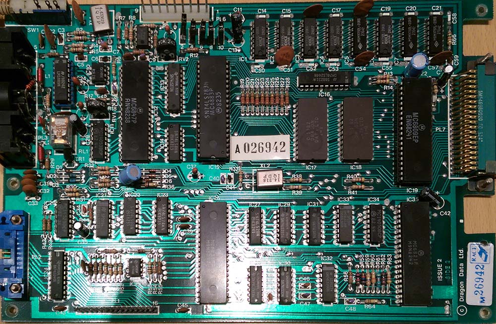

Could you tell us if the screen appears to be rectangular or square? There's a chance that your machine is a NTSC one instead of PAL.
Also, which is the motherboard model?
A picture of it may be helpful too.

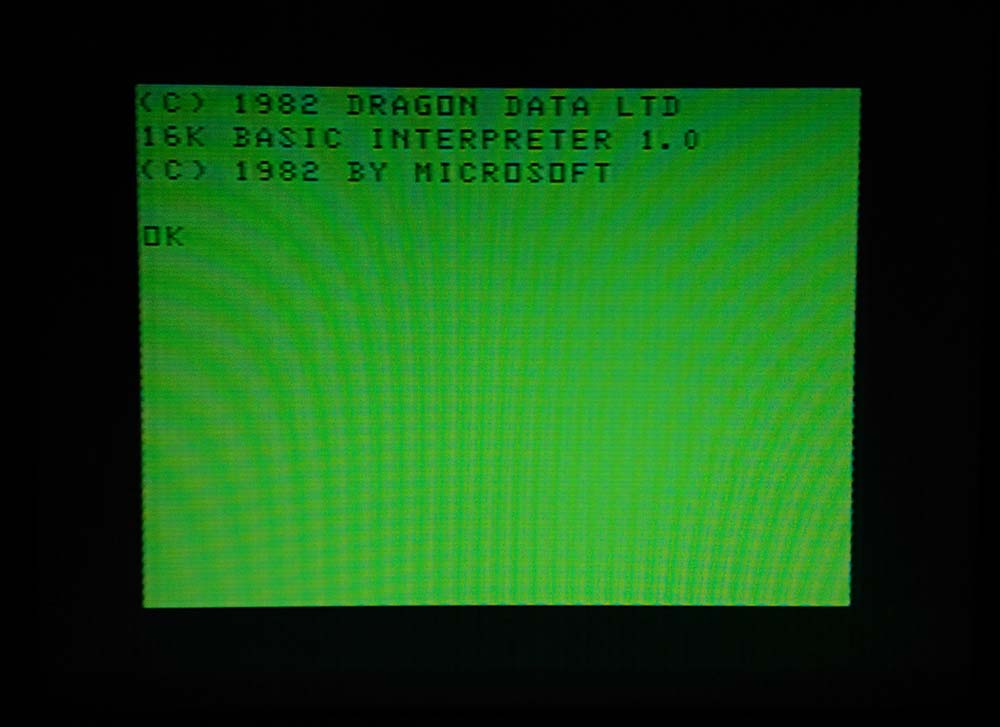

Cheers for the help guys. I have it working (of sorts). Opened the hood up (attached is a photo of the motherboard), and switched on. The image still flashing on the screen, plugged in via the monitor cable.
Started applying slight pressure across the board, and no effect.
Next I applied slight pressure to RV2, some slight flicker on the screen
Next I applied slight pressure to RV1, and BINGO screen went green.

Ok, it seems that your board is one of the first production batches, with 8x64 KB chips.
You can take a look at the different board revisions here.
A version with an addon to make the video output better (Part number 48200) was released with MKII Issue 6 boards, later included in the Dragon 64 boards.
