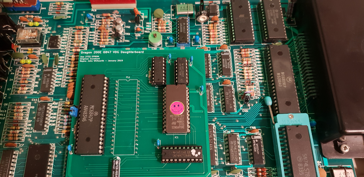

Now works just fine. Here is the daughterboard.

Excellent job!
