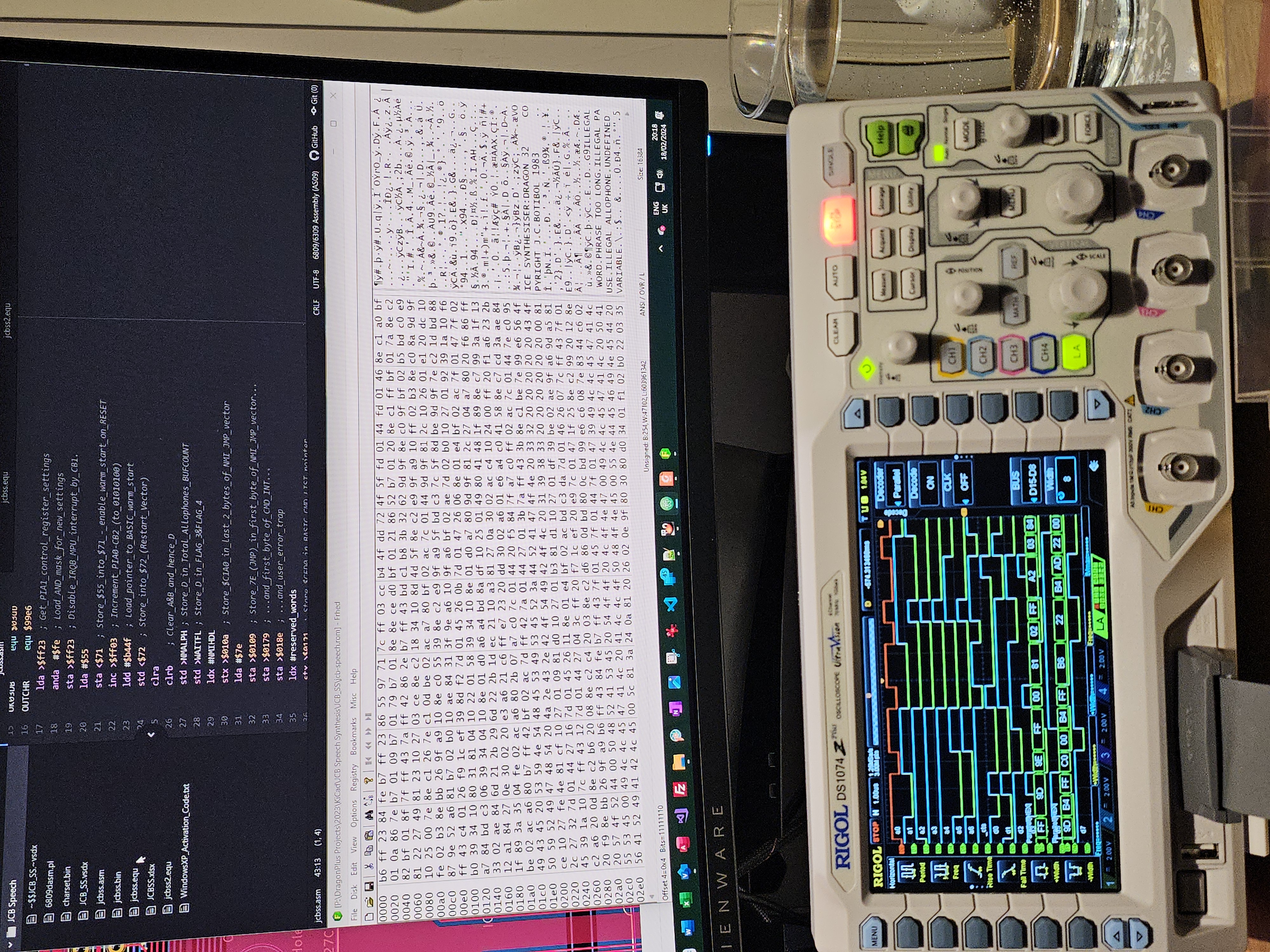

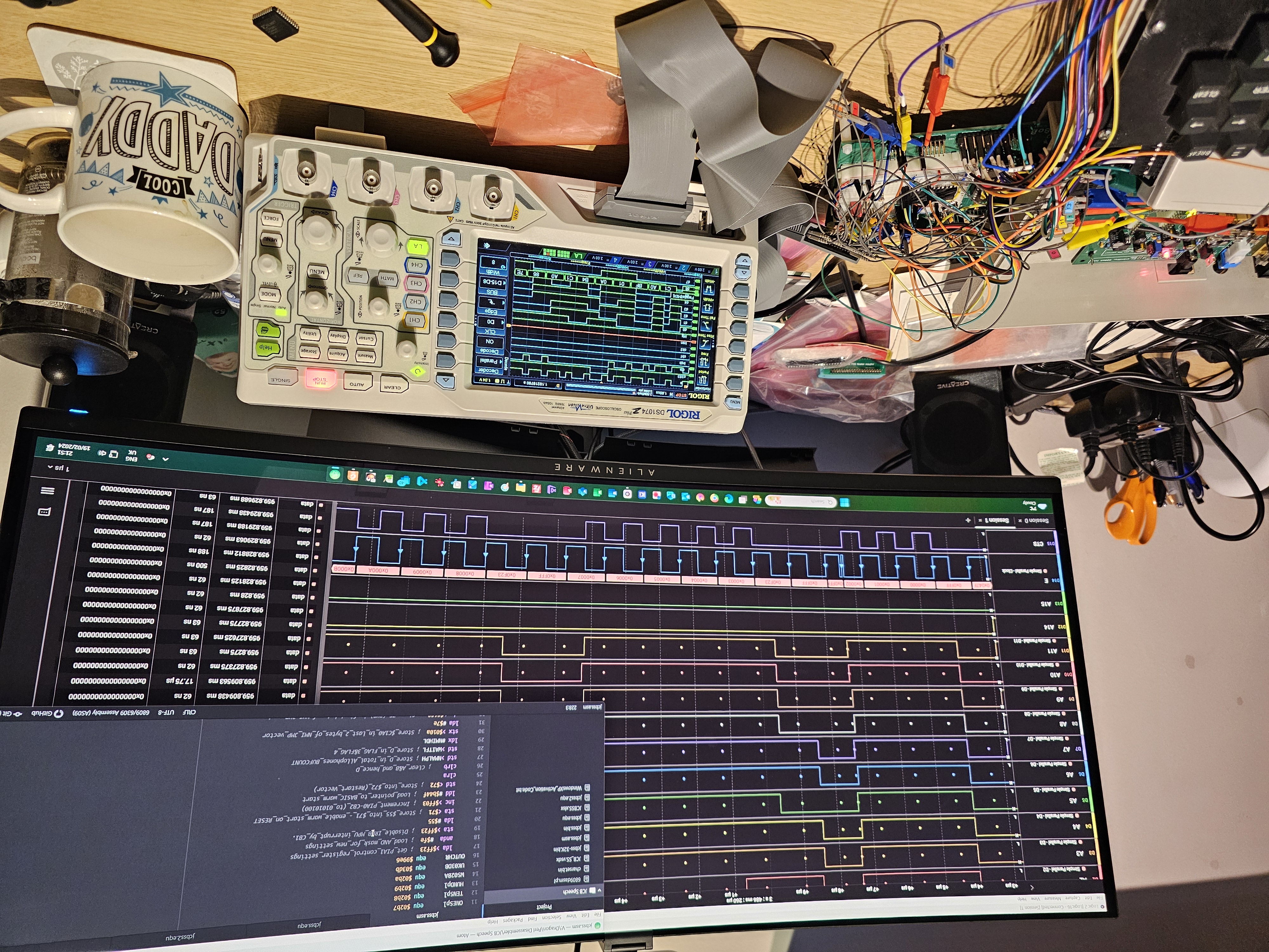

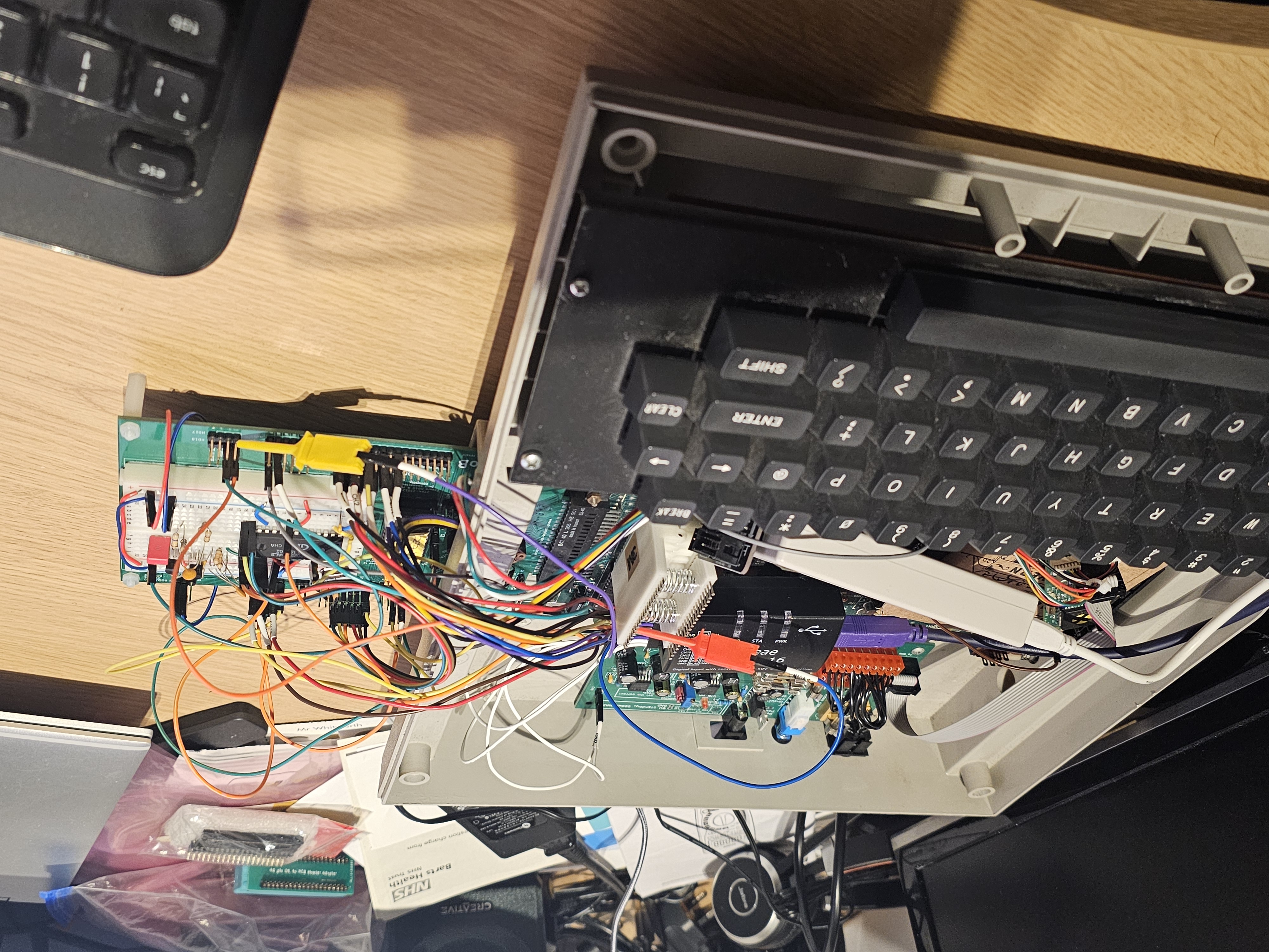

Here you can see me continuing to test the SuperBoB board. The additional boxes in the case are a logic analyser and a CPLD programmer. The connection to the PSU board is just a convenient ground for the logic analyser.
