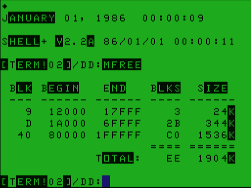

I'm pleased to report that we now have a working NitrOS-9 immunity build for the Dragon 64.
Pere has tested it and confirmed that it works on his Dragon + immunity.
The build is based on John Federico's code, which I adapted for the Dragon with some assistance from Claude.
The good news is that the CoCo version of Immunity appears to work on the Dragon without any additional hardware modifications.
Attached is a the Dragondos NitrOS9 immunity boot disk and readme file.
Screenshots are from XRoar. I hope Pere can post some real dragon photos. I will share the source once we also have a working cocosdc build.
Ken
Ken
