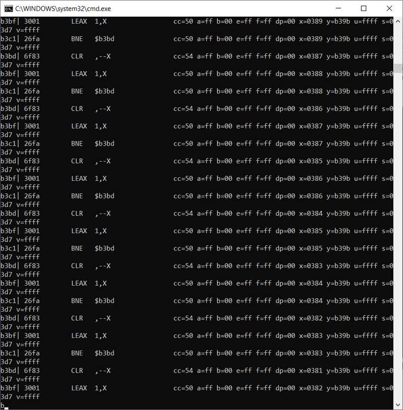

starting xroar on Windows with -trace parameter implies a very big lost of speed, not to say that it enters an almost endless loop. See image

Posts: 1471
I've seen that testing under Windows - anything that puts out a lot of standard io slows to a crawl...
You might still be able to use traps to only trace writes to interesting areas of memory, e.g.:
xroar -trap write=0x0400-0x05ff -trap-trace-n 1
Would emit every instruction that wrote to the text screen.
From GDB you might also get something useful by using "monitor trace 1" before setting a breakpoint and "c"ontinuing - you'll get trace output until the breakpoint (or watchpoint) is hit then you can "monitor trace 0" to turn it off again.
