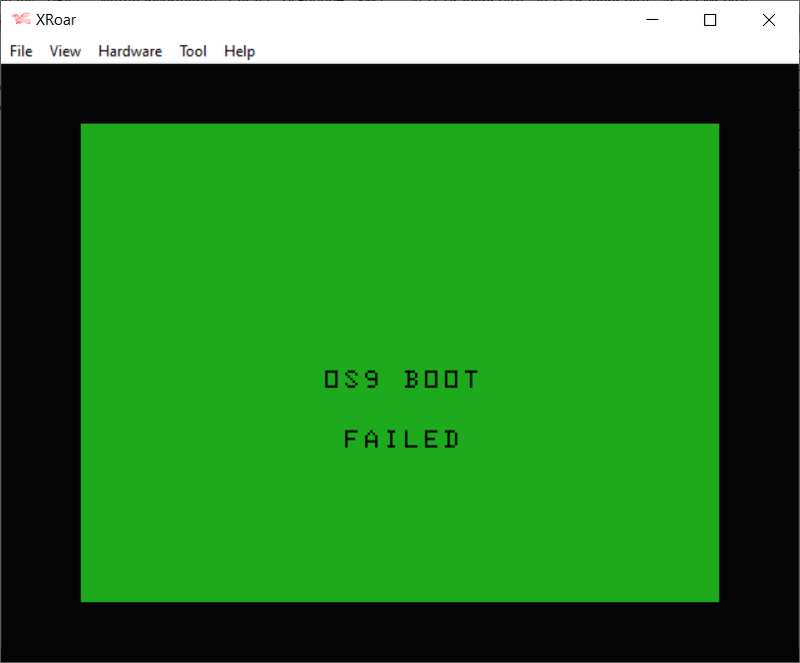

I just found another stupid error ...
I was loading BOOT6.BIN @$3430 instead of the correct place $2730. Something went wrong when I added the dragon header to the OS9 binary file
Once corrected, the program works for a while and then writes the word FAILED below the OS9 BOOT message
This happens because the call to OS9 F$BOOT returns with carry set because it did not work :-(
As there have been some changes, I am uploading the two disks: "F2 - OS9L2.dsk" to be put into drive 1 and "F1 - starter.VDK" to go into drive 2
To test it you just have to issue:
RUN"2:CSSW52"
When it waits for a user input just press enter, then the basic will stop
At this point you should add some breakpoint(s) to GDB or your debugger, I use to add hbreak *0xf5ce that stops just before calling
a OS9 system function and then ... happy debugging!
