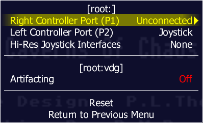

ok just done a little testing.
MESS158
COCO2 - Left and Right Joystick movement and Buttons work ok with 2 player Monkey King.
DRAGON32 - Has no Analogue option to configure. So no joystick control at all - nothing.
key "8" still acts as LEFT fire button, starting game.
MAME197
COCO2 - Right Joystick - has no control moving LEFT. Up, Down, Right, Fire. are ok.
Left Joystick - all good.
DRAGON32
LEFT controler - movement ok, no FIRE button. key "8" still works as FIRE in emulated keyboard mode.
so maybe????
COCO2 and Dragon32 joystick code is ever so slightly different (typo).
Xroar Joystick LEFT control is working for me.
so you could check that source code and compare for any obvious control differences. :idea:

just done further testing.
recompiled MAME 202 with just Dragon and COCO2 machines.
***removed Joysticks from USB ports in PC.
enable 2 joysticks in MAME config.
remap keys for left analogue joystick (W,S,A,D,\).
control works with both machines in left and right ports (using keyboard to control).
the default joystick key settings for Dragon Right & Left ports both use NUMPAD 8 for Up.
however "8" also acts as the fire button in a LEFT port game.
so that is a conflict.
and "7" also acts as fire button in RIGHT port games (not a problem in most games).
With COCO2 same setup.
There is no conflict with numpad 8. 7 or 8 do not act as fire buttons.
in Analogue control options, there is an extra setting that Dragon doesn't show enabled MOUSE X, MOUSE Y.
control works perfect using remapped or default keyboard.
going to test with alternate joystick ports enabled/disabled.
.mad.
Posts: 144
Location: Born in the North
Re: MAME Emulation
Post by .mad. »

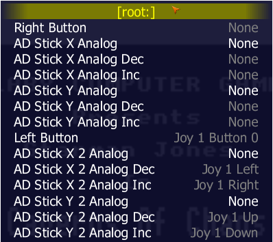

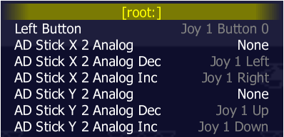

Finally solved!
Problem is the default keymap/joystick settings MAME uses.
even when the Joystick port is set to "Unconnected".
to enable FIRE in LEFT joystick.
you MUST enable RIGHT Joystick, and remap all controls to NONE.
This testing also found another problem.
SPACE seems to be disabled to start a keyboard game in Caverns of Chaos.
which does work in Xroar.

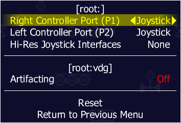

left working 1.PNG (20.28 KiB) Viewed 115393 times
left working 2.PNG (43.57 KiB) Viewed 115393 times
left not working 1.PNG (22.92 KiB) Viewed 115393 times
left not working 2.PNG (16.2 KiB) Viewed 115393 times

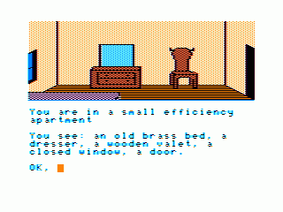

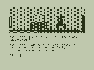

your sample pics look very nice.
but when i recompile the latest source code from GITHUB, the artifacting looks broken.
this is what i see now, and before...
maybe i did something wrong?
Posts: 1709
Re: MAME Emulation
That’s how it’s supposed to look like.
