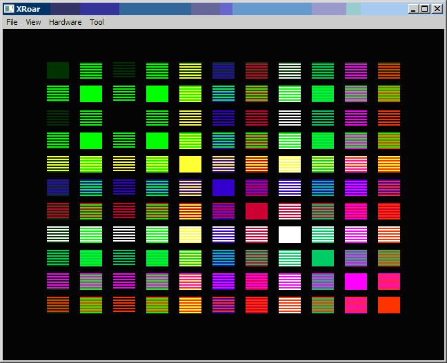

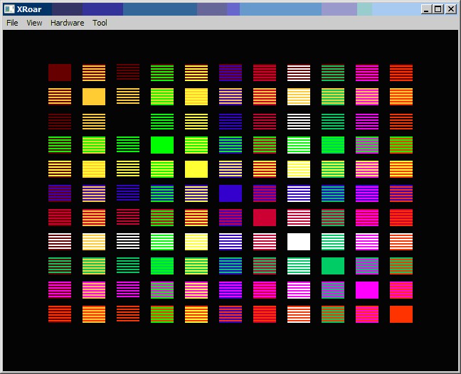

I made the first program to create these 121 combos on the screen, and despite the area for each combination not being very large,
you can see some colours blend to give a new colour, yet others don’t and simply show a stripped area.
I didn’t believe it until I saw the result on my Dragon screen!
These are the XRoar screenshots for both palettes.
01A-SG24-121blocks-Palette 1-XRoar.jpg (69.33 KiB) Viewed 17982 times
01B-SG24-121blocks-Palette 0-XRoar.jpg (69.09 KiB) Viewed 17982 times
Unfortunately XRoar emulates computer behaviour but not PAL behaviour … (the receiver end), so all stripped combos.

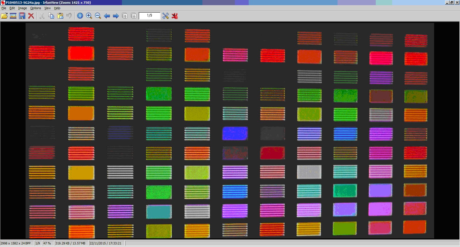

If we run this program on a real computer (CoCo2PAL – Dragon32-64) the result will be like this (bad) photo.

The answer is PAL behaviour.
NTSC creates artifacted colours ‘horizontally’ when a black pixel is next to a white one, creating a light blue or light red if we reverse black and white positions.
Instead, PAL creates ‘artifacts’ vertically due to a correction scheme that is automatically applied.

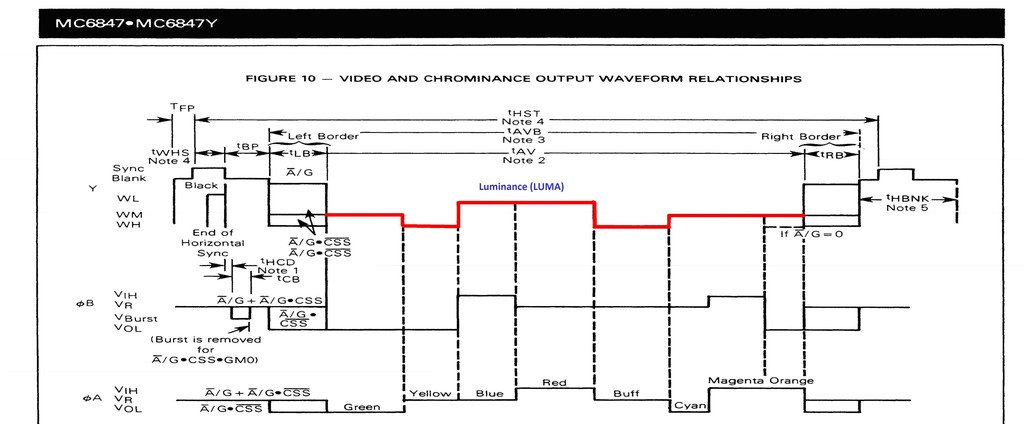

To unveil which colours are our ‘friends’ and will create new blended colours, we just have to look at this diagram from the technical datasheet of the VDG MC6847
We can see that there are some colours that share the same luminance (luma) value (red graph).
If we look at the colours of palette 0 (green, yellow, blue and red) we will see that only blue and red have the same luma value, so we could expect two new colours out of them; red over blue and blue over red.
Now let’s have a look at the colours of palette 1 (buff, cyan, magenta and orange). Here we see that cyan, magenta and orange share the same luma value, that’s great because it means that we could get 6 new colours: cyan over magenta, cyan over orange, magenta over orange and their inverses.
Finally we could look for colours that share the same luma value but are in different palette.
In this case we find yellow and buff that will create two new colours and then green with cyan, magenta and orange. This will result in six new colours: green over cyan, green over magenta, green over orange and their inverses.
To summarize this, we can say that in PMODE3 we can expect 6 colours in one palette and 10 in the other, and if we were able to switch of palette every horizontal scanline, then we could get 8 extra colours, so raising the total to 24 colours at the same time on the screen!

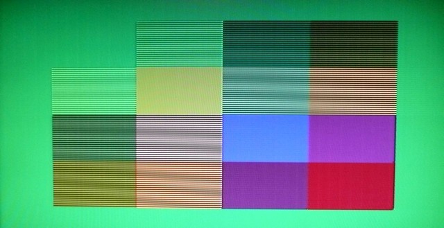

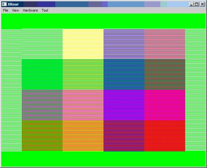

Next step was to apply this technique to PMODE3 to verify the results. The next two images show XRoar screens and a real Dragon using palette 0. You can see the two new combinations on the photo (red-blue combos at the lower right of the screen).
The photos do not capture the exact colours but gives you an idea of the principle. On the Dragon screen the two purples have different colour tones (darker – lighter).
Now the images using palette 1. In both XRoar and on a real Dragon. The photo you can see at the bottom right of the screen has NINE solid colours!, six of them are the blending result of two standard colours.
And this is a mix of both palettes, the borders show a switching of colour on every line. XRoar images only,
On the upper first CSS1 then CSS0 and on the lower first CSS0 then CSS1 (symmetric results here)
To see these images on your computer, you just have to use the basic programs “TSTBND10.BAS” and “TSTBND01.BAS” respectively, both contained in previous VDK file.
To end the demos you should have to press Reset.

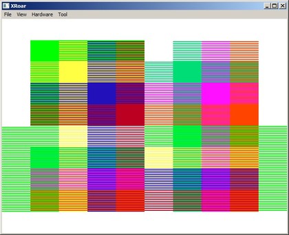

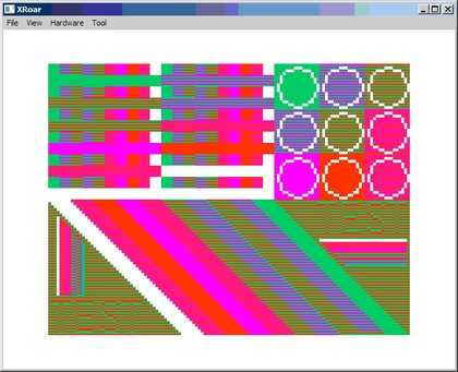

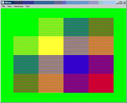

The next challenge was to show these four palette combinations on just one screen.
The result is shown in this XRoar screenshot and D64 photo
Upper left quadrant has combinations of colours of palette 0
Upper right quadrant has combinations of colours of palette 1
Bottom left has combinations of palette 1 and then palette 0
Bottom right has combinations of palette 0 and then palette 1
To test this image you can use the basic program “TST4Q.BAS” from the disk file “25B - 4 Quadrants v1.0.VDK”

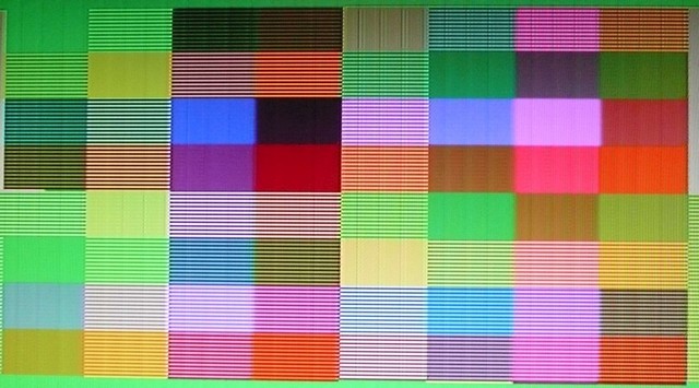

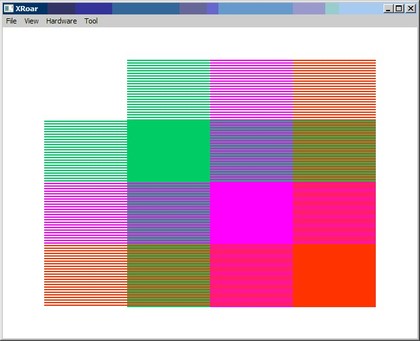

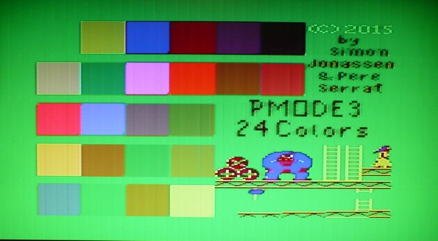

Now, despite the fact we can see the 24 solid colours we are able to obtain, we want to get rid of the combinations that don’t blend into a new colour,
so that we only have the good ones.
Here are the XRoar screenshot and a photo of the real D64, a very poor photo due to the moiré effect added by the camera, sorry.
08B-PM3-24Colors Photo-small.jpg (73.41 KiB) Viewed 17973 times
The mix of text, Donkey and the patterns to be blended were made by me.
To see that image you have to execute the program “TST24M.BAS” from the disk file named:
“25C - PMode3 with 24 colors x Dragons v1.3.VDK” for Dragon Users, or
“25C - PMode3 with 24 colors x CoCo v1.3.DSK” for CoCo2 PAL users
Clearly the switching of palettes on a scanline basis is only useful for still images, not for moving elements (games).
For still images we have to create a converter to map the 24 colours from the original image to the 24 we can obtain with the methods used in previous images.
But for games we only have to use one palette, and if palette 1 is adequate then we could use up to 10 colours, not that bad, don’t you think so?
The problem here with mixing the PMode3 fixed image and text, both palette 0 with the rows of combos that have different palettes is that you have to synchronize your code with the horizontal frequency (each line sets an irq flag) as well as each frame.
Simon and I have spent numerous hours discussing timing and the concepts involved in pulling this off.
The first row of combos is palette 0 only, so no changes need to be done.
Second row is palette 1 and shows six combos, so we have to change to palette 0 exactly after the sixth ‘new’ colour.
Third row is also palette 1 but shows only four combinations, so the change to palette 0 has to be made exactly in the middle of the line.
Finally fourth and fifth rows have alternated palette every line but just until the centre, then palette 0 must be set for both even and odd lines.
This implies accurately cycle counting when coding, adding the needed dummy opcodes to ensure that changes happen in the right moment.

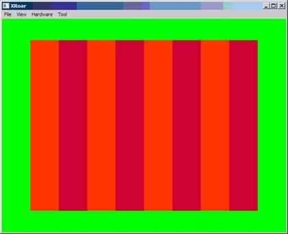

Let’s imagine we want 8 vertical bars equal width, so 4 bytes each, then we should hit these
cycle numbers: 14, 18, 22, 26, 30, 34, 38 and 42 corresponding to bytes 1,5,9,13,17,21,25,29 on the line
Let’s write a small assembly routine that does exactly that:
Assuming we have loaded previously register D with values $e8e0 for CSS1 and CSS0 and DP=$FF
hloop	nop			; (02)(02)
	exg	a,a		; (08)(10)
	sta	<$22		; (04)(14)	CSS=1
	stb	<$22		; (04)(18)	CSS=0
	sta	<$22		; (04)(22)	CSS=1
	stb	<$22		; (04)(26)	CSS=0
	sta	<$22		; (04)(30)	CSS=1
	stb	<$22		; (04)(34)	CSS=0
	sta	<$22		; (04)(38)	CSS=1
	stb	<$22		; (04)(42)	CSS=0
	tfr	a,a		; (06)(48)
	tfr	a,a		; (06)(54)
	bra	hloop		; (03)(57)
The first number in parenthesis is the number of cycles used by that opcode, the second is the accumulated cycle count along the routine.
You see that every ‘st’ opcode to $ff22 is exactly on the cycle count pre-calculated.
This would show that image:

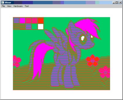

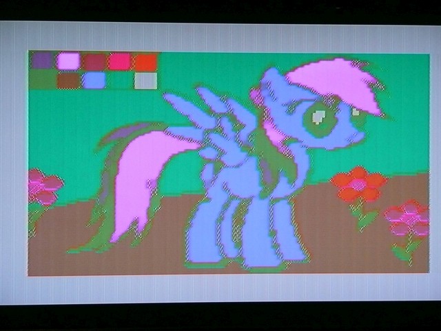

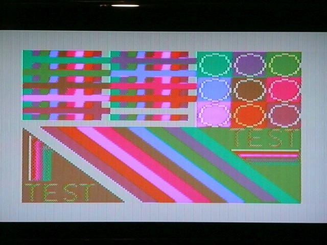

Here are two images, a ‘pony’ and a ‘testcard’, that will allow the user to modify the colour settings on the TV set so that the 10 colours are clearly visible.
Both XRoar screenshots and photos of real hardware are shown.
The images were designed by Hugo Dufort in format .PNG and later converted by Simon to CoCo/Dragon images with his own converters.
The camera has captured the colours its way, sadly the result is worse than the image shown on the real hardware.
Anyway the pictures give an idea and are a proof of the concept. Using PMODE3 in palette 1 you can get up to ten different solid colours at the same time on the screen.
You can see these images on your computer running the program “SEEIMGS.BAS” included in last VDK.
It is in both versions, Dragon and CoCo disks.
These works have been made just to show Dragon/CoCo users that have a PAL device, that many more colours could be used using colour graphic modes

Posts: 1486
Re: Searching for more Colours
Another game that uses this technique in SG24 is PSE's Tetris (Ola Eldoy) (it's in the archive).
You mentioned Donut Dilemma already: note that, like NTSC games, it needs to determine which phase the VDG fired up in - it does make a difference! The light blue Marentes uses by mixing in CG6,CSS1 comes out differently depending on phase.
Posts: 1903
Hi Sixxie,
that's right.
We wrote that when you are using two colours to create a surface, you could end up with one of two different 'new' colours
depending upon which colour comes in the even lines. PAL corrects phase errors every two lines, so order is crucial.
In the 'demo' programs we made both mixes, filling pairs of lines with the blending colours in order to show the two new
ones that could be created.
So in CSS0, the simplest one, you can see two different pink results blending red and blue.
