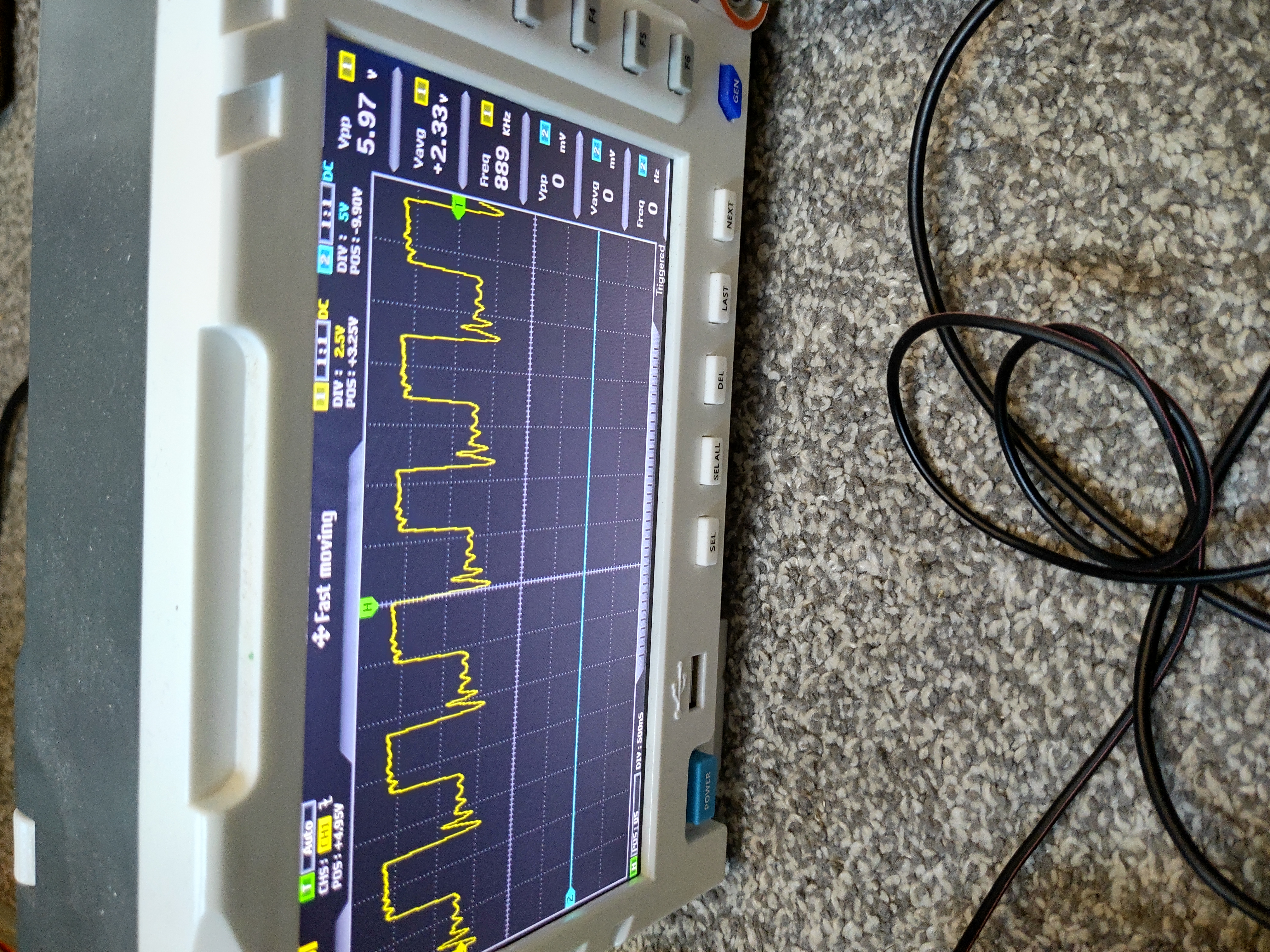

6. 6847P - I have checked the DA01-08 lines with my scope and receive a nice square wave of different frequencies.

Pin 35 of the CPU:
Pin 34 of the CPU:
