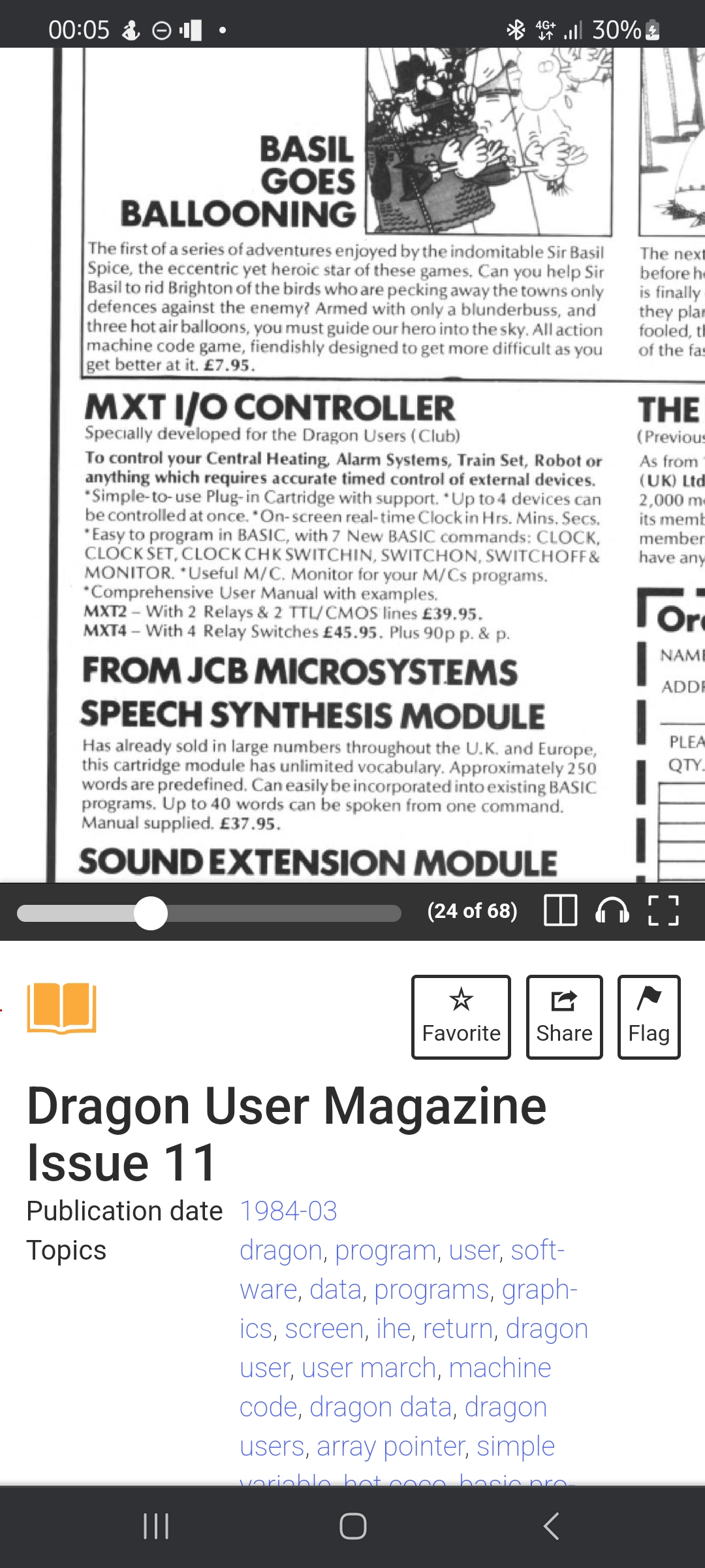

There's an advert for it in Dragon User, issue 11 - page 24.
Seems to be a real time controller for heating, model railways, all sorts of things. Several versions available, with progressively more relays.

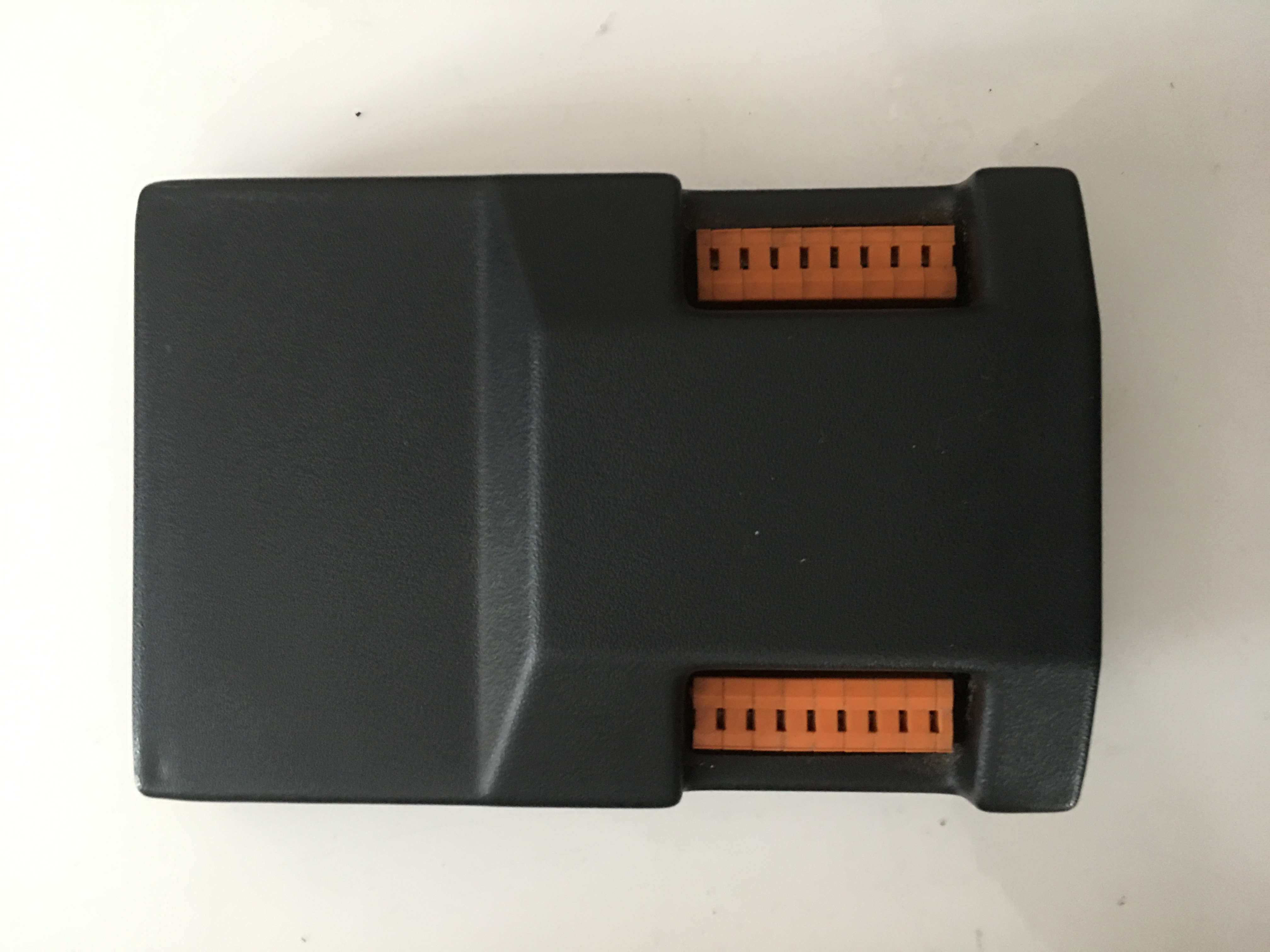

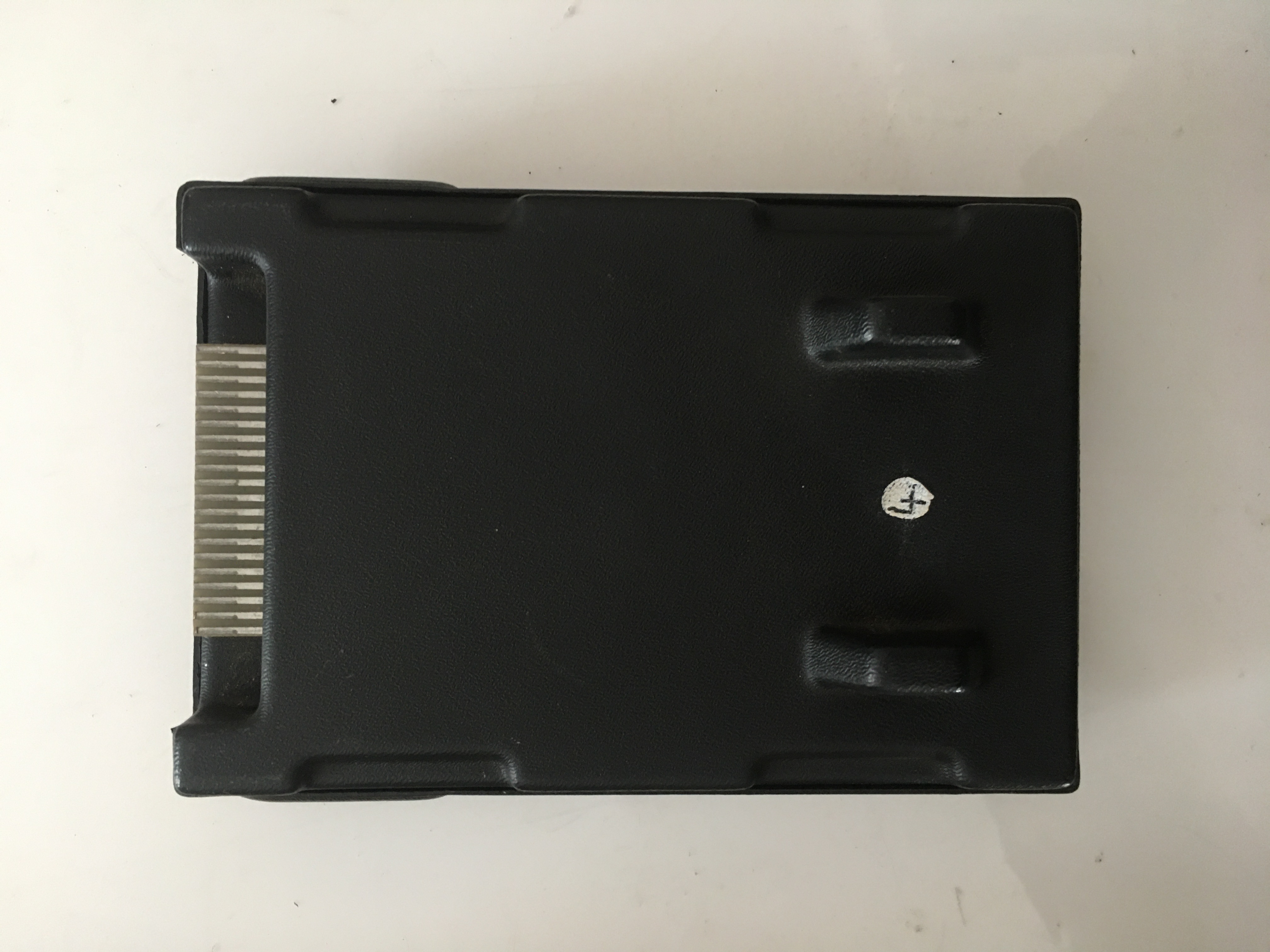

Photos added but I cannot open the case, it seems to be glued together and I am scared of damaging the case by forcing it.

The Dragon User Magazine, page 12 April 1986 shows a bit about it along with a short program listing. I'm still hoping someone out there can shed more light on a user manual.

Thanks for the pictures!
I'm wondering if you can record the sound output of your Dragon on a PC. If that's the case, we could dump the rom without having to open the cartridge. I'll take care of extracting the rom data from your wav recording.
