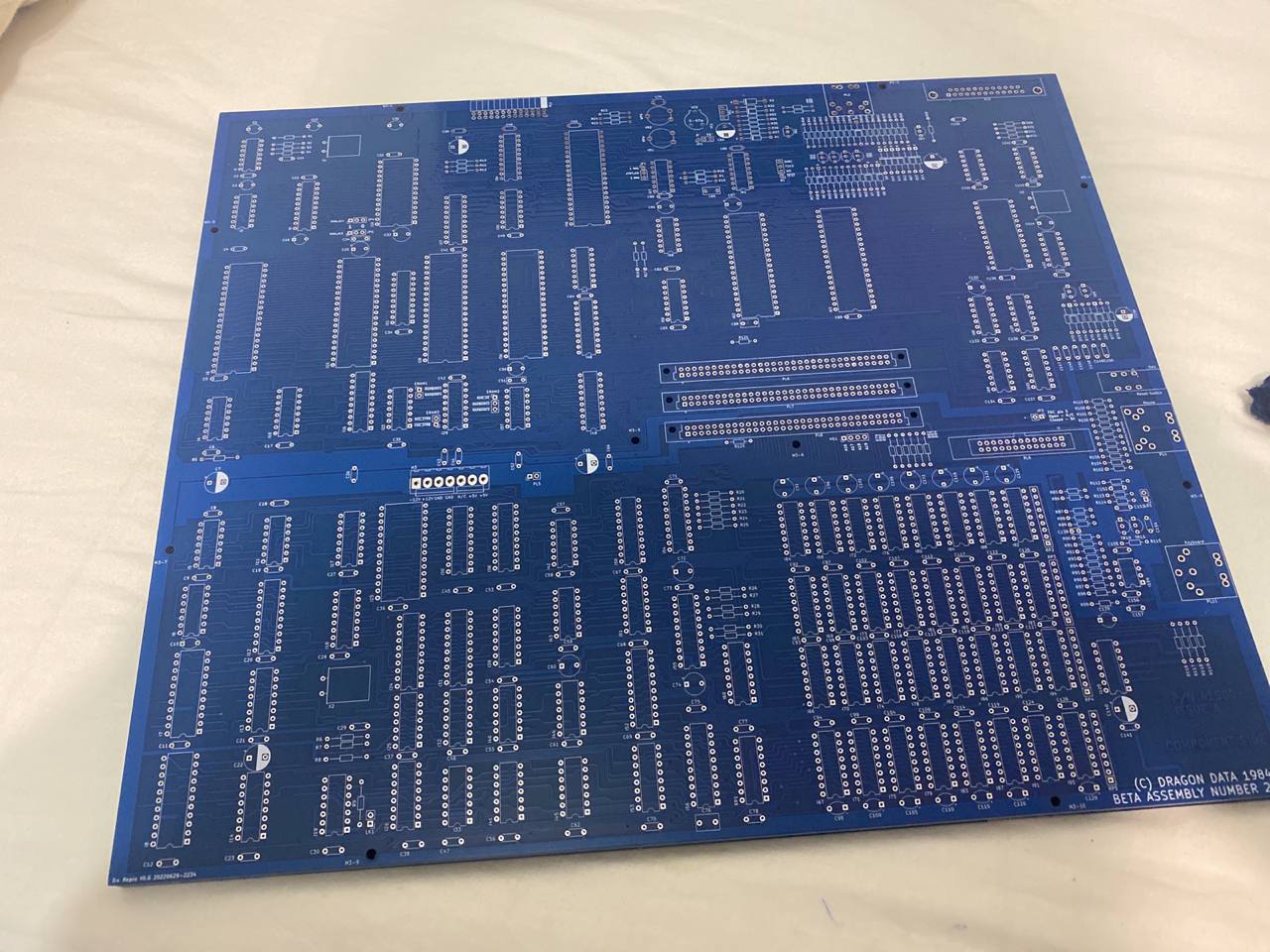

My, my! Isn't that a pretty Beta board?
- Robcfg_Beta_Board.jpg (470.61 KiB) Viewed 87135 times
