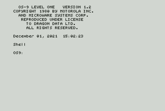

Hi all,
Documentation dump on the Real Time Clock stuff I had at the Dragon meet.
The attached zip file contains:
* An overview RTC.pdf document
* KiCad schematic pdf and a board gerbers zipfile
* The DS1315 data sheet
* Assembly language source for the RTC.BIN get/set routines (callable from Dragon BASIC).
* Assembly language source for the getrtc OS9 command
* A DragonDOS 40 track single sided headerless DSK image with the Basic and machine code access routines
* An OS9 40 track single sided headerless .os9 image with the getrtc command, source, plus the nulldr and null device driver and descriptor
D64DS1315RTC.zip
(956.12 KiB) Downloaded 728 times
I still have one complete board, and a few PCBS but am out of DS1315s, and they are getting more difficult to find at sane prices. If anyone wants the last assembled board, let me know, or if there are a few people who are interested, I'll try and get the parts to make more. A saner option may be to redesign with the SOP version of the part which seems to still be relatively low cost.
Kind regards,
Mike
