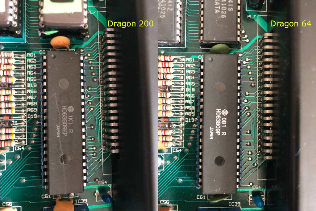

I'd like to ask about the difference between 6809/6309 and 6809E/6309E processors.
It looks like the standard and E versions have a set of pins with different functions, and the direction of the E and Q pins seem to be reversed.
I upgraded my D200 with a 6309EP, and on the other hand my D64 is running smoothly with a 6309P, and I'm not sure if it can be a problem or not.

I know that, but my question is more if standard and E versions are interchangeable, and if they are not how come that I have a D64 with a standard 6309 working well.

In general the internal/external clock versions are not interchangeable so I am amazed it works at all. As you say, there are a number of pin differences but the ones that matter in the Dragon are the E and Q directions.
So in your D64 you have both SAM and CPU trying to drive the E and Q clocks i.e. not a healthy situation. My guess is that the SAM is driving much more strongly than the CPU. There's even a chance the drivers fried in the CPU shortly after power up, allowing SAM to drive the clocks. Either way, this is not something I would try myself.

I'll look to get a proper 6309E in order to avoid damaging anything else.
The surprising bit is that it works as if it were a completely compatible replacement.

Where did you source the CPU? Those Chinese sellers are not shy of relabeling...
Re: 6809/6809E compatibility
Posted: Sat Aug 14, 2021 1:31 pm
by dublevay
That will definitely just be a relabelled processor. Most likely a 6809E. I'm more used to getting 6809s relabelled as 6309E chips. Basically the places doing the relabelling just don't appreciate the difference between the chips.
