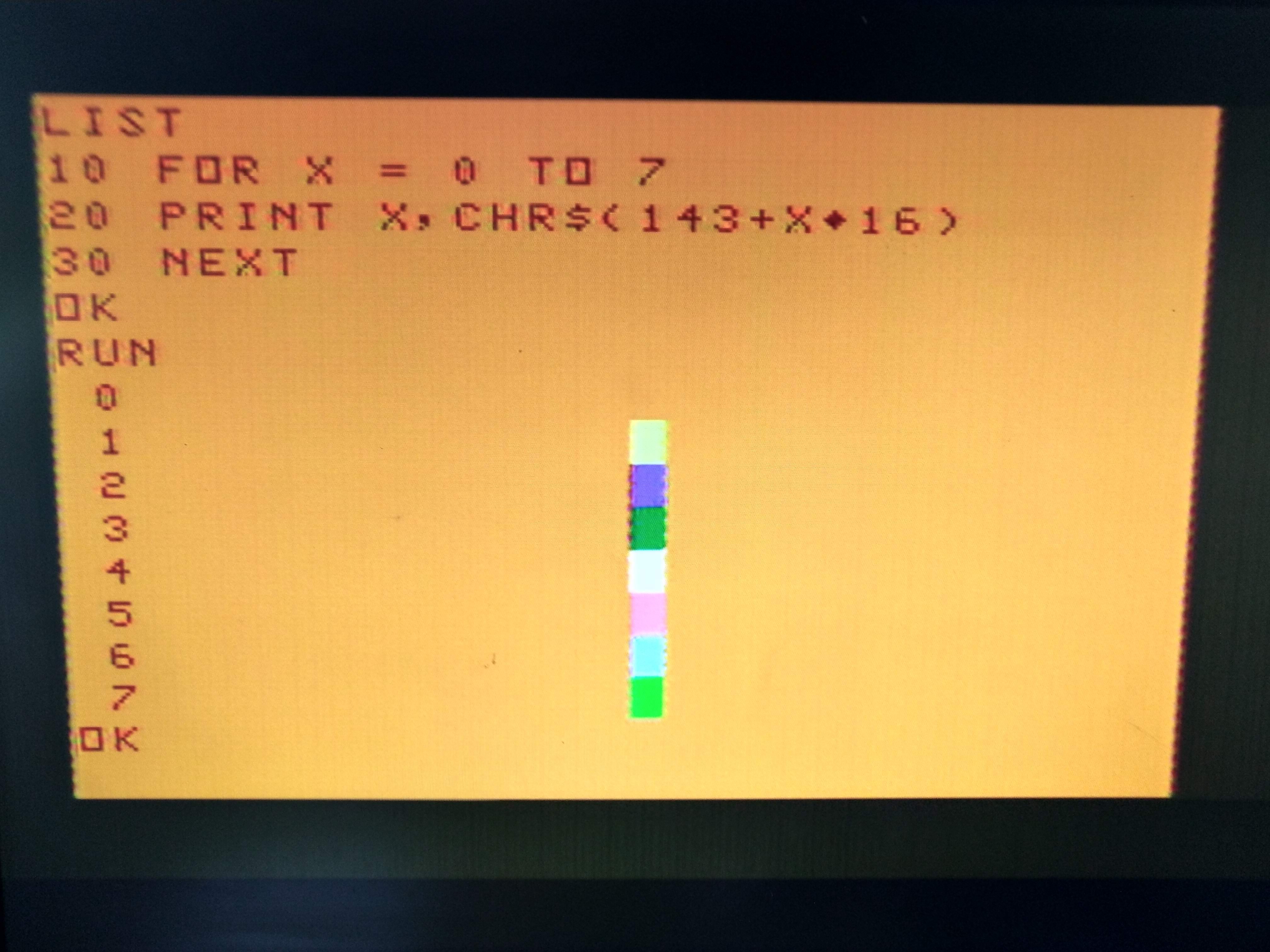

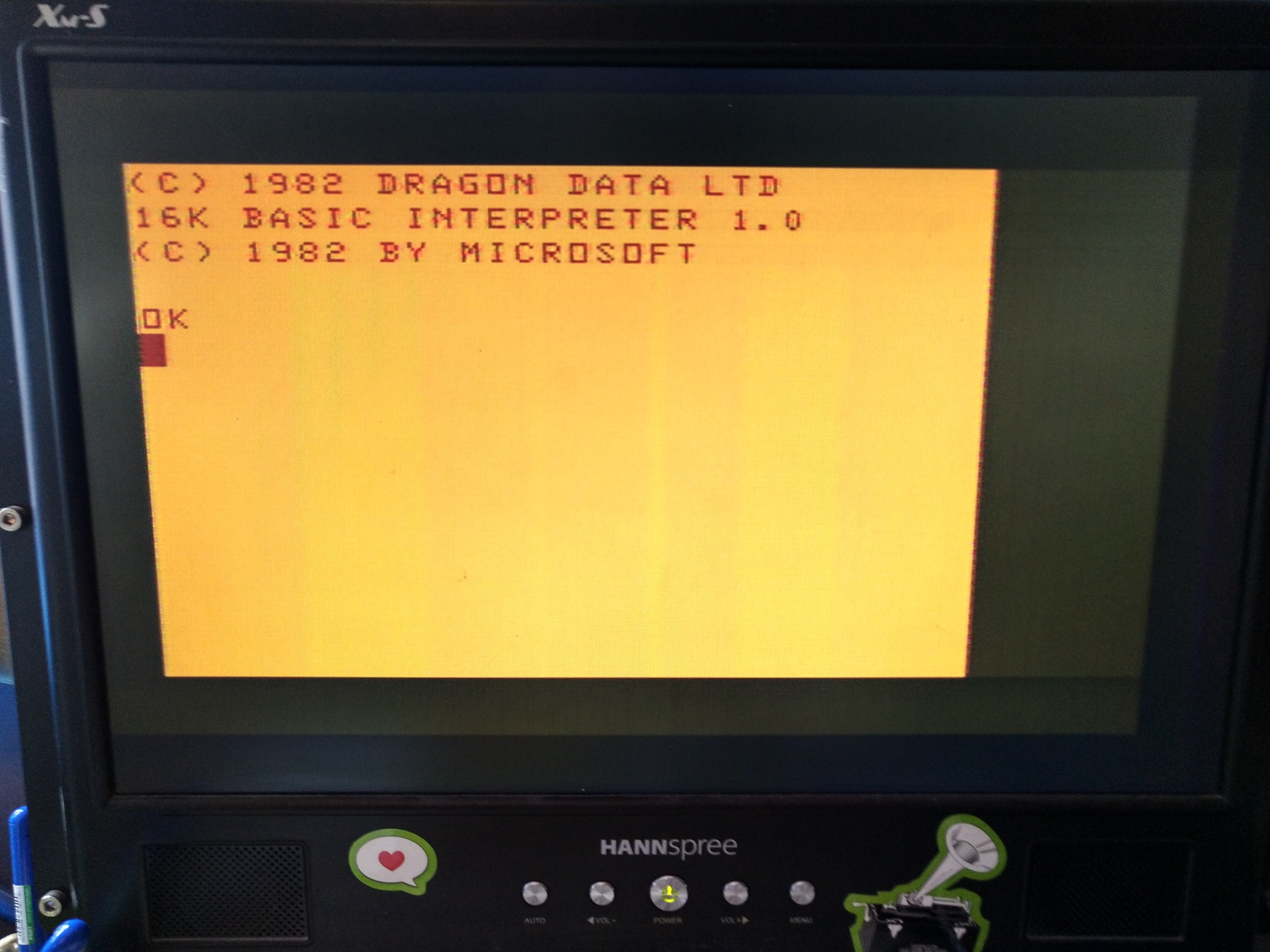

Leaving it sat, powered off on the bench for a bit has got it to life again! Pictures attached. The fuzziness is the composite to HDMI adapter I'm using I think, though I'm getting occasional flickers I don't get with other input devices. The attached images show the screen on power up and a quick bit of code I hacked out to get the colour palette on screen. This definitely looks off and I wonder if this issue is downstream of the VDG.

One further development, holding reset for a few seconds then releasing has got it to show as normal for at least a little while, before flockering and jumping back to 'orange'.
Posts: 1458
Re: Dragon 32 jumping to buff mode spontaneously?
Having experimented a bit, I can't replicate by tying øA, øB or CHB to various values. While it looks like it's in the other colour set (CSS=1), if it is, that's not the whole story: even in that set, the block by 0 should remain green.
Maybe check around the LM1889? (Possibly IC9, can't really read the schematic).
