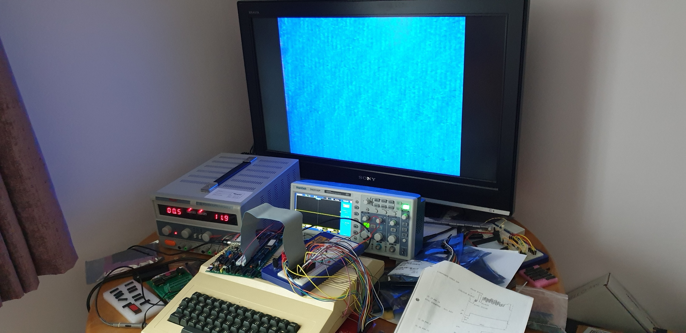

Posts: 197
Re: Premier's Sprite Graphics Board
Made some progress on this tonight. It seems that by replicating a patch on the prototype board by breaking the link between L & M, and then connecting L to D, the ROM mirrors between &HC000 and &HE000. However, replicating the EPROM mod doesn't seem to work correctly. On the proto board, X & Y are connected, whereas on the green board, Y & Z are hard linked. X is actually A12 from the cartridge port, whilst Z is ground, and Y is A12 from the EPROM. However, connecting X & Y results in the EPROM code disappearing from &HE002!!
I have some new ICs coming tomorrow. Although I can test a lot of them using the MiniPro, some cannot be tested, like the 7425 or the 4066 - so I figured some new ones would be better.
Posts: 197
It's teasing now. Not sure if my new components have fixed it, but I have discovered that the 12V supply has to be pretty accurately between 11.9v and 12v.
Still need to work out how it's supposed to be reading the top half of that EPROM!
