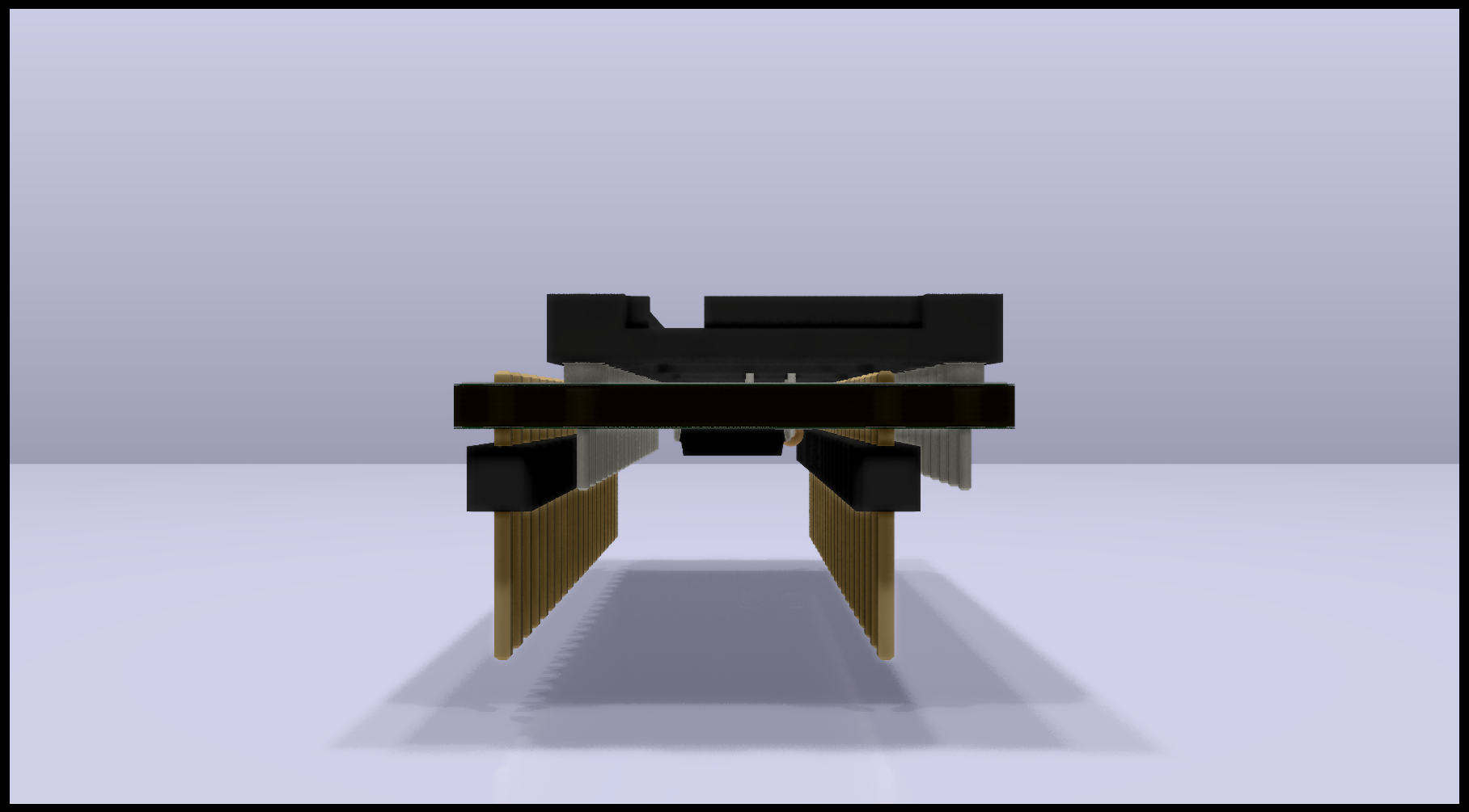

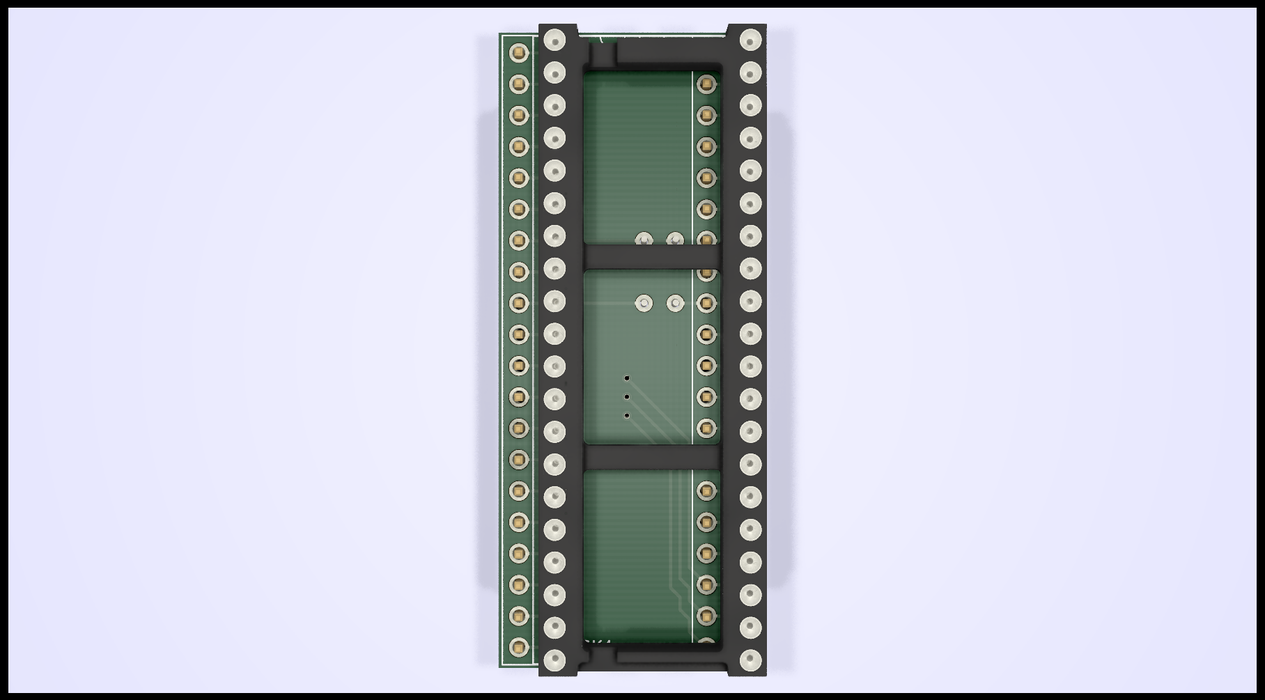

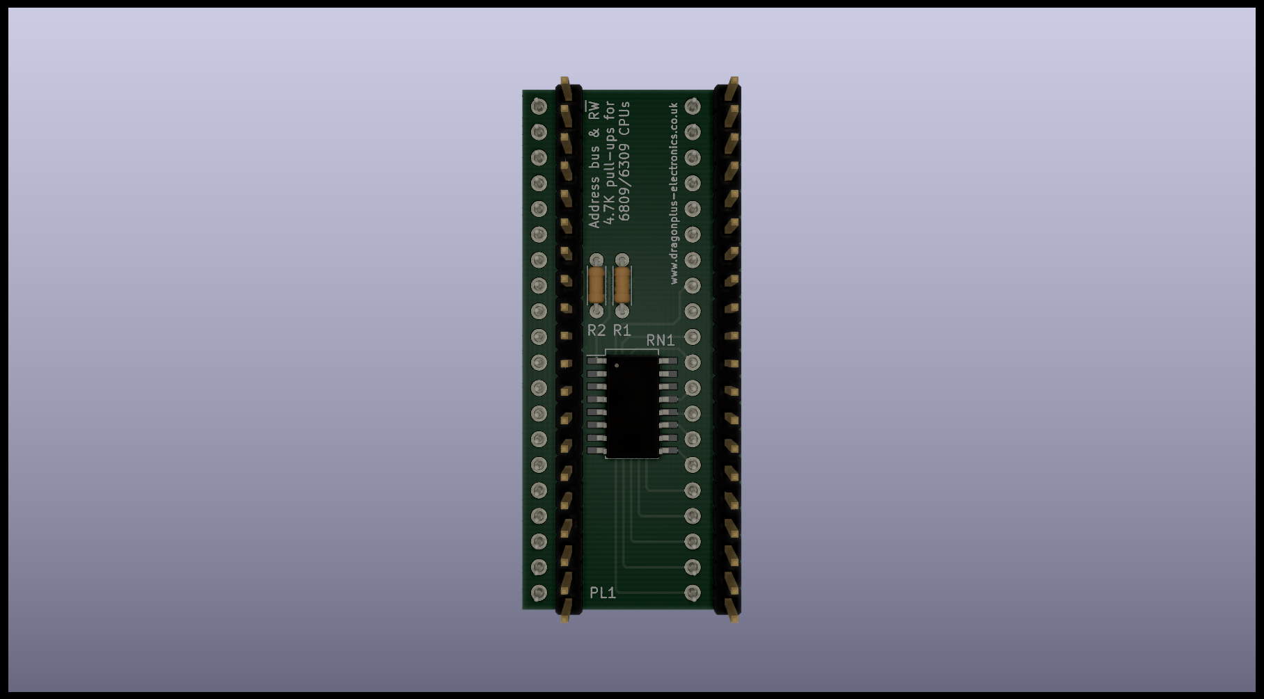

At bluearcus' suggestion (well, I think that's him) I have now put together a somewhat neater pull-up solution which would mean that the Oojamaflip would still work with the DMSX2+ and CocoSDC as is without needing additional pull-ups. It's a 6809/6309 adapter with the address and R/W pull-ups incorporated - and it comes in just slightly wider than the 6809 footprint itself.
This would improve the SYNC situation on stock D32s, D64s, D200s and Tano 64s, as well as (I believe) Coco 1s and 2s. I am not sure if it would be compatible with the Tandy MPI though, as do not know if that also has the pull-ups - or just pure buffering. I know that a special MPI was launched for the Coco 3. I do not know if there are yet any other real-world Dragon examples where this is needed, apart from the DMSX2+ and the CocoSDC.
Anyway, here it is...I will order a small quantity of these boards soon.
