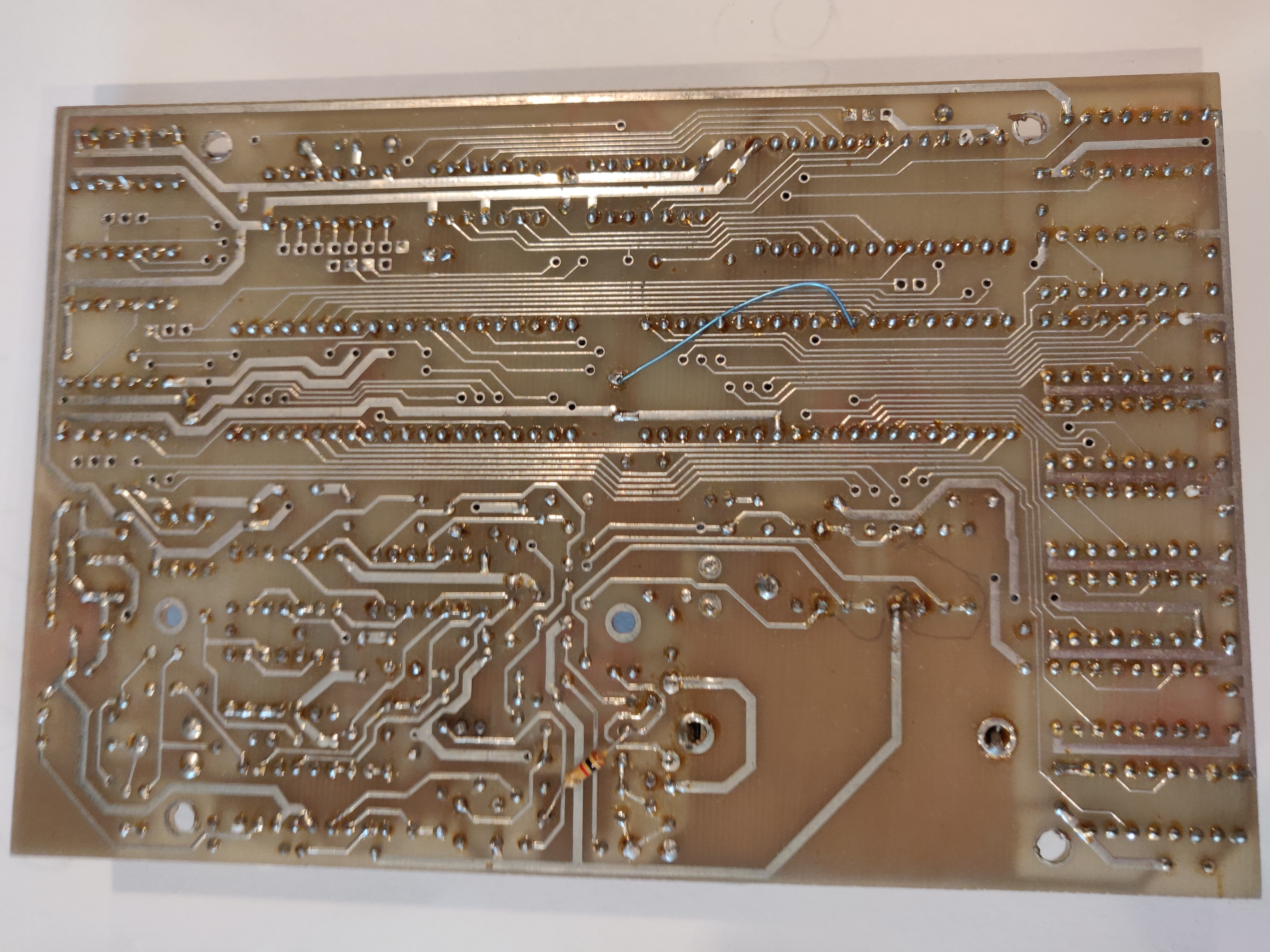

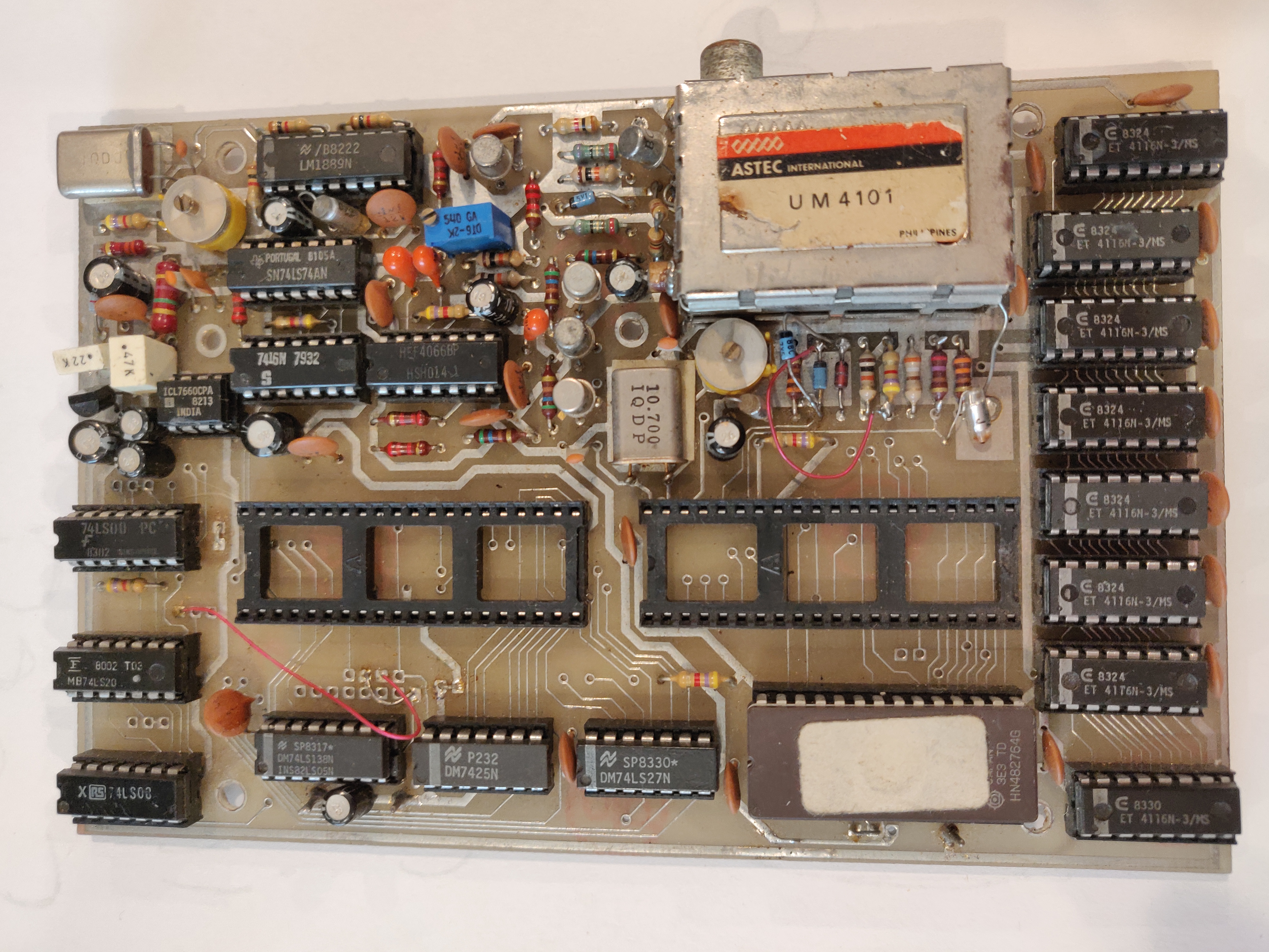

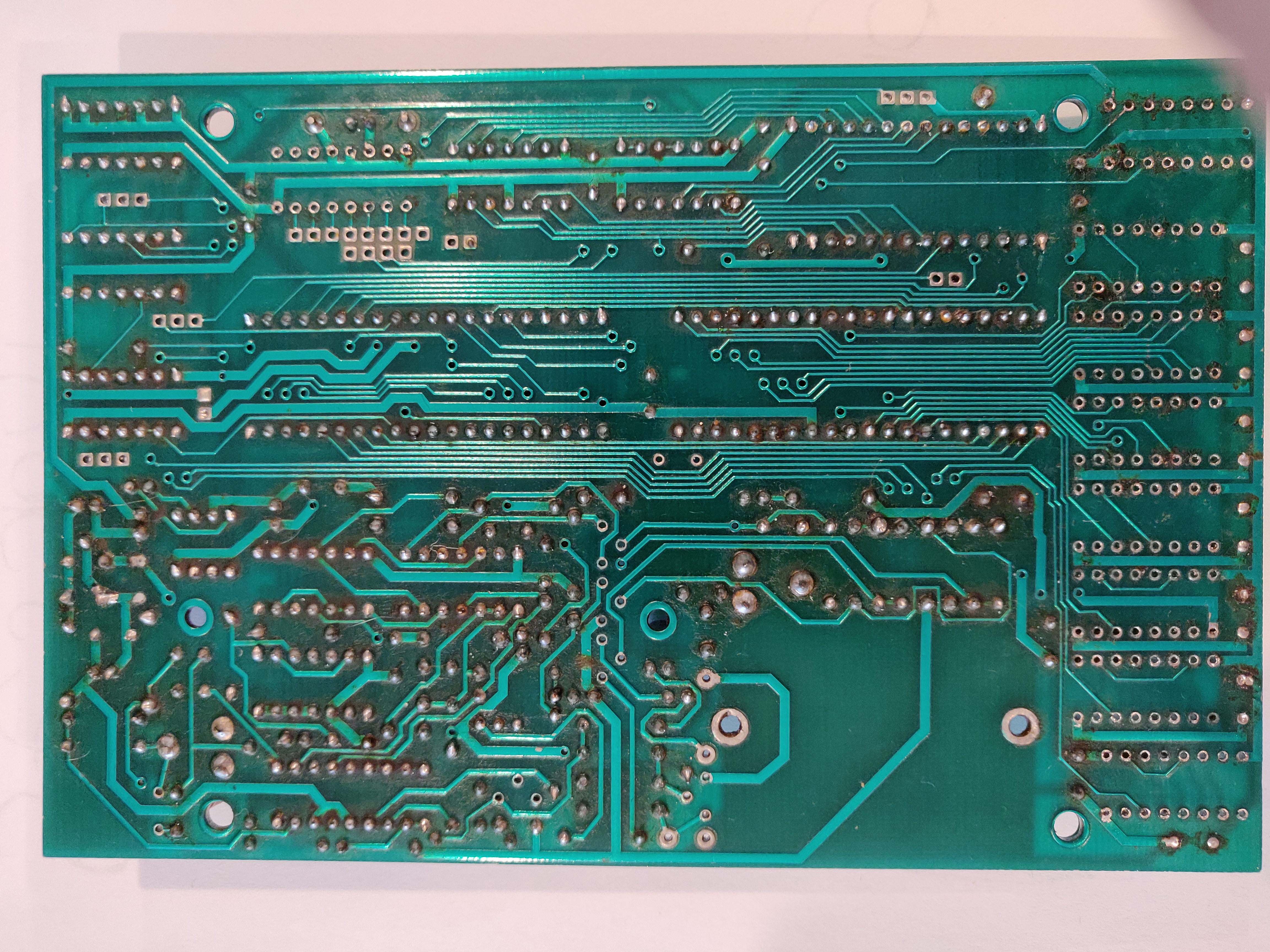

It would be very nice to have better pictures of both boards, on both sides.
I can take care of processing them for the wiki.
Thanks a lot!

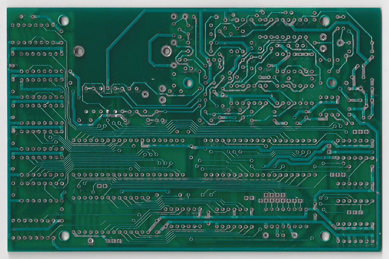

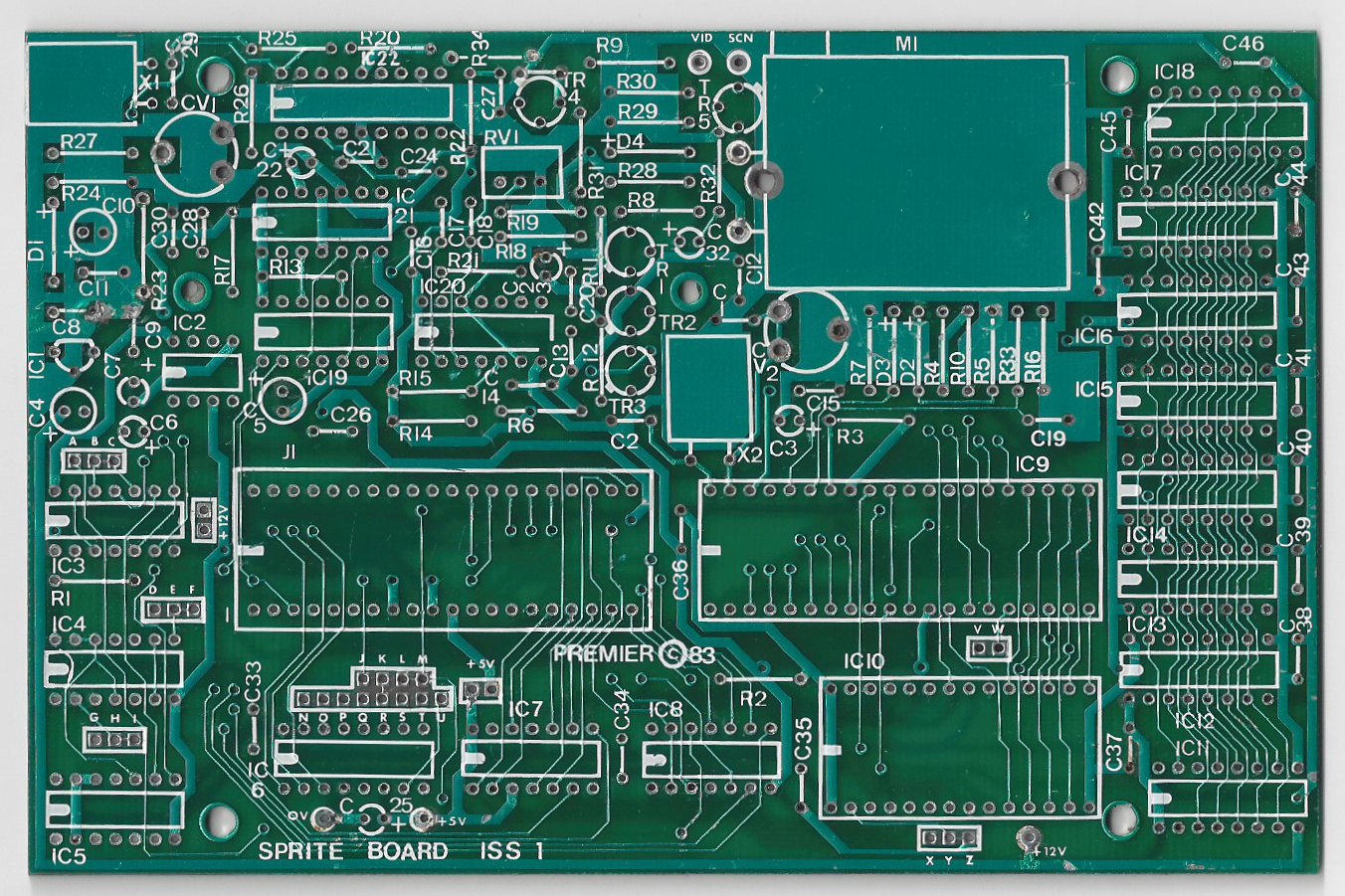

Think I've mapped about as much as I can of this board. Can't see enough of the tracks below those discrete logic IC holders to get much further.
For a remake, would simplify by using 4164s, getting rid of the need for -5V and 12V, and much of the circuitry in the middle left. Also thinking that much of the display circuitry could probably be replaced with something much more modern.

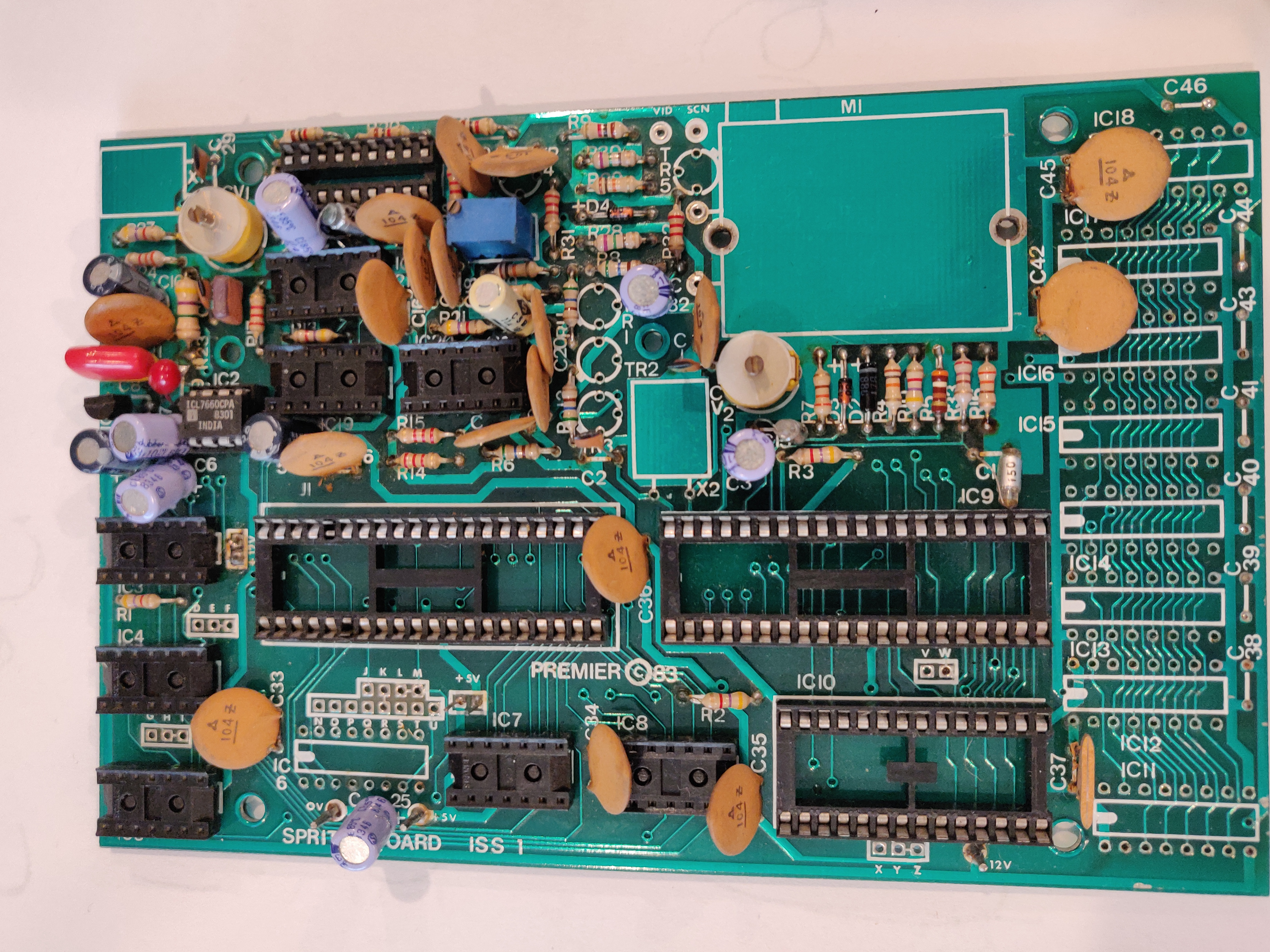

I've spent a couple of evenings on these boards so far. Have been through a few iterations of trying to get it to work - of thinking that not only was the -5V generated on the board, but the +12V was too. But it isn't. Anyway - I now have a bench supply generating the necessary 12V, but still no joy. I can tune into a blank picture, but nothing else yet.
I did find another online review of the board in PCN - courtesy of a handwritten note on the scanned Sprite documents. https://ia800808.us.archive.org/13/item ... pr1984.pdf
There are differences between the prototype board and the green board that was reviewed in PCN - notably around the discrete components below the modulator. I'll keep chipping away at this in the background. One job for very soon is to completely desolder the green board. It's a bit of a mess, could do with cleaning up, and it would be so good to see underneath those awful IC sockets! :)

If you desolder the whole green board, please take the chance of scanning both sides of it or otherwise take nice pictures of it for the wiki page.

All done. A good night's work with no track lifts! Now I can (when I get a moment), work on mapping out the complete schematic.

OK guys, I have a potentially stupid question.
I've rebuilt the green Sprite board, but it's not running properly yet. It's supposed to be an EXEC &HE002 to get it to run, but this doesn't work for me. I can read the EPROM from the board via the cartridge port, but it seems to start at &HC000. The Sprite ROM is 8K, which I think means it will finish at &HDFFF.
So I either have a decoder issue, a connection issue, or something unexpected (to me) is happening.
My question is does the EXEC &HE002 directly execute the same &HE002 as I can PEEK from BASIC (which is just full of 0x7E), or does some strange decoding happen which makes the EXEC command somehow get routed to the &HC000 location?
