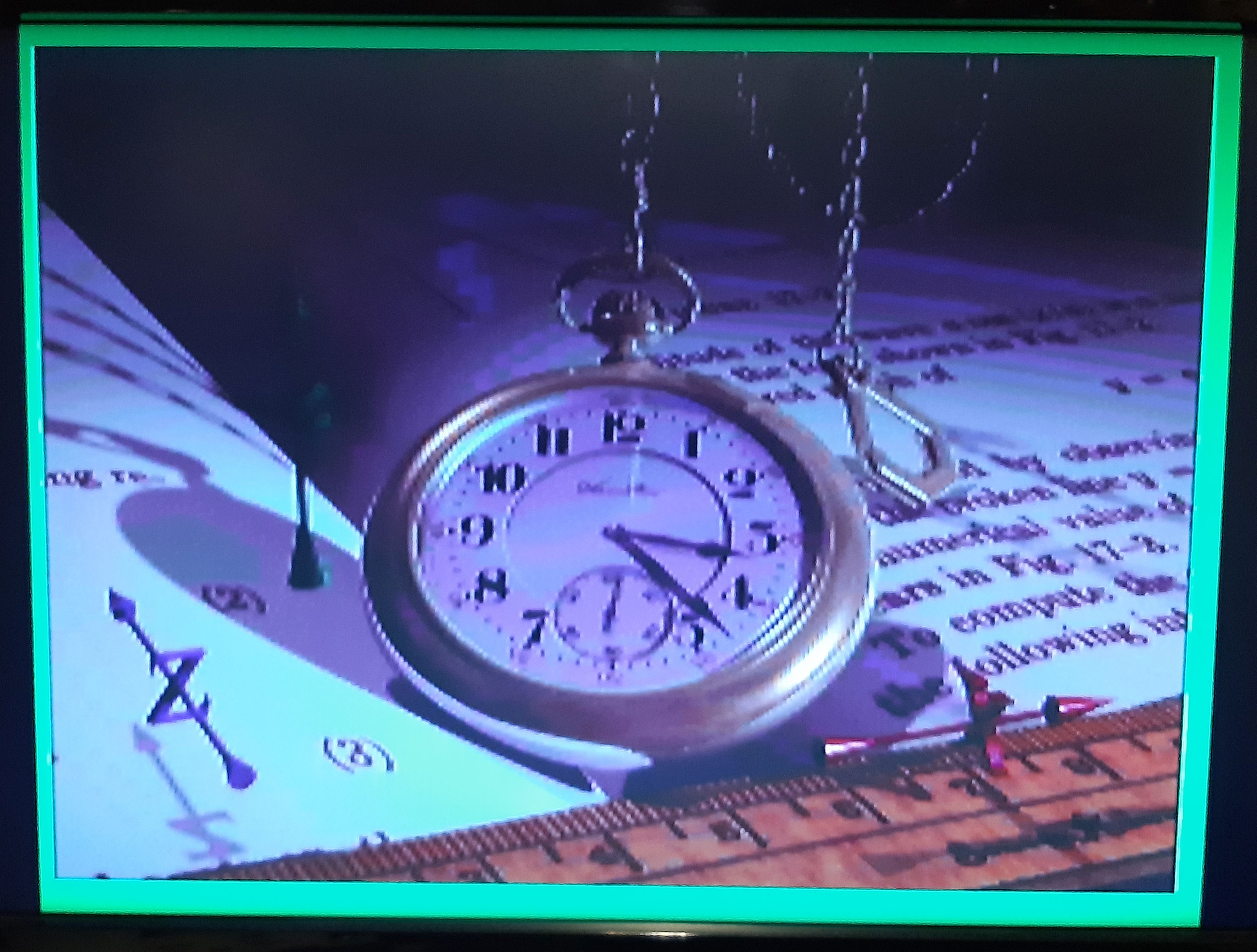

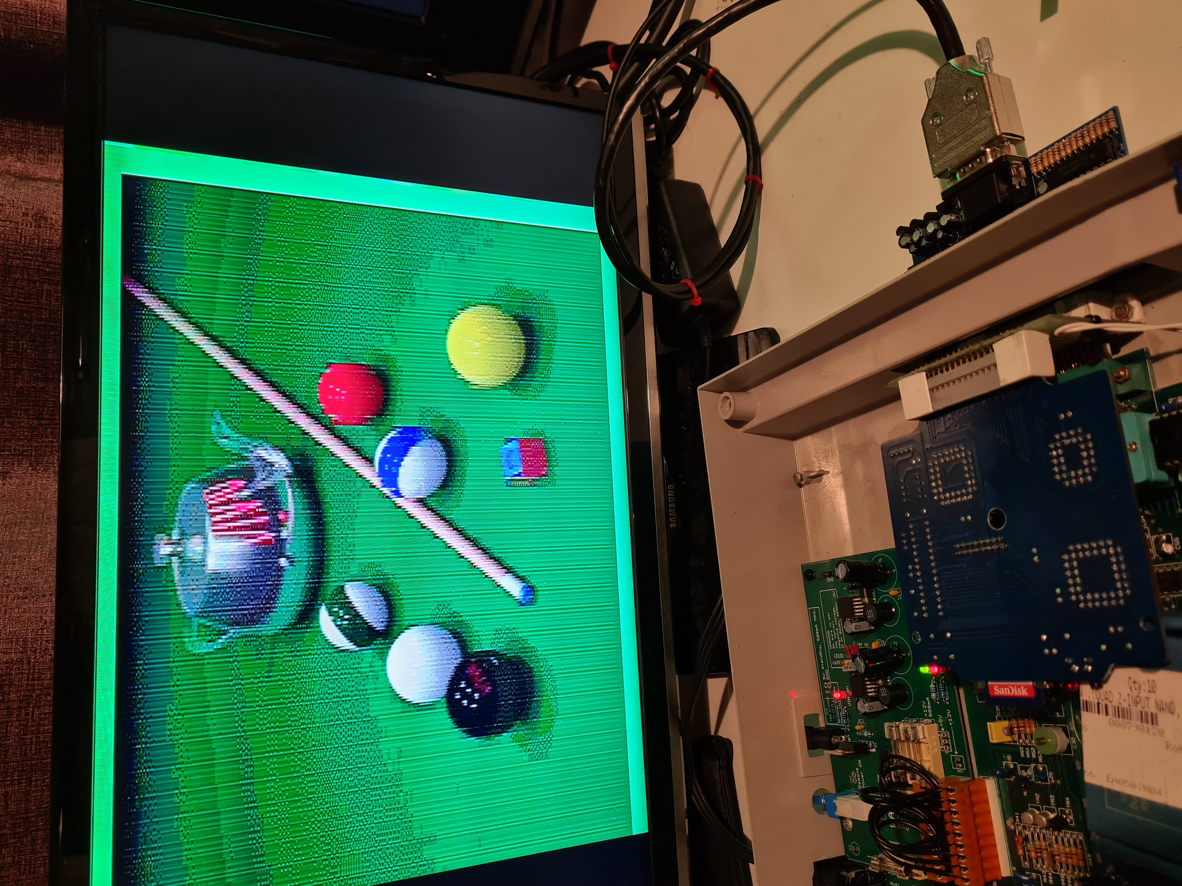

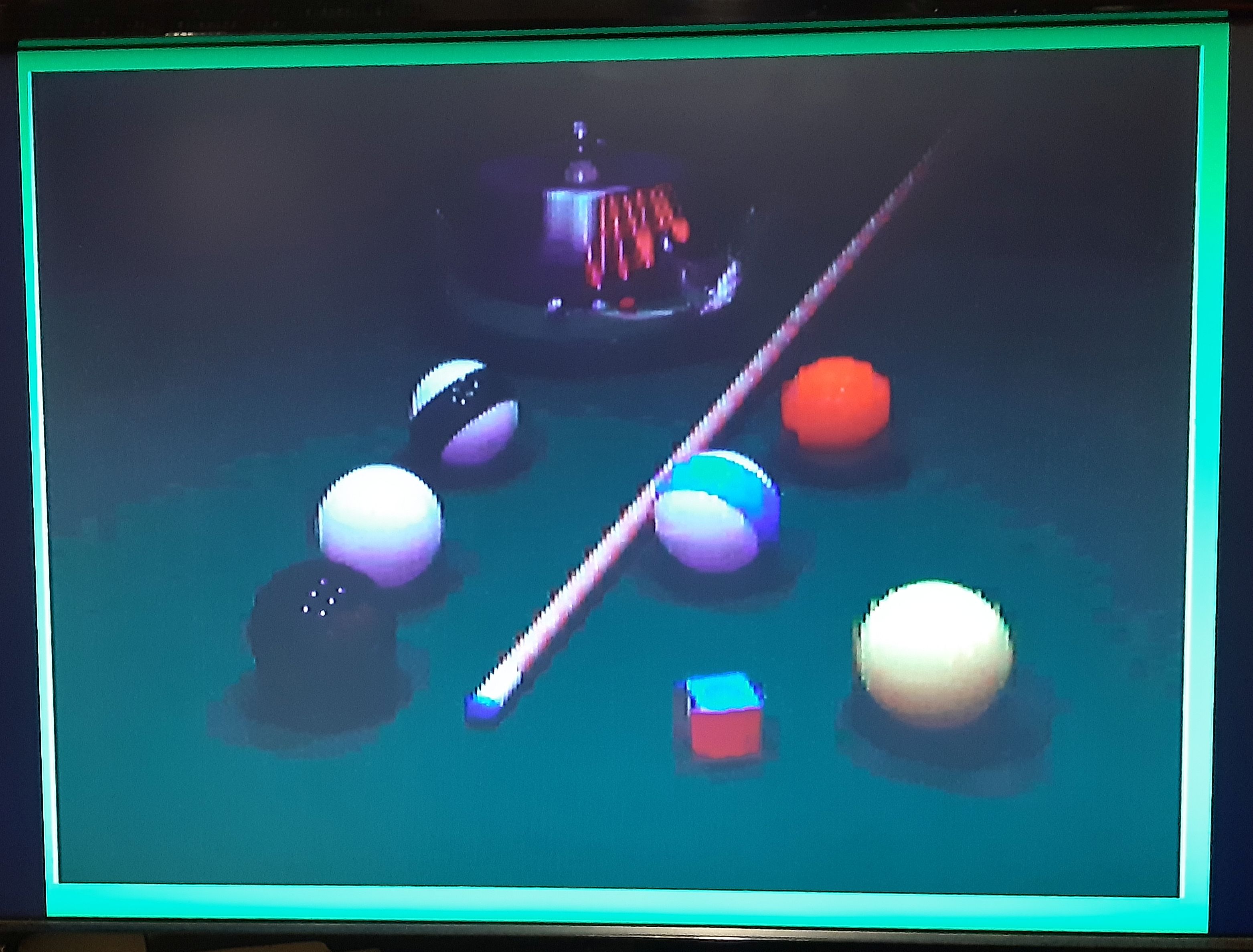

I can't resist showing off the difference in image quality between the WordPak 2+ and the DMSX2+!!
I think the WP2+ unfortunately suffers from VRAM interference, hence the jail bars.

Re: Problems with DOS using an Y-type connection
Hello John,
this is strange, I have not this problem.
What mode where you looking at? Let me know and I will try it tomorrow...
The best images use to be for BASI12 which uses two frames for each image.
But the other resolutions give very acceptable images too and no vertical noise bars at all ...

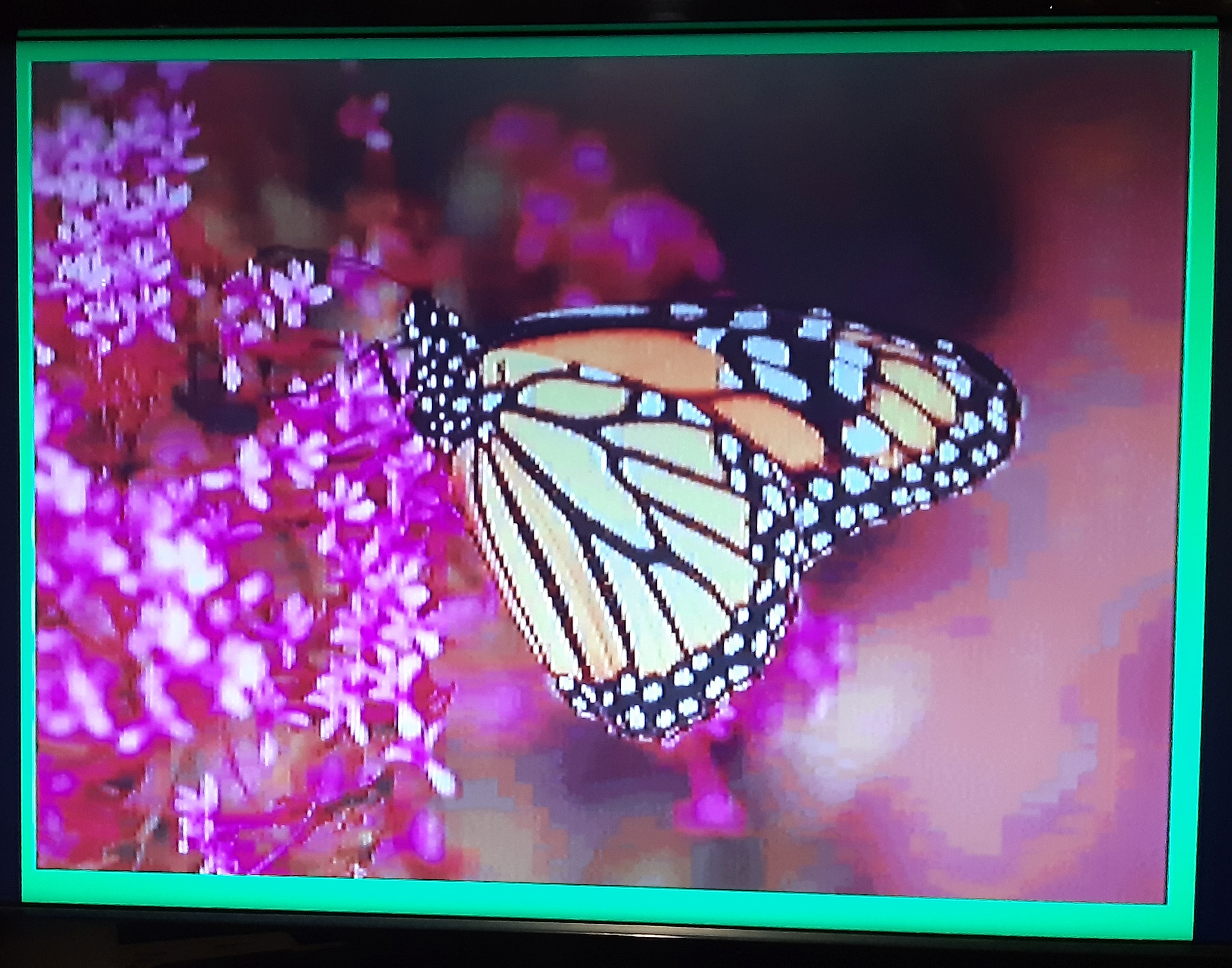

It may just be my cable. I wouldn't worry too much. But are you sure you get no bars at all? This is with BASI12I.

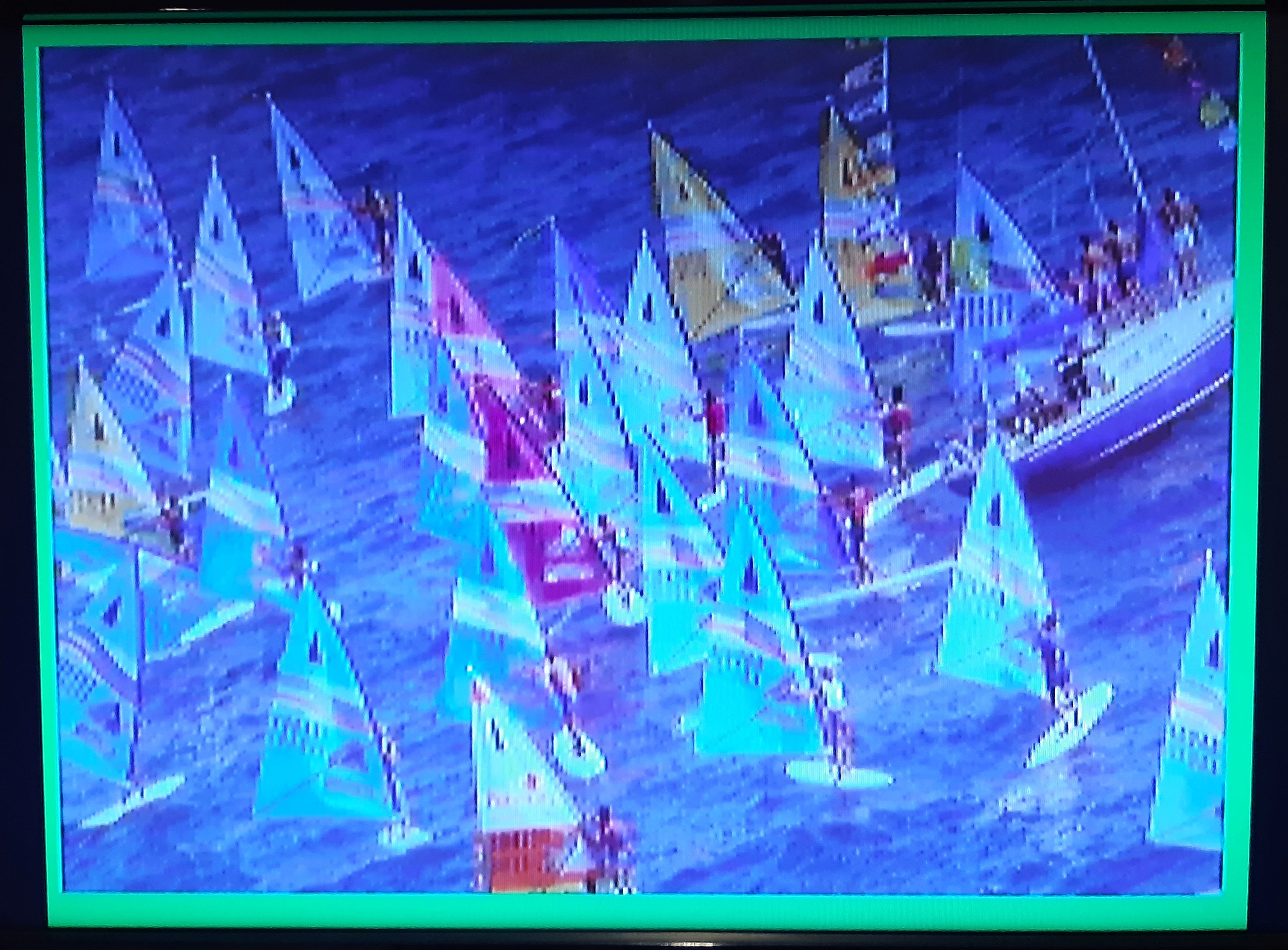

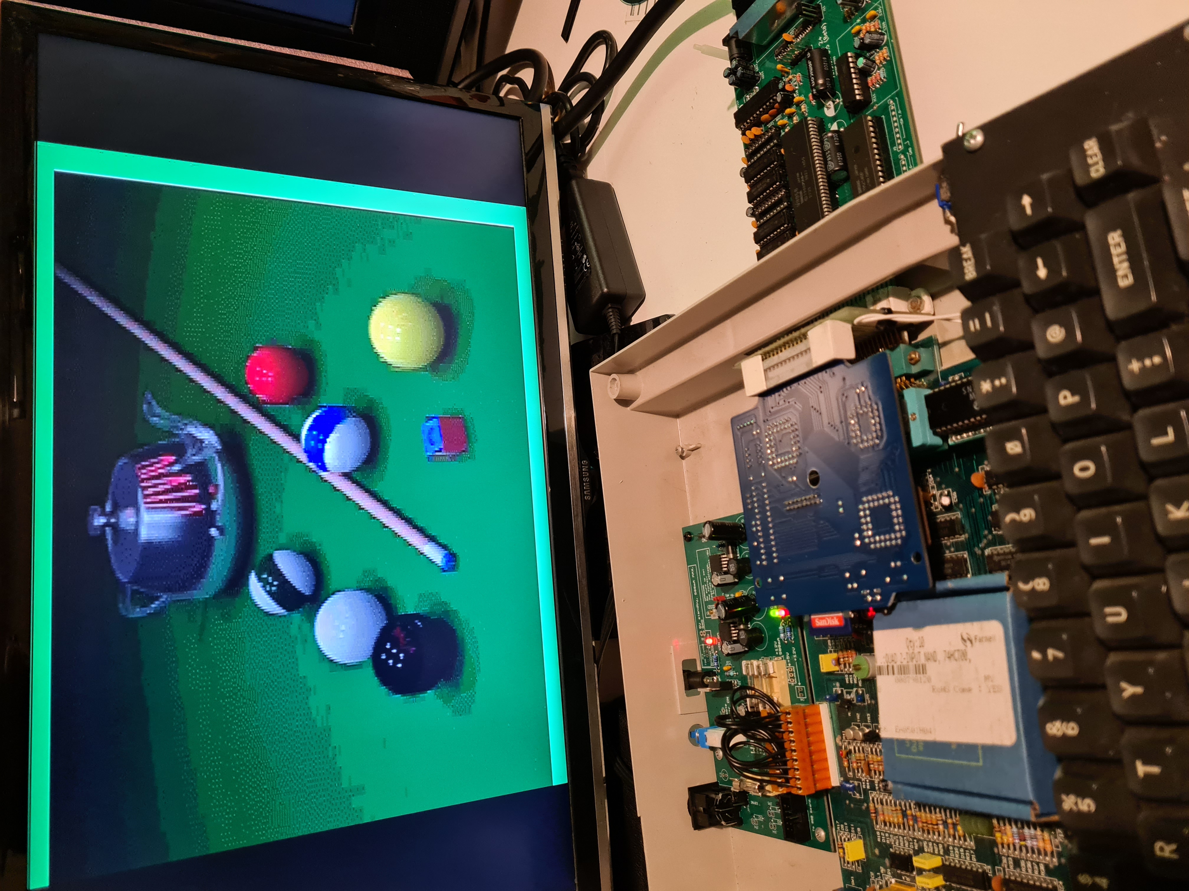

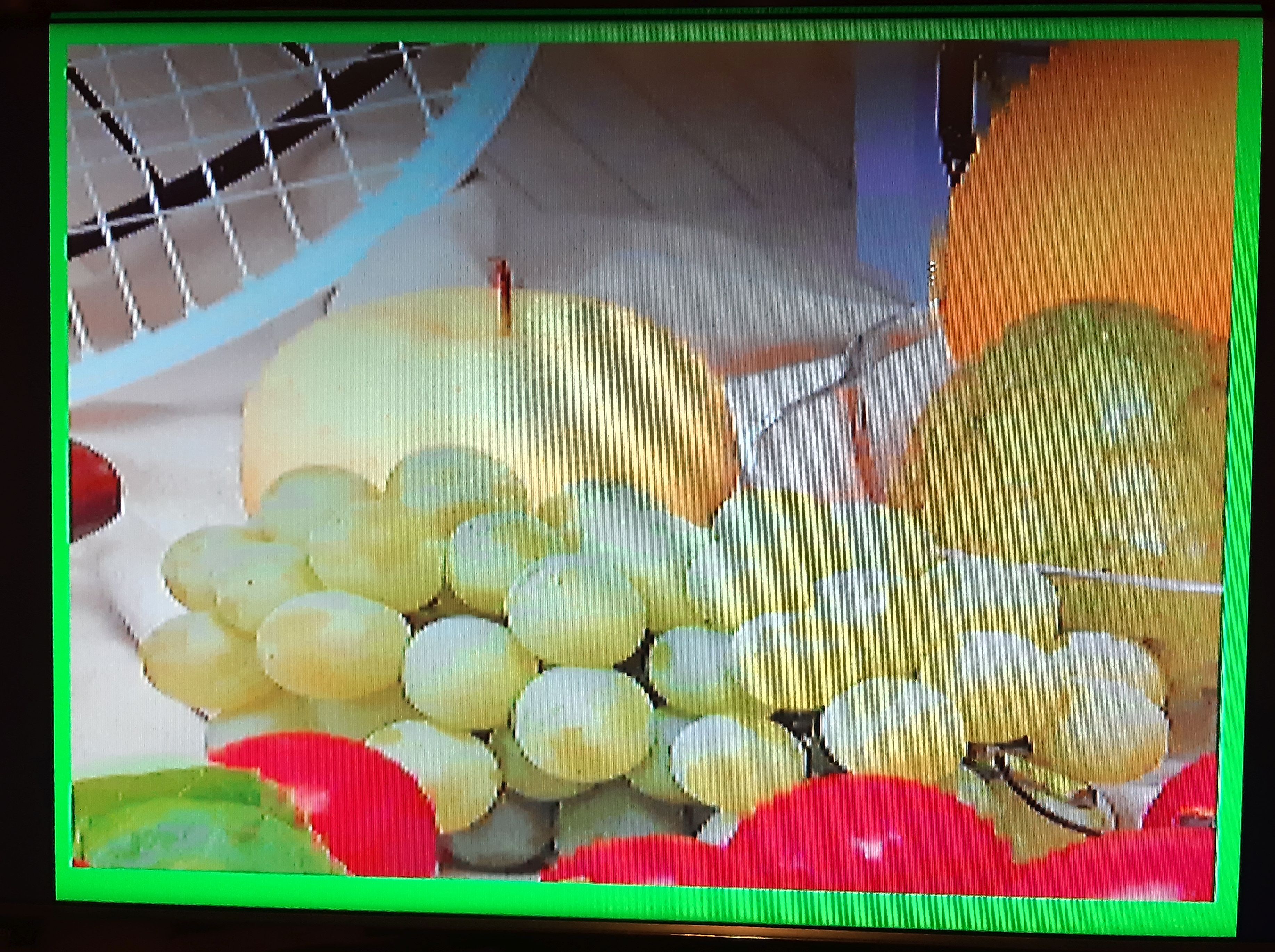

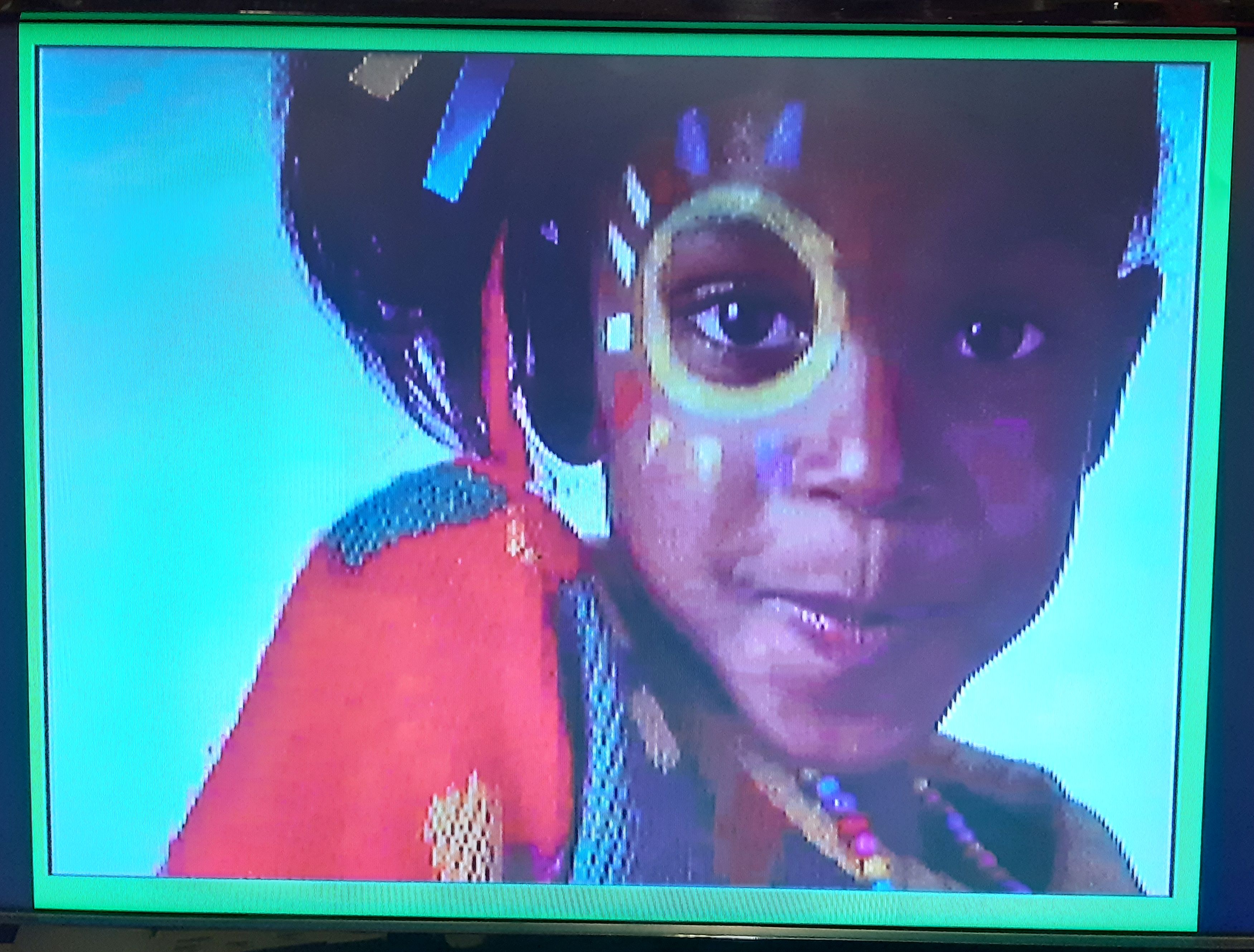

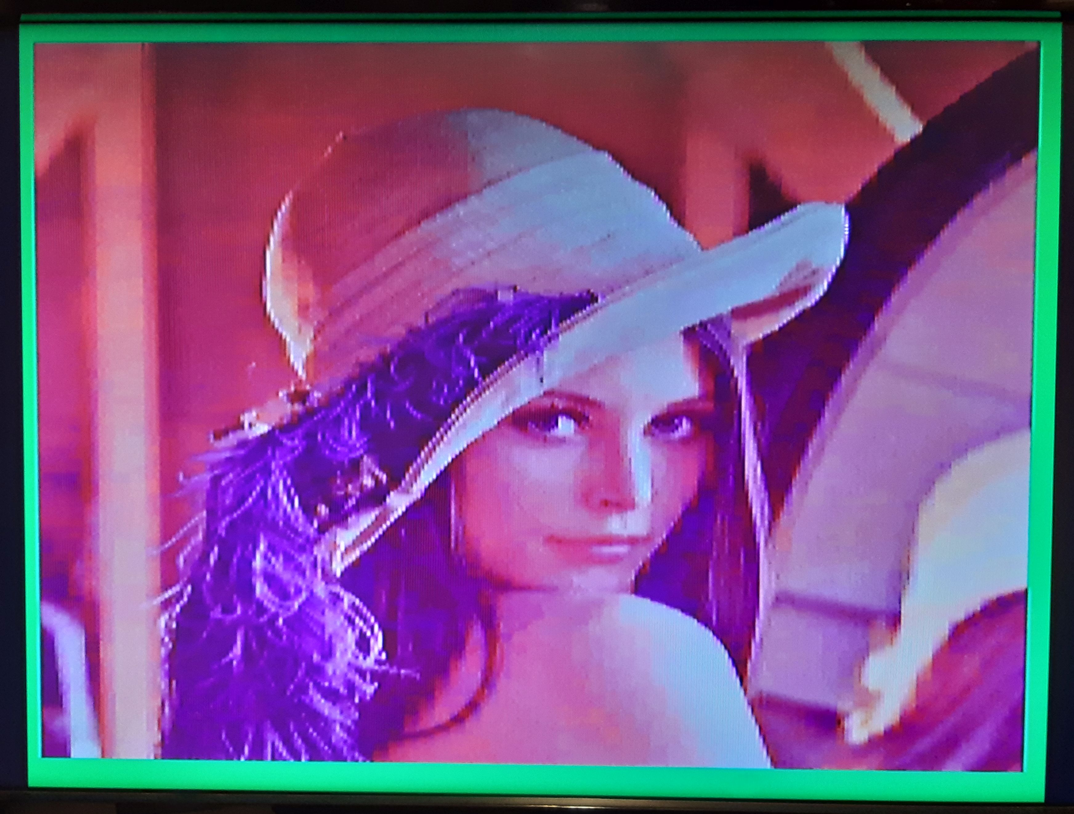

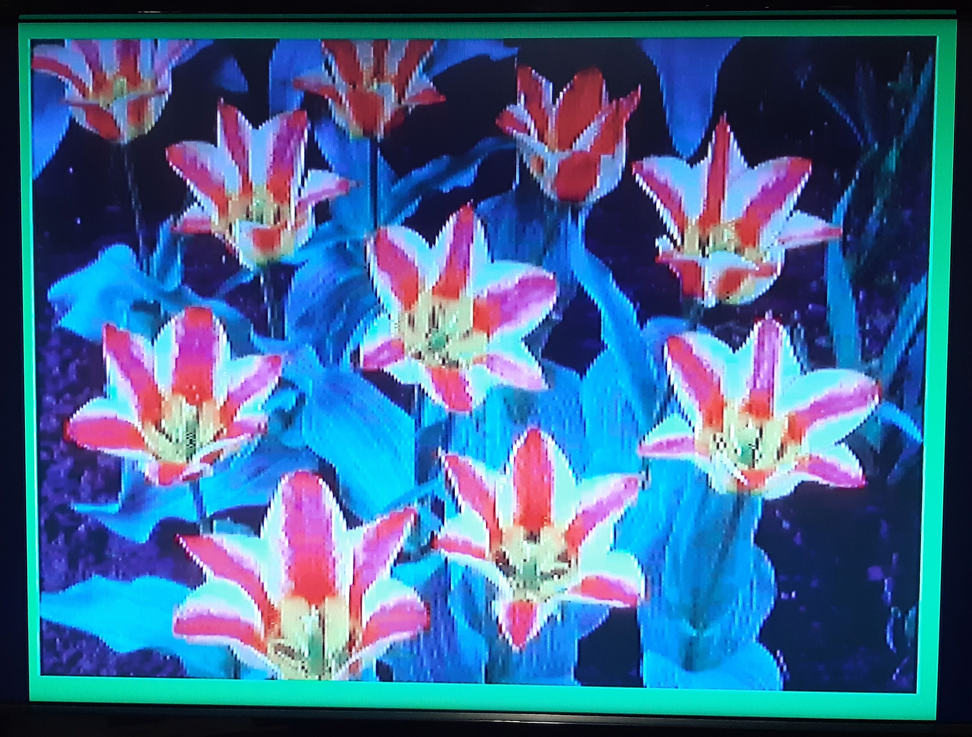

Hello John,
sorry for the delay, but it has been impossible to take the photos earlier ...
I attach here the eight images we use for testing and I can asure you that vertical bars do *not*
appear on the screen on any of them.
But taking a photo opens a door for camera-screen effects and you will notice some vertical bars
on Image1 but not in the others ...
These have been made running BASI12.BAS too
By the way, using the special YJK modes that mix data from 4 vertical dots, we know that there will
be artifacts and some curved lines may appear as ladder steps but not too much.
If an image gets this effect in excess, then we should choose another resolution with just 256 colours

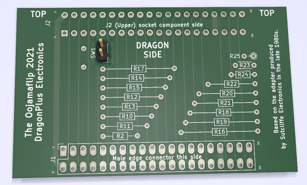

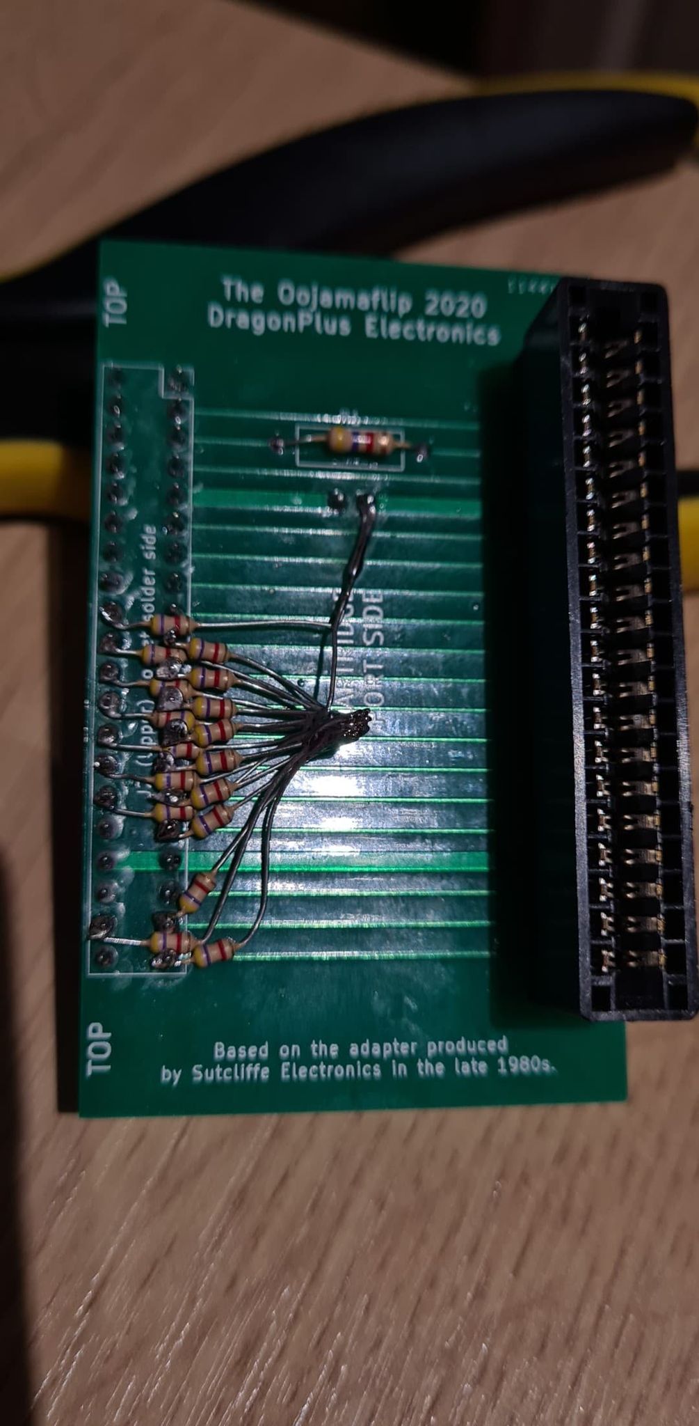

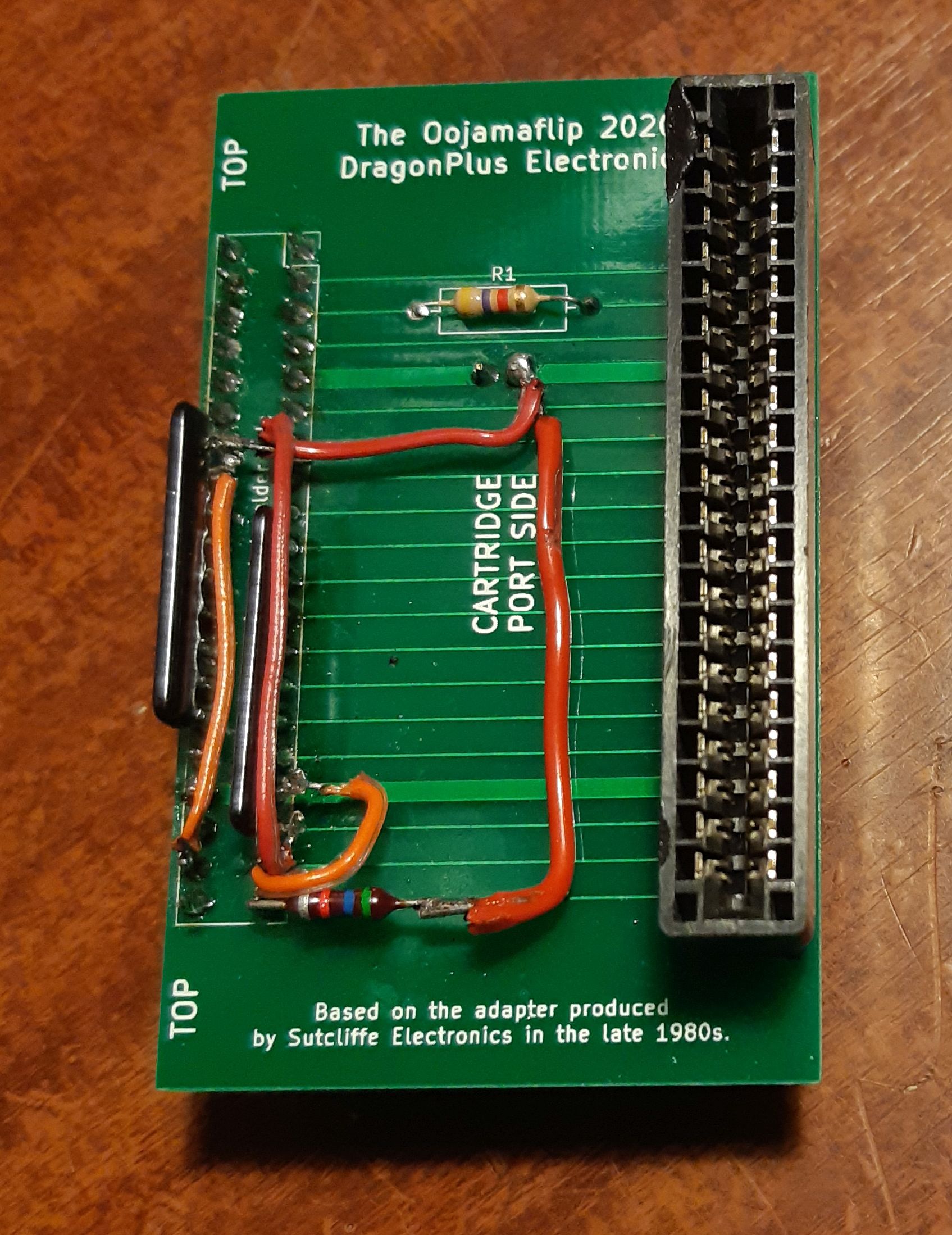

OK - the immediate issue is now solved. Many many thanks go to Pere and Darren Atkinson for their assistance with the random DOS failures issue.
The fix has been to add pull-up resistors (4k7) to the address bus and RD/WR. I made the decision to mod the Oojamaflip rather than the DMSX2+, as the Oojamaflip can then function as not only a splitter, but also a clean-up device.
I'll be creating a new version of the Oojamaflip board which will have space for these pull-up resistors to be added somewhat more neatly.
The theory behind this solution was explained by Darren Atkinson as being down to the various DOS versions using the SYNC command in different ways. Essentially, when the 6809's SYNC command (0x13) is issued, the address bus, data bus and R/W signals are set to open-collector/high-impedance. For some reason which is beyond my means of investigation, the combination of both the CocoSDC and the DMSX2+ is causing signal levels on the address bus and/or the R/W signal to fluctuate, causing spurious writes at a time when the main system should be idle, just waiting for an interrupt to arrive from the DOS hardware.
The Dragon, Coco 1 & Coco 2 all seem to suffer from similar issues (though in the latter examples, this is Darren's experience, and not my first-hand knowledge). Studying the schematics, it can be seen that for the Coco 3, Tandy did indeed add pull-ups on the address bus and the R/W line. https://colorcomputerarchive.com/repo/D ... Sopko).pdf.
Thanks all for your input on this issue.
.The theory behind this solution was explained by Darren Atkinson as being down to the various DOS versions using the SYNC command in different ways. Essentially, when the 6809's SYNC command (0x13) is issued, the address bus, data bus and R/W signals are set to open-collector/high-impedance. For some reason which is beyond my means of investigation, the combination of both the CocoSDC and the DMSX2+ is causing signal levels on the address bus and/or the R/W signal to fluctuate, causing spurious writes at a time when the main system should be idle, just waiting for an interrupt to arrive from the DOS hardware.
we are happy enough to have a hardware guru like Darren Atkinson helping us to solve awkward problems
Thanks a lot, Darren, you are vey kind!!
By the way, I could not resist and have taken two resistor arrays of 4k7 and a std resistor 5k6 .. the only components I have right now
and have added the pull-ups to the oojamaflip.
Now I can execute all of the programs without any issue! Really great news!!
I attach a photo of the modified oojamaflip
